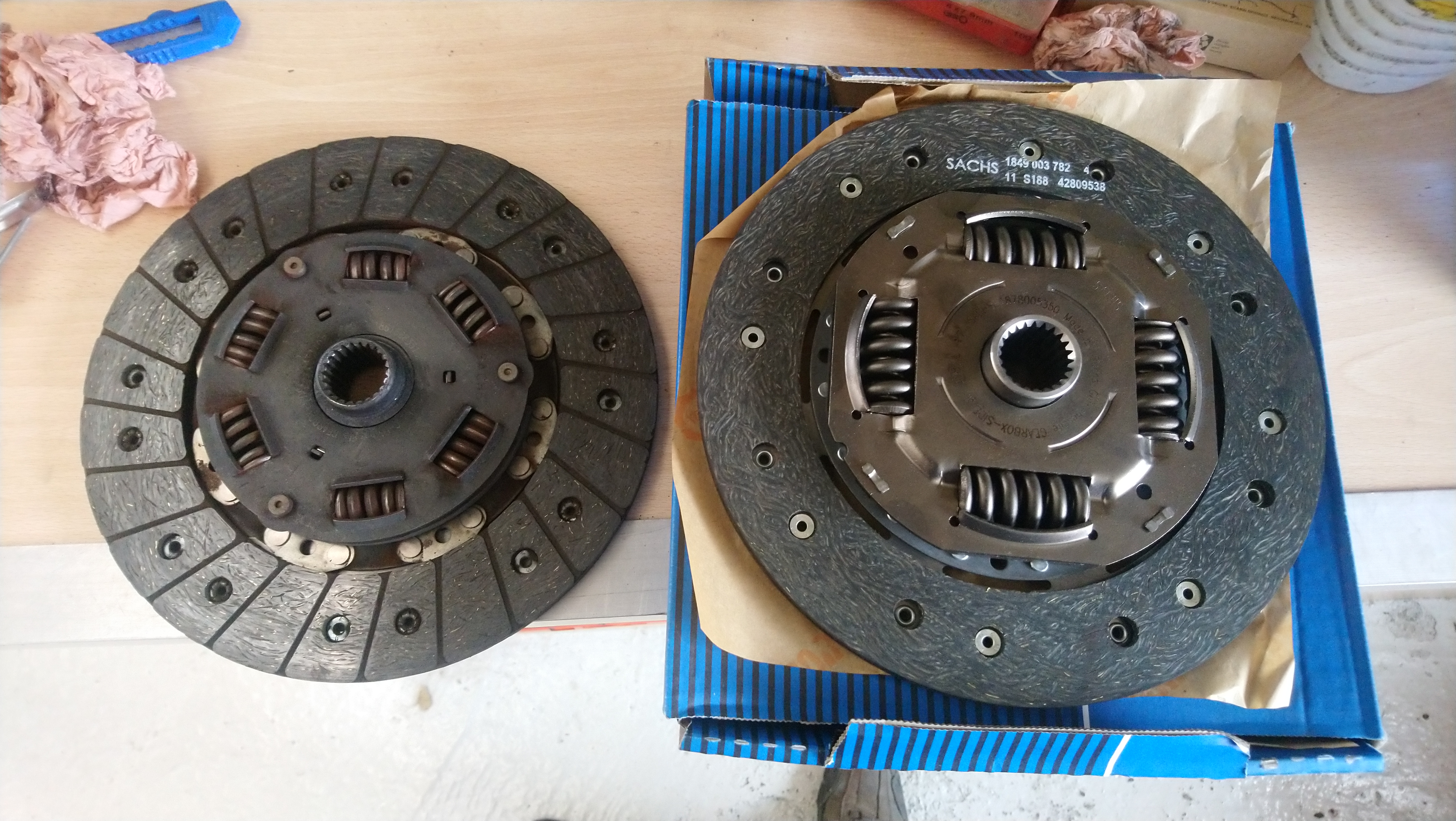

four0four wrote: Wed Apr 13, 2022 11:13 am @Thom - you mean two versions of the 930 disk? I poked around in your history but only found pictures of those. The cup disk has been revised for sure, there's at least two slightly different versions floating around the internet.
Here is my photo of the 2 versions. As said the 4 spring version has worked great for me. I like that the friction surface is uniform.

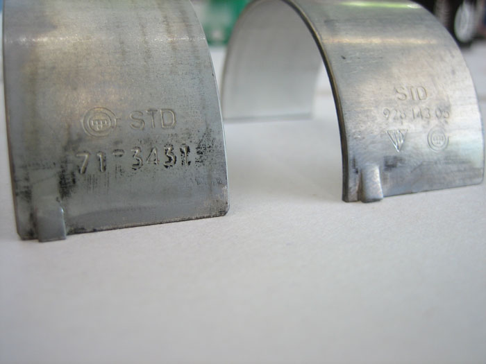

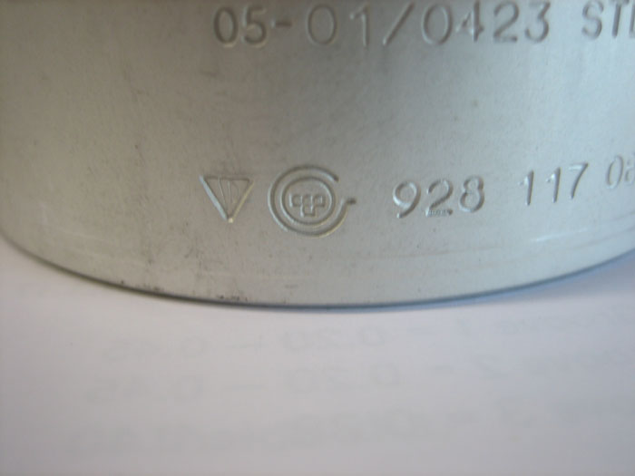

gruhsy wrote: Thu Apr 14, 2022 8:35 am Edit: I will also ask Porsche vs Glyco? I have seen it mentioned that Glyco makes the Porsche bearings
When I built my motor in 2008, I ended up ordering both Glyco bearings and Porsche-branded bearings (rods and main). They appeared identical. The Porsche-branded version had the Porsche logo and part number, but still had the Glyco logo stamped into it. While they apeared to be identical bearings, the reason I ended up with both sets is that the Glyco bearing sets had a few visible flaws, whereas the Porsche set looked perfect. I'm not sure if that was happenstance, or if Porsche insists on a higher QA process -- but I suspect the latter based on other Glyco bearings I've bought over the years. Seems like you can get to the same result cheaper with the Glyco branded bearings, but you may need to inspect closely and send back/replace the duds.
