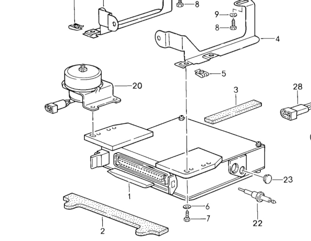

Well as someone who lives 4500 feet above sea level, would it be a good idea to disconnect mine?NC944er wrote: Fri May 15, 2026 3:17 pm The factory AFM unit measures intake air flow and air temperature. It was paired with a separate altitude sensor/switch that activates at 5,000 feet above sea level, changing the DME to a high-altitude fuel map, which only estimates density changes under that specific condition.
As for the MAF setup, because the physics of the hot wire sensor automatically account for changes in density on a continuous basis (such as variations in temperature and altitude), it will provide more precise measurements at all elevations.
If you only plan to drive your car at lower elevations, the altitude sensor will have no effect and can remain connected, but certainly disconnect it if you live/operate at 5,000 feet or above, as it will lean out the air-fuel mixture.
‘83 Platinum N/A 944
Although I didn't go look at the DME, the parts diagram would suggest it's an easy disconnect (part #20):
- Screenshot 2026-05-19 at 9.40.29 AM.jpg (117.51 KiB) Viewed 214 times

Curious, does that MAF come with chips? @johnb can confirm hopefully, but I'm fairly sure the altitude correction switch acts as a global modifier on fuel -- like the FQS -- and since the MAF is already accounting for the lower air density at 4500, you would not want to reduce fuel further with that switch. In other words, yes, I'd disconnect. It's up high and to the right behind the glove box, and has a simple connector you can just pull apart to disconnect.BennSport wrote: Mon May 18, 2026 8:48 pmWell as someone who lives 4500 feet above sea level, would it be a good idea to disconnect mine?NC944er wrote: Fri May 15, 2026 3:17 pm The factory AFM unit measures intake air flow and air temperature. It was paired with a separate altitude sensor/switch that activates at 5,000 feet above sea level, changing the DME to a high-altitude fuel map, which only estimates density changes under that specific condition.
Hmmm, I might just have to bite the bullet and get that MAF and pull the sensor then. I notice a significant decrease in performance when I take my car up the windy mountain roads.
