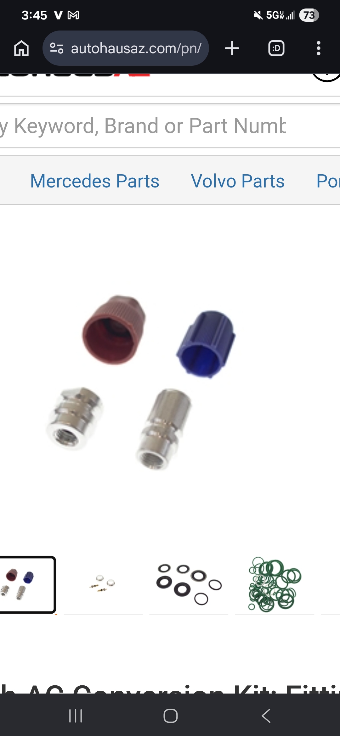

Is there an R134a conversion sticker under the hood anywhere?
As @dr bob and @Tom have mentioned, it's a pretty good bet your system has been "converted".
I use quotations because of the sealant putty on your Drier.
What that kind of tells me is that there may be a good chance the o-rings weren't changed out for the proper green ones.
If you unscrew the blue cap, the fitting should look like this.
The red cap should be on the compressor.

On the 928S4, the high-side service port is on a bit of tubing just upstream of the receiver/dryer, in front of the condenser on the passenger side. That's the red cap on converted cars. As the OP's pictures show, the low-side service port is on the compressor suction side plumbing from the expansion valve at the evaporator. With everything in place, access is inconvenienced by the upper radiator hose, the air intake hose to the air filter housing at the rear of the engine bay, and a couple cooling system vent hoses that pass to the passenger side fender wall. I used a 90º "conversion" fitting on the low side, and it makes connecting the service hoses a LOT easier.
The little hose manifold plate on the compressor itself has service ports on it, but with the compressor installed there's zero chance of actually using them. Regardless, the Schrader valves in those ports, the o-rings inside the service caps, and the o-rings between the manifold plate and the compressor housing all need to be swapped as part of the conversion. The two between the manifold plate and the compressor escaped replacement (same as: I didn't even know they were there) until the new oil caused them to swell and fail within a day. So dumped the refrigerant charge and some of the oil charge in a matter of seconds. Back to the garage, removed the compressor, new o-rings again including the hoses and the ones that failed, another 24 hours with vacuum on it, then new oil and refrigerant. Fine ever since, about 28 years ago now give or take a couple days.

I knew that.dr bob wrote: Fri Apr 17, 2026 10:17 pmOn the 928S4, the high-side service port is on a bit of tubing just upstream of the receiver/dryer, in front of the condenser on the passenger side. That's the red cap on converted cars.
Not sure why I wrote what I did.
My apologies if I confused anyone.

Absent the details of a conversion effort, there's no telling how it was actually done. The compressor and new drier mentions are consistent with a R-134a conversion perhaps following a problem/incident.
Regardless, it definitely says R-134a was used, and the conversion fittings reinforce that. Since they included a UV dye in a recharge, you can do a bunch of cleaning around your connection under question to remove any traces from your loosening/venting episode, then inspect carefully with a blacklight after it's been sitting for a while. In a dark garage, the dye will show up as a pale yellow/green fog wherever the oil carrier has seeped out. Easiest if you don't drive the car between cleaning and inspecting, as cooling air through the radiator and fans will dissipate the leaking dye. I have a UV "blacklight" LED flashlight (cheap from Amazon) that's quite handy for the inspection duty.
I also have a decent electronic sniffer that detects down to grams-per-year leakage rates. I find it handy to wrap suspect connections with some plastic food wrap with the sniffer probe end inside, and let it gather any leaking gas for easier and faster detection. This is low-pressure side, so no need or desire to have the system running while you look or sniff.
