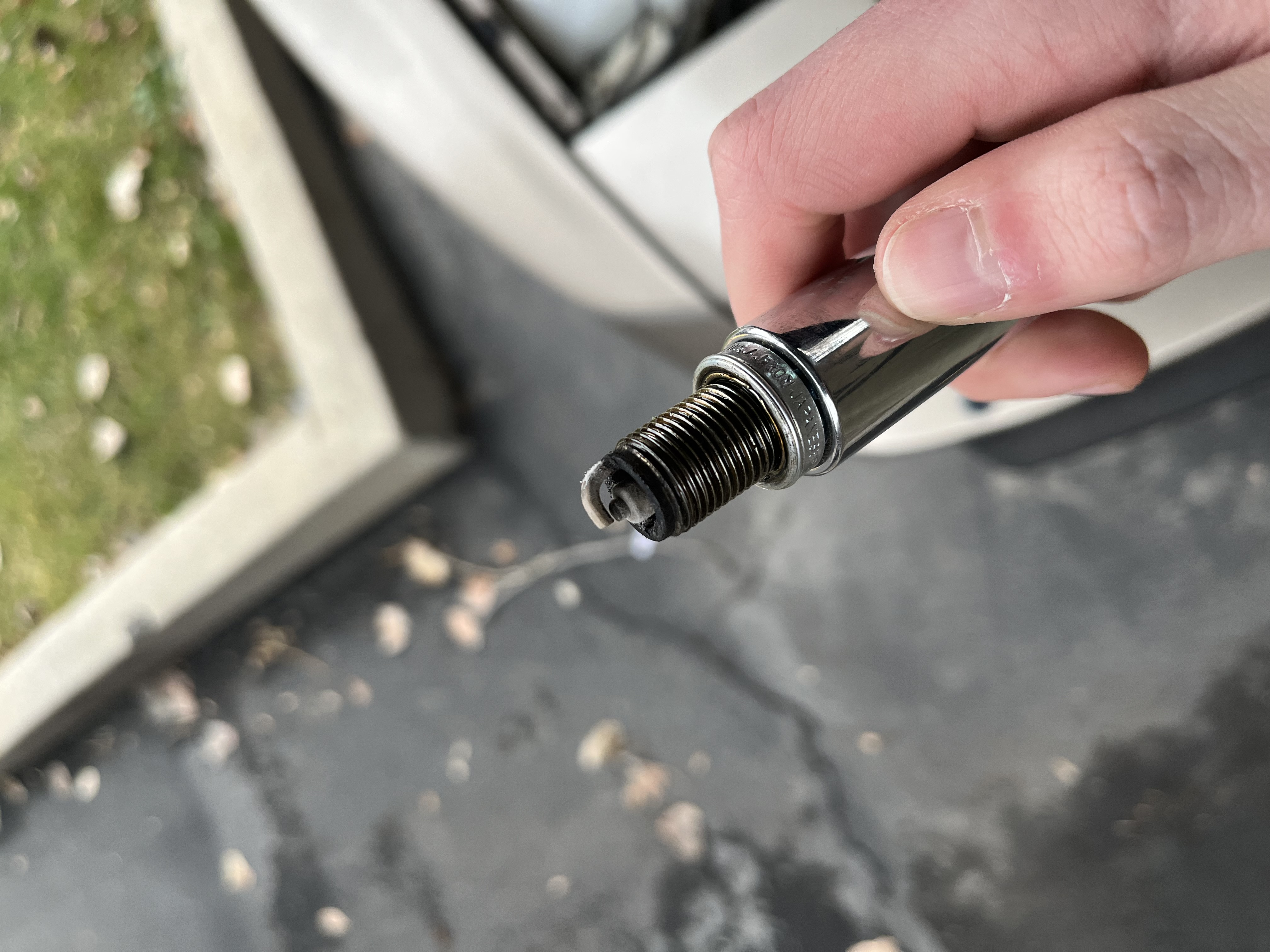

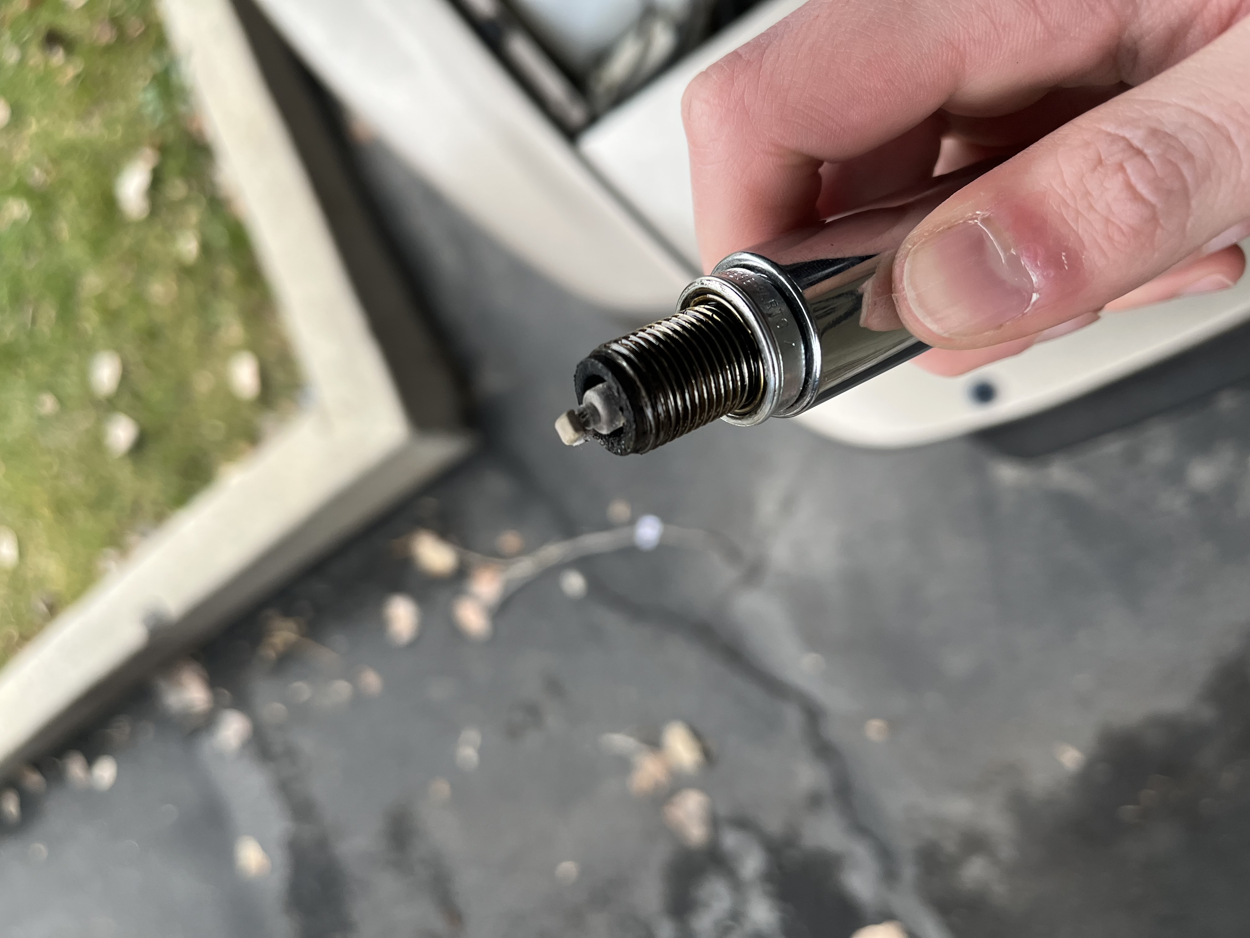

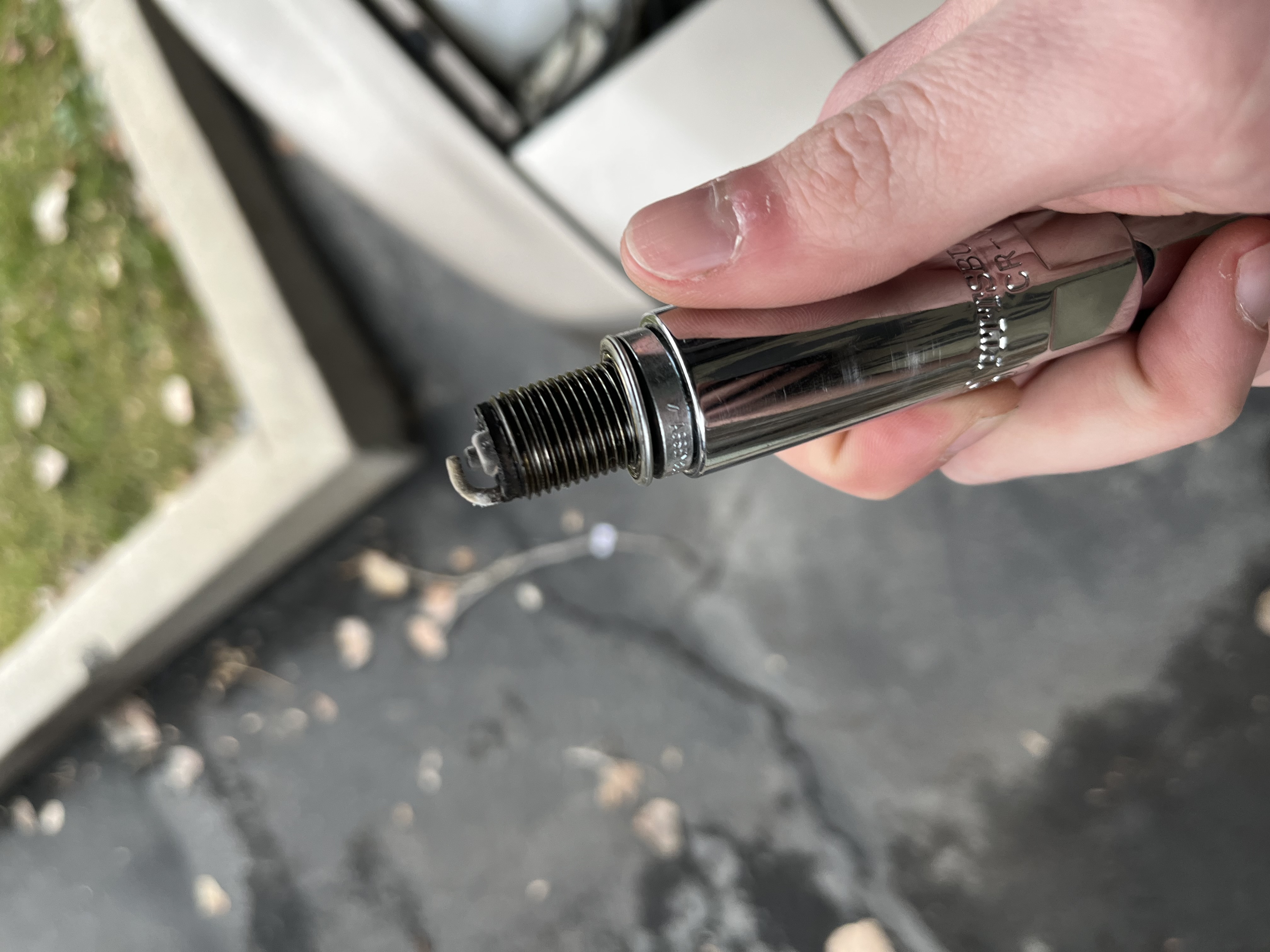

BennSport
Posts: 271
Has thanked: 7 times
Been thanked: 27 times
After pulling the spark plugs I didn’t see any coolant in the cylinder, although with no borescope it was pretty hard to look. However, the plug on cylinder 2 had some white buildup on it. Would this mean I have a head gasket failure at the front of the block?
