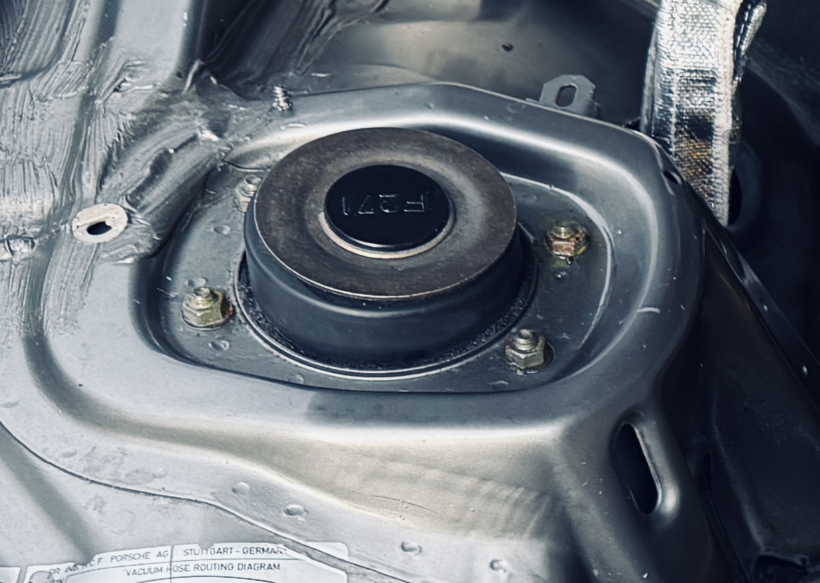

This is likely not a great photo, but I noticed this gap in my mounts, should I look closer? I hadn't taken much notice, my suspension is not awful, just aging.

spacecad3t wrote: Thu Dec 25, 2025 2:09 pm This is likely not a great photo, but I noticed this gap in my mounts, should I look closer? I hadn't taken much notice, my suspension is not awful, just aging.
I am not super knowledgeable about what happens as it does this and fails, I just know it's not supposed to do that.
But if you're spending the money elsewhere, make that investment imo.

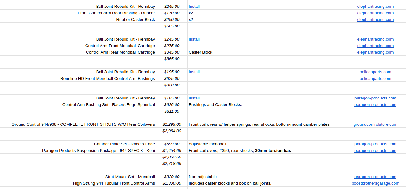

Well, I have looked at many of the options mentioned across various threads. Im a little torn based on what I read. I was leaning toward monoballs, because the price isn't much higher and they come off as a significant improvement. However, since my car will mainly be a daily driver and it current kept on the street, I read that monoballs, even the weather sealed ones are prone to corrosion if not greased/used often enough. I would hate to invest in them and then find their life is even further diminished from how little I drive the car throughout the winter...
So with that- I think I would likely benefit from the cost savings and performance of an elevated rubber bushing. With that, the elephant racing rubber bushings do review well and come in a sport hardness- which I think is a good compromise for my goals.
I saw that some suppliers sell Delrin, which was appearing at first, but from further reading- Im not sure I want to go with Delrin on a car not dedicated to the track.
As for struts/coil overs- I'm leaning toward the ground control kit. It looks super nice and is competitively priced against other kits with adjustable plates.
I documented some of the different combinations I looked at. All of the monoball "kits" are roughly the same price... I feel like the Elephant racing components are the nicest? However, the Rennline kit also looks to be very well made and from what I read, is actually Prekom components?
Screenshot from 2025-12-31 11-03-07.png (118.19 KiB) Viewed 941 times
Thoughts/feedback anyone?

I got some input from a friend with some real world suspension experience. He suggested I go with compound for the front bushings and bearing/monoball for the rear/caster block. So that is what I did. I went with Elephant Racing's sport rubber front bushings and their monoball blocks. I'll report back how it goes/outcomes.
As for shocks- I'm still leaning toward the ground control setup, doing a lot of price/effort comparing, it just seams to be the most value. Although, I watching a set of struts on eBay, maybe I just cut-a-strut/coil over those...

spacecad3t wrote: Wed Dec 31, 2025 8:15 am Well, I have looked at many of the options mentioned across various threads. Im a little torn based on what I read. I was leaning toward monoballs, because the price isn't much higher and they come off as a significant improvement. However, since my car will mainly be a daily driver and it current kept on the street, I read that monoballs, even the weather sealed ones are prone to corrosion if not greased/used often enough. I would hate to invest in them and then find their life is even further diminished from how little I drive the car throughout the winter...
I replaced every rubber bushing on my car with Powerflex polyurethane.
Good improvement over stock rubber but not as harsh as solid monoballs. After install the car felt great: tight and responsive but not too harsh. A good compromise for a car that is primarily autox but still sees some street driving to/from events and summer cruises. Powerflex also comes in two different hardnesses for some of the mount points (purple and black). Ive been very happy so far and they have stayed quiet over the last 5 years Ive had them. Also much more cost effective than Elephant.
