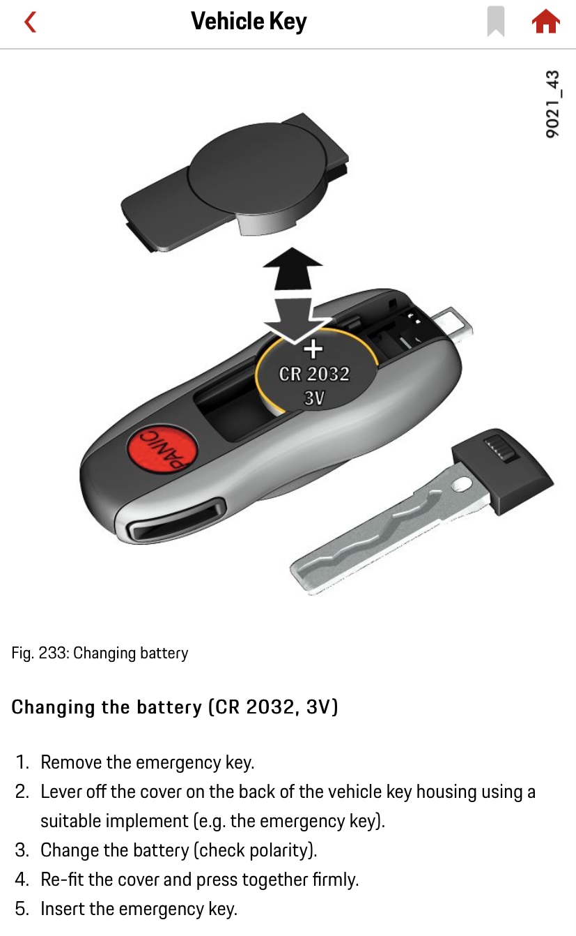

Mine is a new one where you have to take off the two side pieces to get at the plate covering the battery.

So I got both new batteries in the key fobs but the low battery warning is still coming up when I first start the car.
Any ideas?
