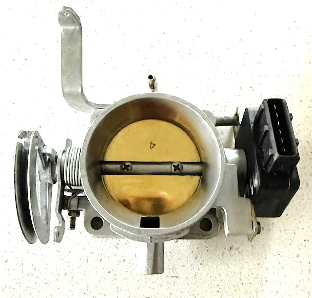

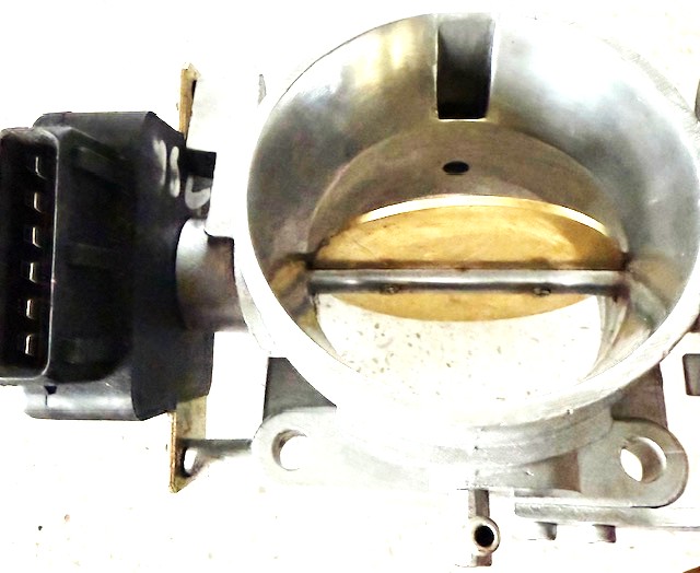

Tom wrote: Sun Nov 02, 2025 8:25 pm Google says my binder paper feeler gauge is .004"
First, lol, and thanks!
Tom wrote: Sun Nov 02, 2025 8:25 pm but know some throttle plates are beveled so they can sue up closer to the bore and still open/close. As I think about it, as a production part I guess it's not surprising to see gaps in this range. I'm guessing the gap grows as the temp rises (aluminum bore vs brass(?) plate). I recently joked to my machine shop guy that I wanted a part machined to within .002" and he said, "sure, at what temperature".

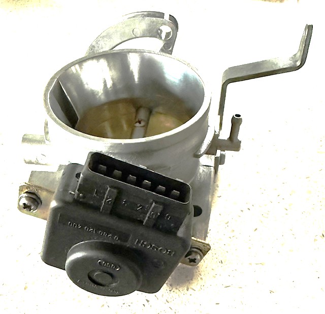

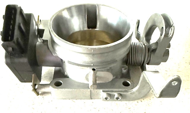

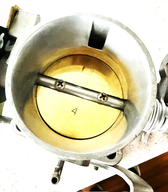

I also thought the plate was beveled and that maybe this plate was replaced or ground... but from your photos, Im thinking my adjustments snugged it more?
Would you try this throttle body? Or am I chasing a ghost here relative to my 1100rpm hot idle?
I worked as a machinist, our smallest tolerance guarantee was 0.003... but thats a excellent joke, I'll remember to use it.

Hi - I rebuild all the 944 TB variations and is quite normal to have 'some' gap. Even if a person tries to reset the throttle plate screw, there will still be some slight opening. The key, as noted herein, is getting that tolerance to be small enough to avoid artificially increasing the idle speed.

rheidtman wrote: Thu Nov 27, 2025 5:07 pm Hi - I rebuild all the 944 TB variations and is quite normal to have 'some' gap. Even if a person tries to reset the throttle plate screw, there will still be some slight opening. The key, as noted herein, is getting that tolerance to be small enough to avoid artificially increasing the idle speed.
Rick

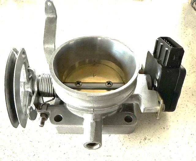

Curious what you make of the throttle body I found on my car. https://carpokes.com/viewtopic.php?t=4557&start=110

Post added to the other thread... Interesting TB and I've not witnessed the damage you highlighted. I have a number of TBs on hand and will review to see if any share those features... I also have 2 NOS NA TBs, but have to find them in the midst of my parts storage. I do think it important to document these nuances on the TBs.
