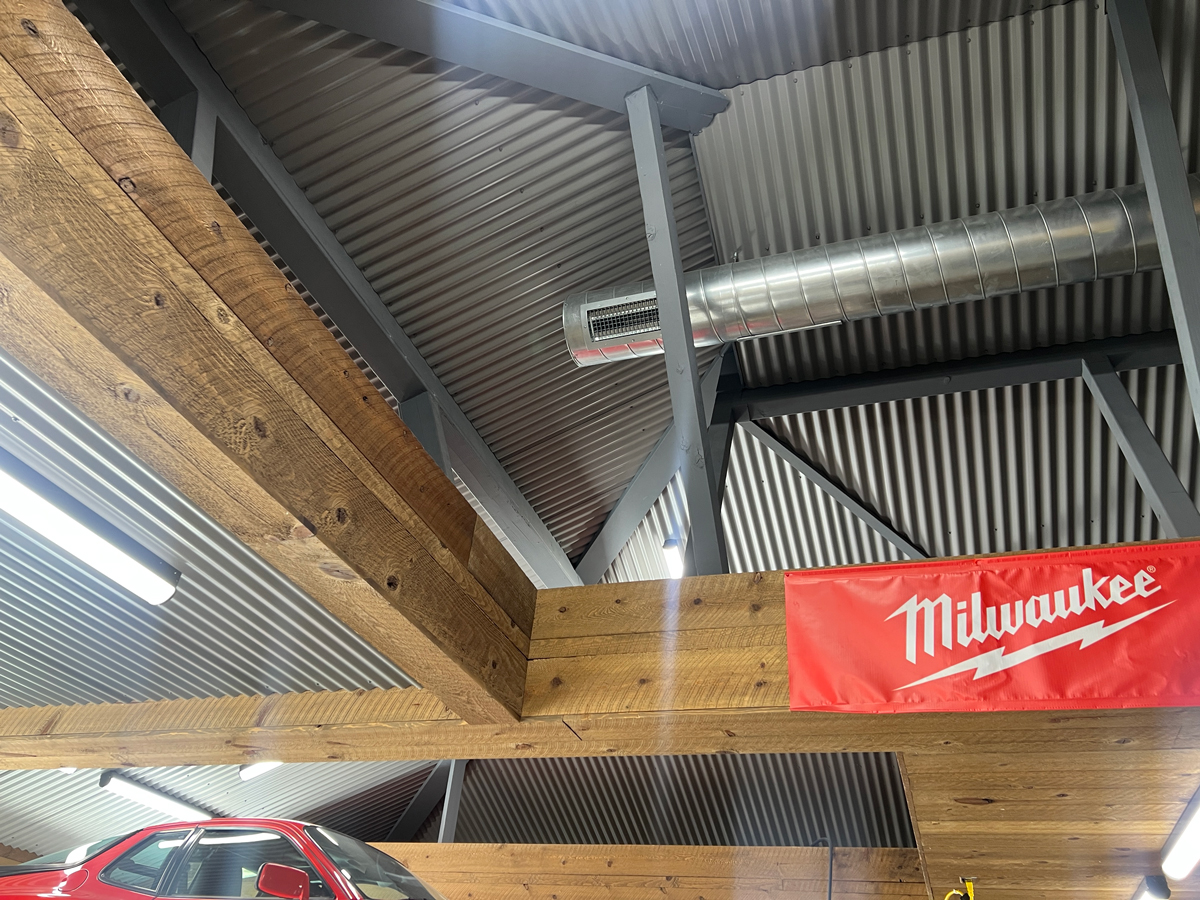

I struggled with heat (less so humidity) in my old garage, which has a split unit, but the garage was too big and drafty for it to really work as designed. The guy who spec'd that unit went by the book in terms of sizing and didn't really understand the unique needs of a drafty old garage. It was a constant struggle and one of the things I was determined to 'fix' in the new garage. The high ceiling added to the challenge, but our contractor 'got it' and fought fire with fire...
p.s., my nephew works for Milwaukee :)
