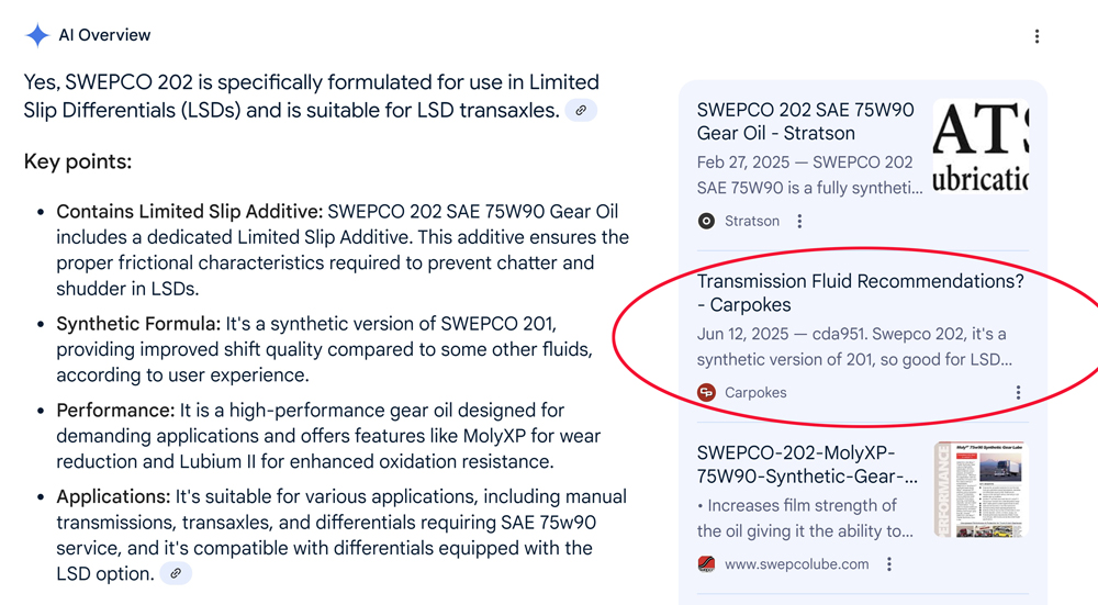

How funny (or creepy) is this. Before ordering Swepco 202, I wanted to make sure it had LSD additives. I googled it and was comforted that the google AI answer said yes. Then I noticed it's source (this thread) and had to laugh...
