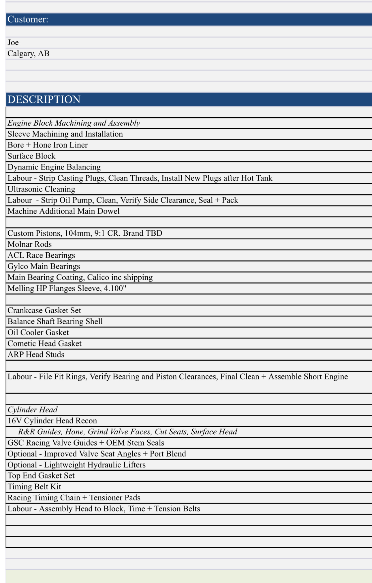

Thanks for your thoughts on this, Tom. I was originally going to go with the 3.0 8v, then decided to use what I have and make a 2.8 stroker. I have the crank, but when I started speaking with my builder I started to think more about the 16v motor. In fact, the build of the 16v motor itself was surprisingly less expensive than the 8v options due to the lack of need for significant head work compared to the 8v head. I know that cost will be equalized or maybe go higher once I get everything sorted as far as the details, butTom wrote: Sat Jun 14, 2025 7:14 pmI'm sure that's true, but I have to put in a plug for us 8v 3 liter guys. An 8v 3L with the right set up can be incredibly powerful -- honestly, it throws the chassis out of whack without significant upgrades. You have to think of the whole package to end up with a fun and reliable car -- clutch, brakes, suspension, squat, cooling, gearing, axle strength, CV strength, tranny strength, engine management, engine ancillaries, fuel flow, and on an on. The more you push the power, the more it will cost to support it. And if you don't plan ahead, like I didn't for the most part, you literally find the next weakest link one blown-up part at a time.944m3 wrote: Sat Jun 14, 2025 6:48 pm Not an easy road for sure.

This is the basic build outline from the shop I’m talking to. The variables include the turbo and the intake. The builder is suggesting using the stock exhaust manifold and fab an adapter to the crossover or the SFR option.
We are talking about mounts for the turbo where I’ll use a stock mount or a mount from Tial/Xona for one of their turbos. AC, PS and alternator (Nissan) will swap over. Some coolant hoses will need to be changed.

The engine build side follows much the same formula as the 8v, it looks like you have this covered (as long as the sleeves are done right, many tales of woe around this) and the exhaust side is simple enough.
