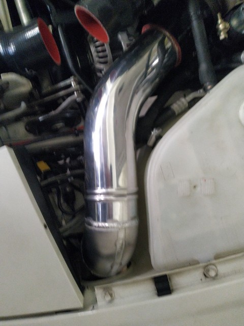

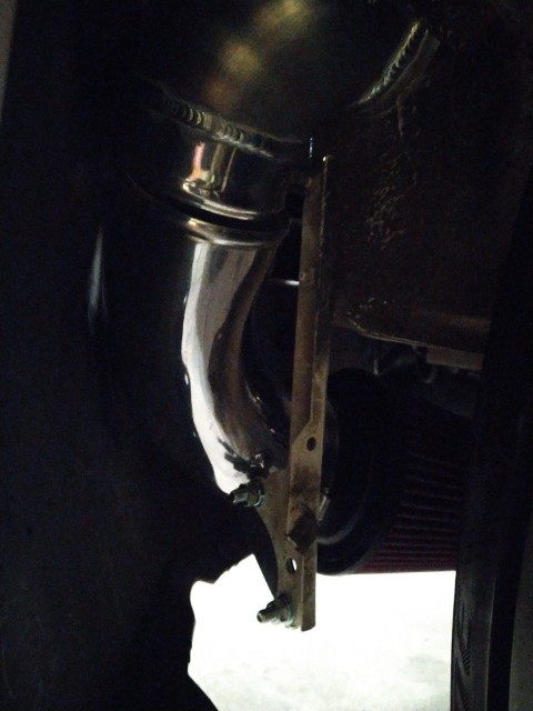

I dropped into see my fabricator today, he's confident he'll get 3.5" through without losing the whole headlight bracket. He has more issues with the 2.5" intercooler piping.
Re: High HP Airfilter Setup
Posted: Wed Apr 30, 2025 3:22 am
by Bergerac

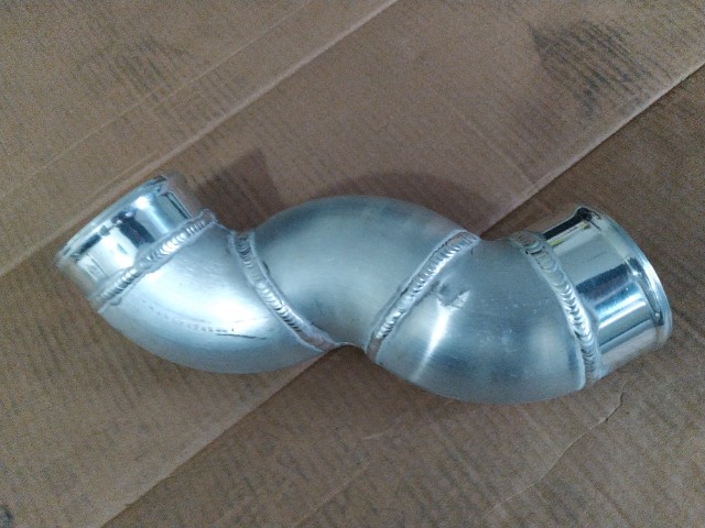

Not great photos but he made it happen with no cutting of the headlight bracket. 3.5" all the way to the filter behind the fog light. Still need to work out where the horns will go but thats not the end of the world.

You might have just traded "cooler" air for a restriction. The bends and length will certainly add to slower moving air.
Posted: Fri May 02, 2025 5:08 am
by Thom
AudiSport wrote: Thu May 01, 2025 5:17 pm You might have just traded "cooler" air for a restriction. The bends and length will certainly add to slower moving air.
Theoretically yes but I'd be surprised if it would make in practice a measurable difference.
Posted: Sat May 03, 2025 6:08 am
by Bergerac
Hopefully the larger tubing and filter combo will overcome any extra static pressure/restriction compared to the tiny pencil thin filter most people put behind the headlight.
Posted: Sat May 03, 2025 9:38 am
I would think the 3.5" diameter will prevent any real restriction -- at least at any likely power level. Nice welds too! :)
