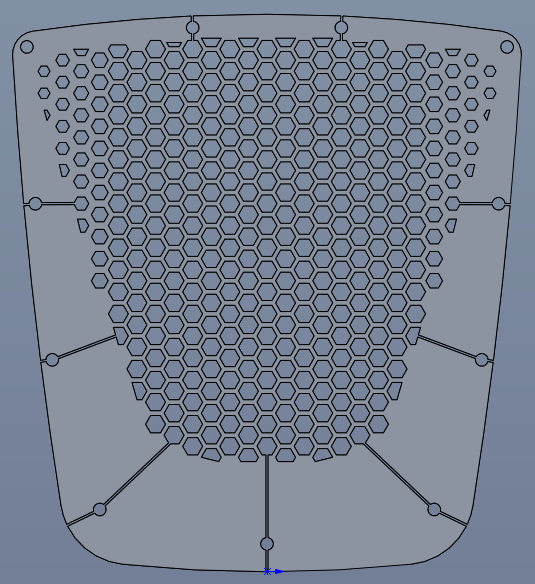

For those who are interested in the technical details: one of the issues I have to contend with is warping of the aluminium during the laser cutting process. Cutting the mesh pattern into the metal creates a lot of heat, and that heat makes the part want to take the shape of a taco shell (or more accurately, and Pringles chip). It's nowhere near as bad as an actual Pringles chip, but in the end, the part is no longer flat once it has been laser cut.
The ideal way to avoid this is to have the part cut with a die, but that would cost tens of thousands for the tooling. Since I make such small batches, laser cutting is the best option.
The carbon fiber frame, which is flat and very rigid, has an important function of flattening out the warpage of the aluminium part. In order to further aid in flattening out the warpage, I add slits through the mounting holes that create smaller sections that can shift around a little to accommodate the material expansion that causes the warpage. These slits aren't visible once everything is installed in the car, but it's a crucial detail in designing parts that have extensive laser cutting.

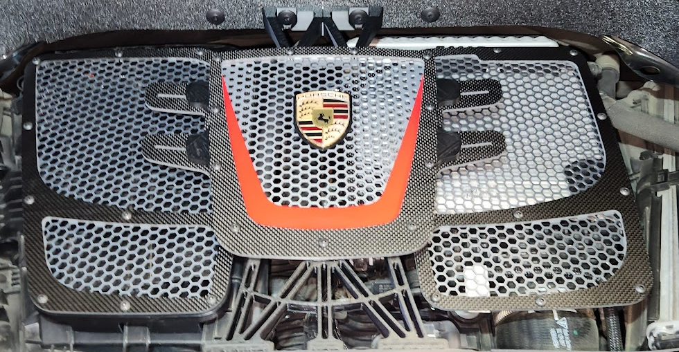

I finally got the production parts for the turbo flat-4 engine centerpiece covers, and they look great. Furthermore, it looks as if the aluminium mesh parts were water jet cut, not laser, so there was no warpage to contend with. I did some test fitments and made some adjustments to the mounting bases.
The parts were sent out for the first installation, and here was the result:
