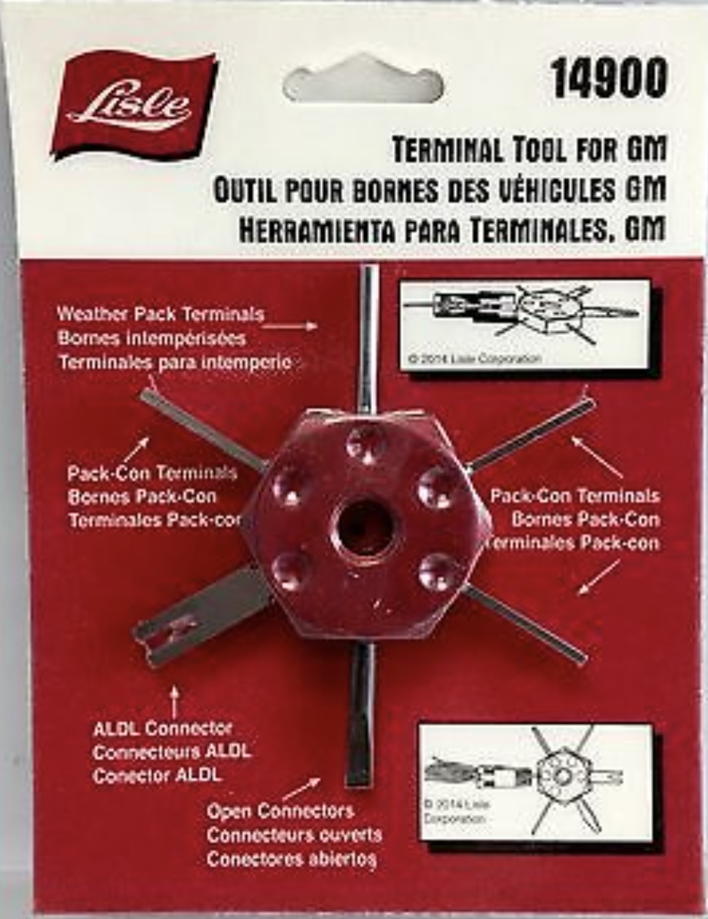

The extraction tools like that digikey one, which have the plunger to push the pin out, are awesome. I have a few of those for other connectors. The problem with the one you linked is that it's for the Junior Power Timer connectors (like virtually everything else I can find). The JPT connector has two retaining tangs, so you'll see that tool has two little blades that slide down both sides of the JPT pins. Most of the factory connectors on the 944 are just Junior Timer style with only one retaining tang -- which means that extractor won't work right because we have only one slot for one extraction blade. I have not been able to find a plunger style extractor for the Junior Timer connectors on our cars, so instead just use a tiny flat blade screwdriver from an eye-glass repair kit. There's also the pin extractor tool like the one shown below, made by several companies, which has a blade (2 o'clock in the picture) that works ok too. The junior timer pins, fortunately, are pretty easy to get out -- paper clips, tiny screwdrivers, toothpicks, etc. have all been known to work.

Ah, in that case, you might want to just cut off the old pins and install Junior Power Timer Pins/Connectors everywhere other than the DME and KLR connectors. For the connectors under the hood, none of those pins will come out anyway since they are 'potted' (i.e., epoxied for life) in their connectors, and I suspect you'll quickly remember how easy it is to get the pins out of the DME and KLR connector once you find a suitable screwdriver or other little blade. I forgot to post the picture above, but most auto parts stores carry pin extractors like the one below, which also work find on the DME/KLR.

by gruhsy
Just ordered the 14900
23.00$
