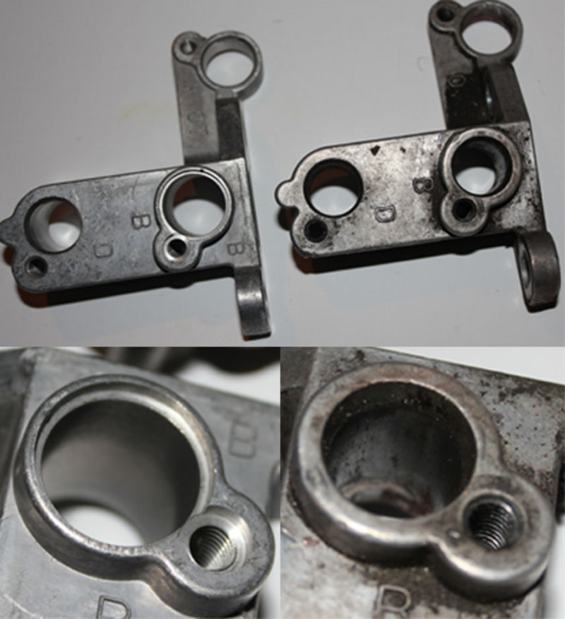

Getting trigger sync issues spoke too soon guessing i need to order a sensor bracket with the integrated sleeve .
Also getting a new sensor.
Currently running a Notched bellhousing . At this point i am getting so much noise on the trigger . Tried signal correction to high but seems it did not do the trick.
Maybe i have to move the trigger to the front after all

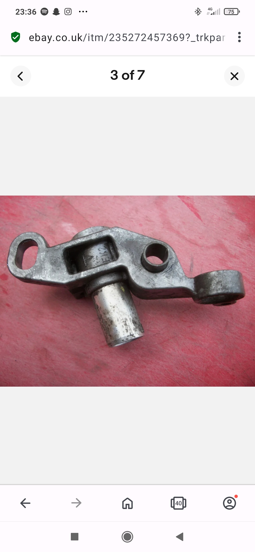

I guess this is a oversight from my part. It's a well documented issue.
When I bought the 16v engine it did not come with this bracket I took the bracket of one of my 1986 turbo engines guess that bracket is the old unshielded piece .
eBay is full of these brackets so I have bought the correct piece with the integrated sleeve and a new sensor. Hopefully this will resolve my issue.

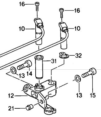

This is the S/S2 part of course only one sensor because propper 60-2 and not the Goofy 8v setup. Looks like Porsche learned from their mistake in 1987

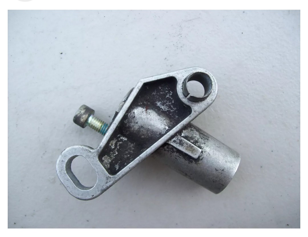

And this is a 968 bracket.
