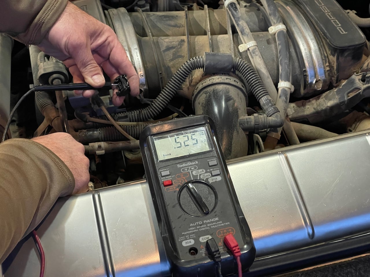

… the red probe on pin 2, and ground the black probe to the chassis. You should still see battery voltage (e.g. 14.67) when the PSE switch is set to quiet the car.
I do see 14.67 V.
… change the button in the car to see if the battery voltage disappears when the PSE is trying to open the flaps and make the car loud.
I still see 14.6 V.
… then most likely the ground side is switched on/off to control the PSE. To confirm that, set the mm to ohms (or diode test with beep); then put the black probe to Pin 1 of the connector and see if you have continuity when the PSE flaps should be closed and no continuity when the flaps should be open.
I put the back probe in pin 1, and the red to chassis ground. I think that’s what you want. I get this reading, so i assume it is switching ground like you say.

Almost there, but that last test isn't complete. With the black probe on Pin 1 and the red probe on a good chassis ground, what you are looking for is continuity when the flaps should be closed, and an open circuit when the flaps should be open. Your reading shows 525 ohms I believe, which isn't what I'd expect to see with the flaps open or closed. I'd repeat that test, and make sure the probes make solid contact with the both Pin 1 and a nice clean ground. Also, what you are trying to confirm is that there IS continuity when the flaps are shut, and there is NOT continuity when the flaps are open. So you need to test with the PSE button in both positions, and confirm Pin 1 switches with it.
I'd also put the connector back on and make sure the flaps and opening and closing when you push the button. By testing with the plug removed, there's some chance Pin 2 stayed at 14.67 because the factory system was keeping the flaps closed despite the cabin switch. With a patch cable like I described above, you can hear the exhaust switch modes. With the connector removed, it's worth confirming the flaps are doing what you expect...

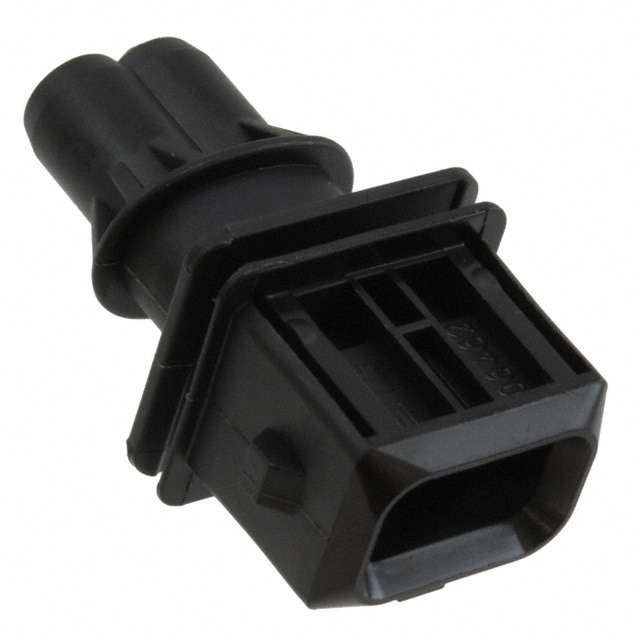

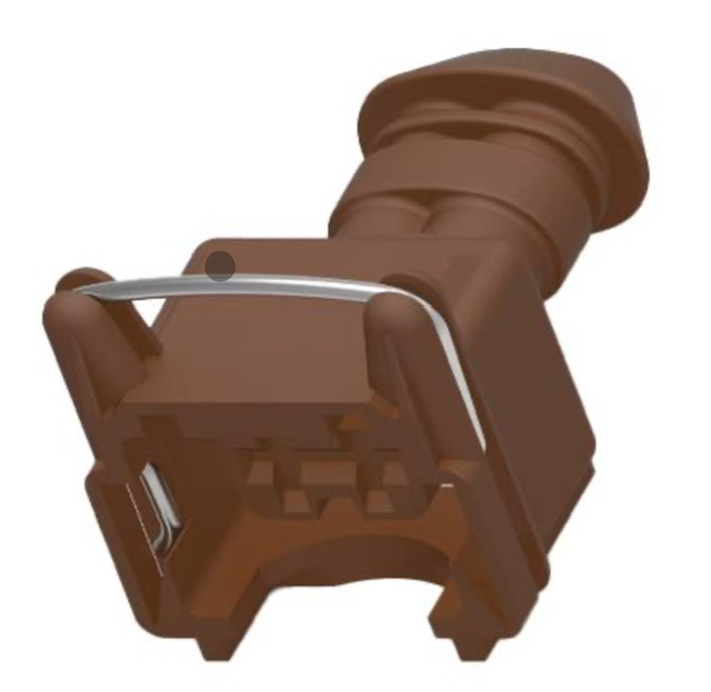

Uggg. I’m dazzled by all the different connectors in this https://www.digikey.com/en/products/fi ... iIAdySmMSA.
I think that this male and female connector would work. I know I’ll need associated pins, seals, wire and tools. Am i on the right track with these two inline connectors?
https://www.digikey.com/en/products/det ... -1/5437605
https://www.digikey.com/en/products/det ... -3/2054525
Posts: 8933
Has thanked: 932 times
Been thanked: 3995 times
Those are two alternatives of the same clip -- both take the female pins. Let me dig up some part numbers for you... Please hold. :)
Posts: 8933
You need one male-side connector and associated terminal pins.
https://www.digikey.com/en/products/det ... -1/2054000
Part number: 106462-1
Terminal pins for the male connector are part number: 1-962841-2 (lots of options/variations)
https://www.digikey.com/en/products/det ... ALIiBdAvkA
The first female connector you listed above is as good as any.
For the female pins, there are tons of options, such as part number 964284-2
See lots of options here: https://www.digikey.com/en/products/fil ... BAW1y8mYoA
