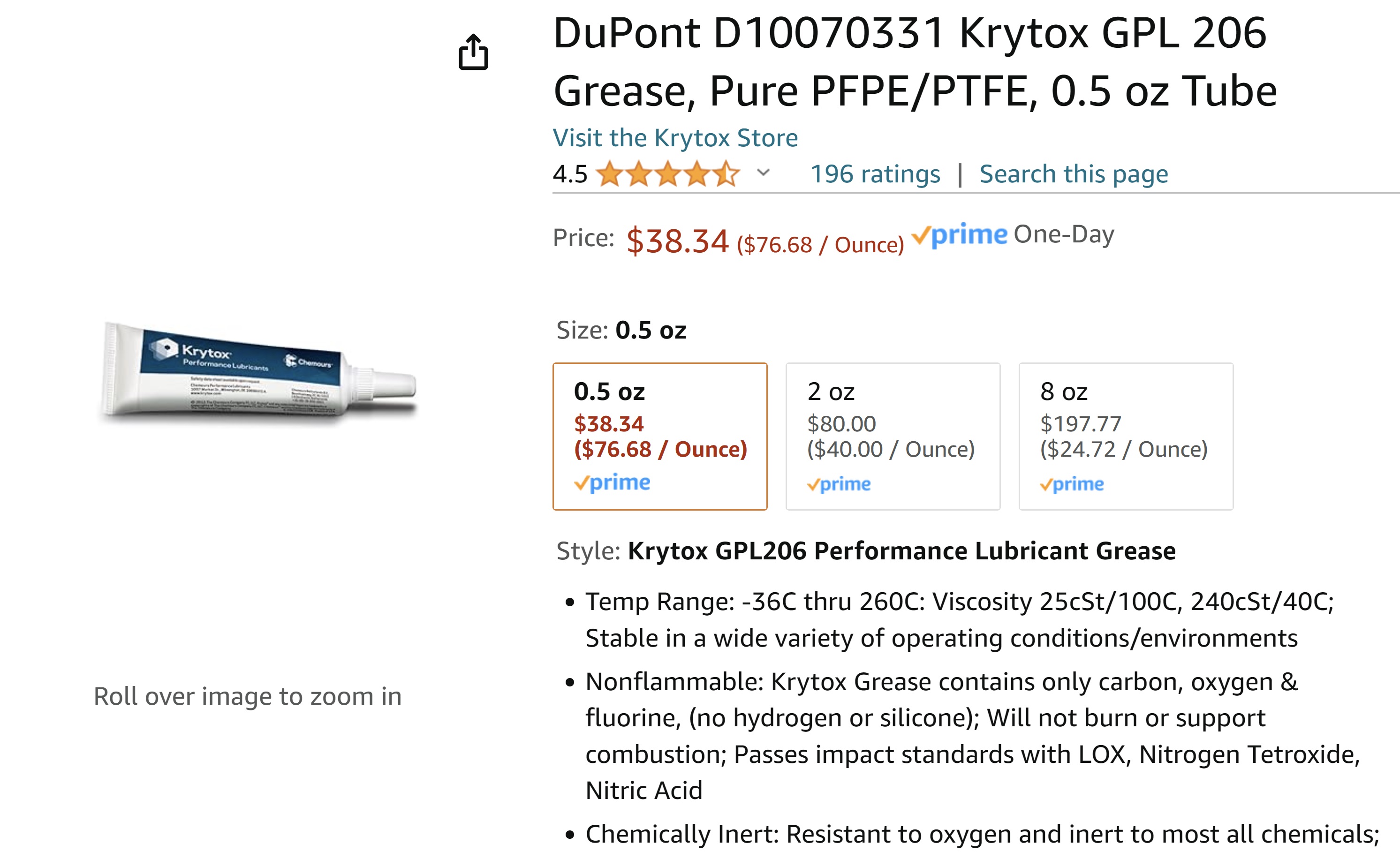

I've posted about Krytox before, but worth repeating. I was introduced to it by my dealer and it's seriously good at killing vibration noises, squeaks, etc. It's especially good on parts that don't lend themselves to felt, like clips, rubber strips, etc. It's not cheap, but one little tube goes a long way.

Hmm... I was told about Krytox and went and ordered some, but it's different. I hope it works the same ha (should be in tomorrow).
The stuff I got is: "Krytox 205 g0 Switch Lubricant"

It's essentially the same, just a different temp range. The 206 is good up to 500F, whereas the 205 tops out at 400F. Both are good down to -33F. For squeaks and rattles inside a car, where it will never reach 400F, one is as good as the other really.
https://www.krytox.com/en/products/gene ... lubricants

I had not considered a grease an anti-squeak/vibration product but it does make sense.
Will have to put it on my list of things to try.
