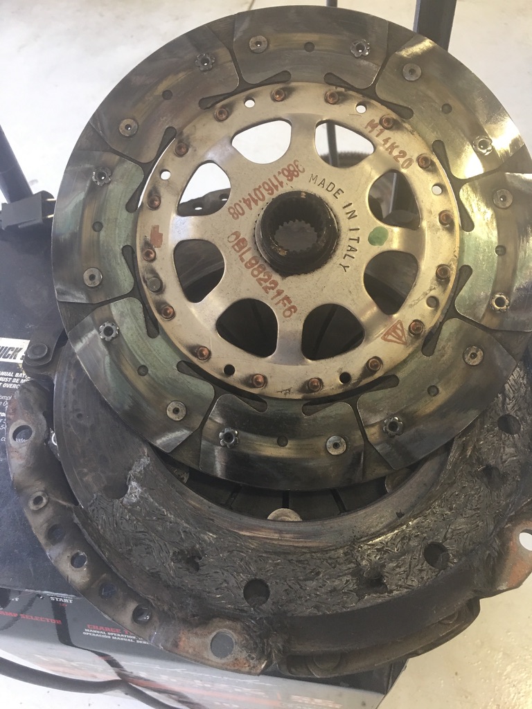

I found myself in a bad situation where the tachometer and my genius brain said it would be better to come out of turn 8 at Road America in 2nd gear and I spent a day rev-matching to get down to second and as my approach got more aggressive, toward the end of the day I broke the car. It cooled off for a while and I ended up driving it home about 200 miles. My mechanic later figured out what I had done - I delaminated one of the two organic surfaces off the clutch. He'd never seen anything like it.
The clutch was replaced and it drove well, and I stopped thinking that down-shifting to 6k rpm was a good idea. I think some turns are why there are 6-speed transmissions.

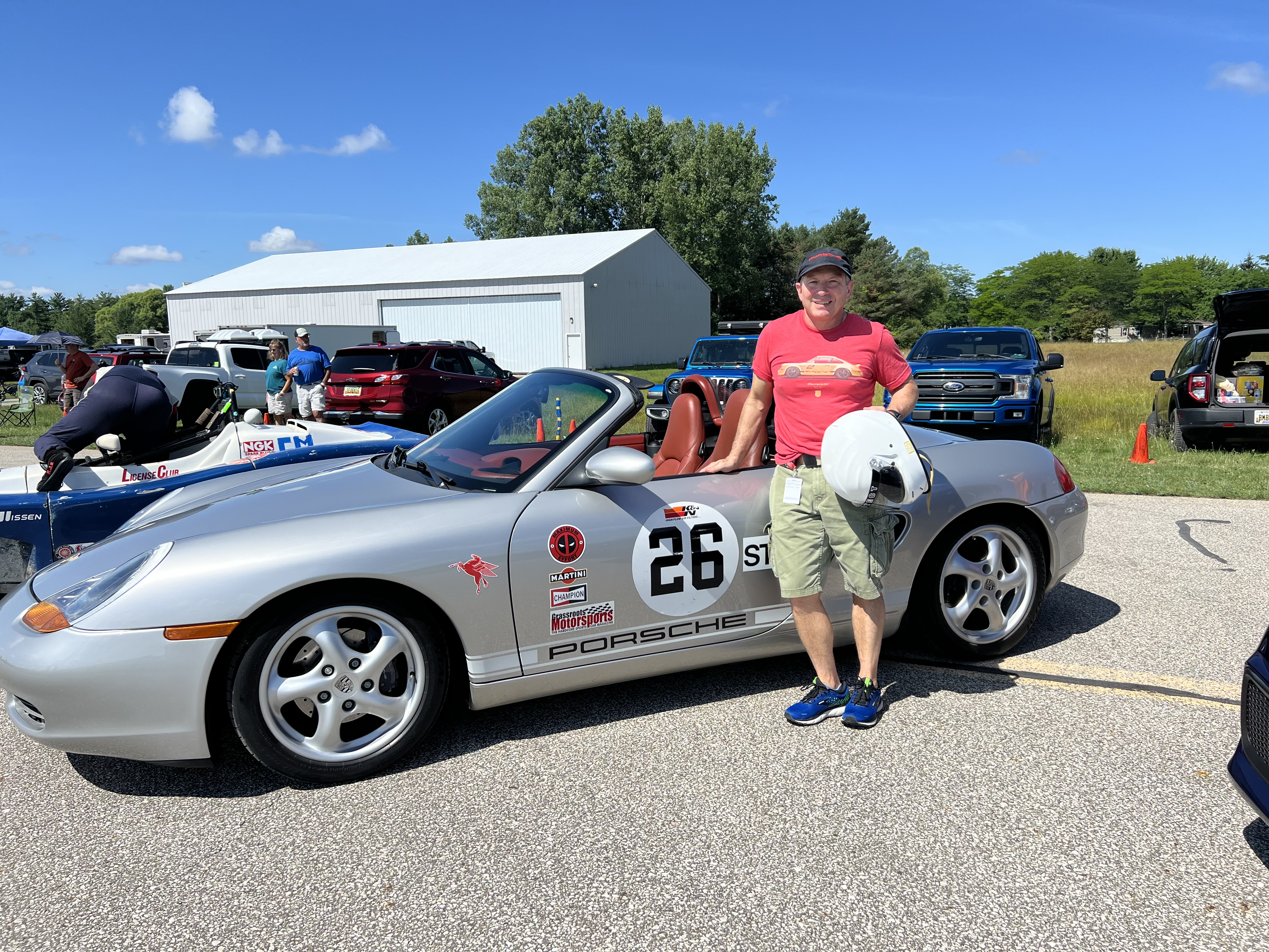

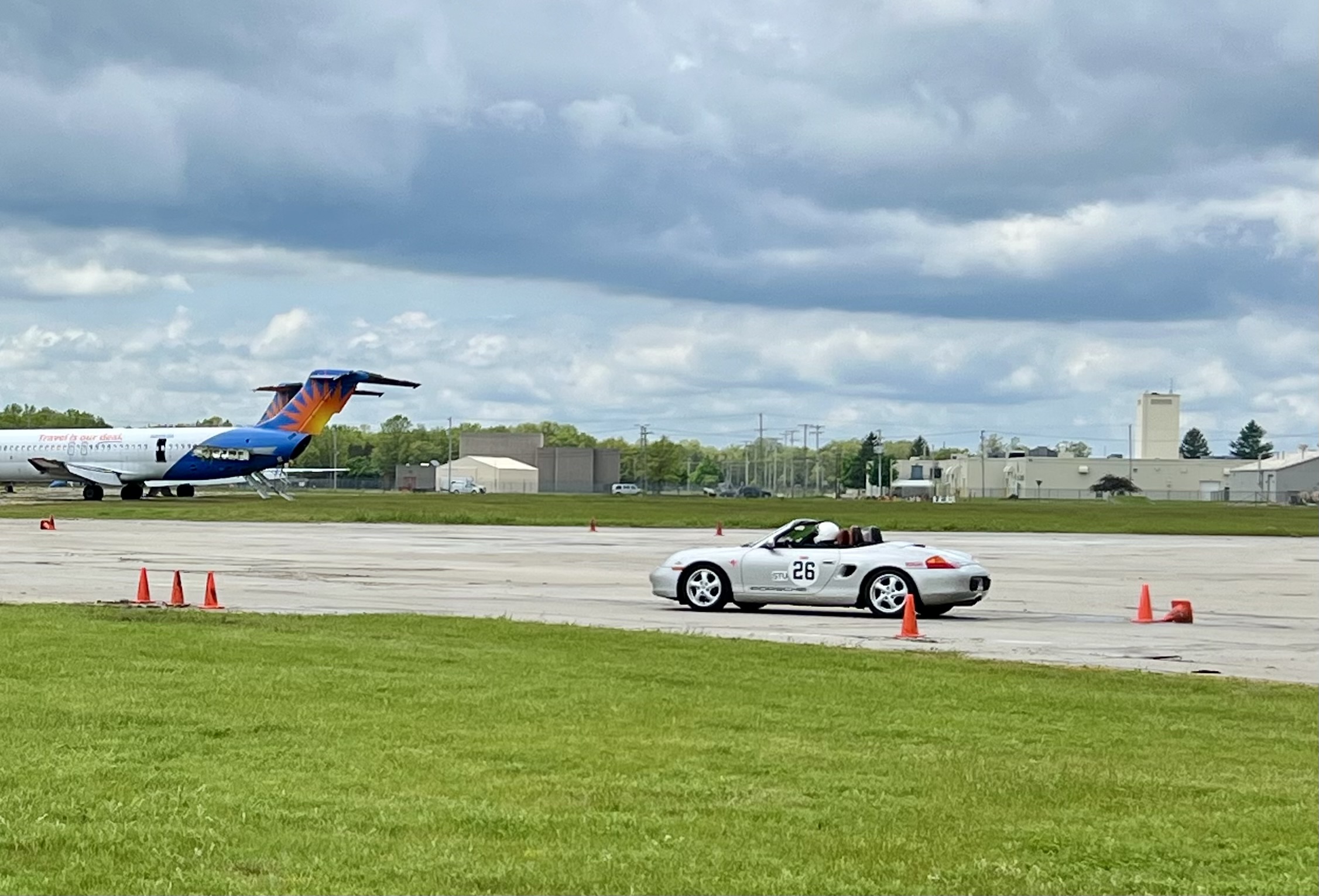

Had a blast autocrossing the Boxster this season at local SCCA events. Unfortunately my season ended early due to an injury (ruptured biceps tendon in a fluke incident while building a treehouse for my grandkids).
I did decide to leave the car as is for this season and will now begin adding improvements based on my experiences behind the wheel.
-comfortable on the road driving to events
-enough power for me
-tall 2nd gear great for autocross cross and rarely needed 3rd gear (only on 1 course)
-too much body roll-plan for coilovers and stiffer front sway bar
-slow turn in-plan for wider front tires, max negative camber, and slight toe out
-all season Continental tires make a miserable autocross tire (sounds like I’m murdering kittens), but has made me modestly adept at controlling the car in a slide- plan for a 200 treadwear summer tire for the street touring ultra class and consider a wider front, maybe even square
-interior bits need upgrades-pedals, shift knob, seat belts/harness, would love to find matching red racing or sport seats
Looking forward to next season!!!

Great write up and it looks like you have a nice site to pulverize pylons, ha!
