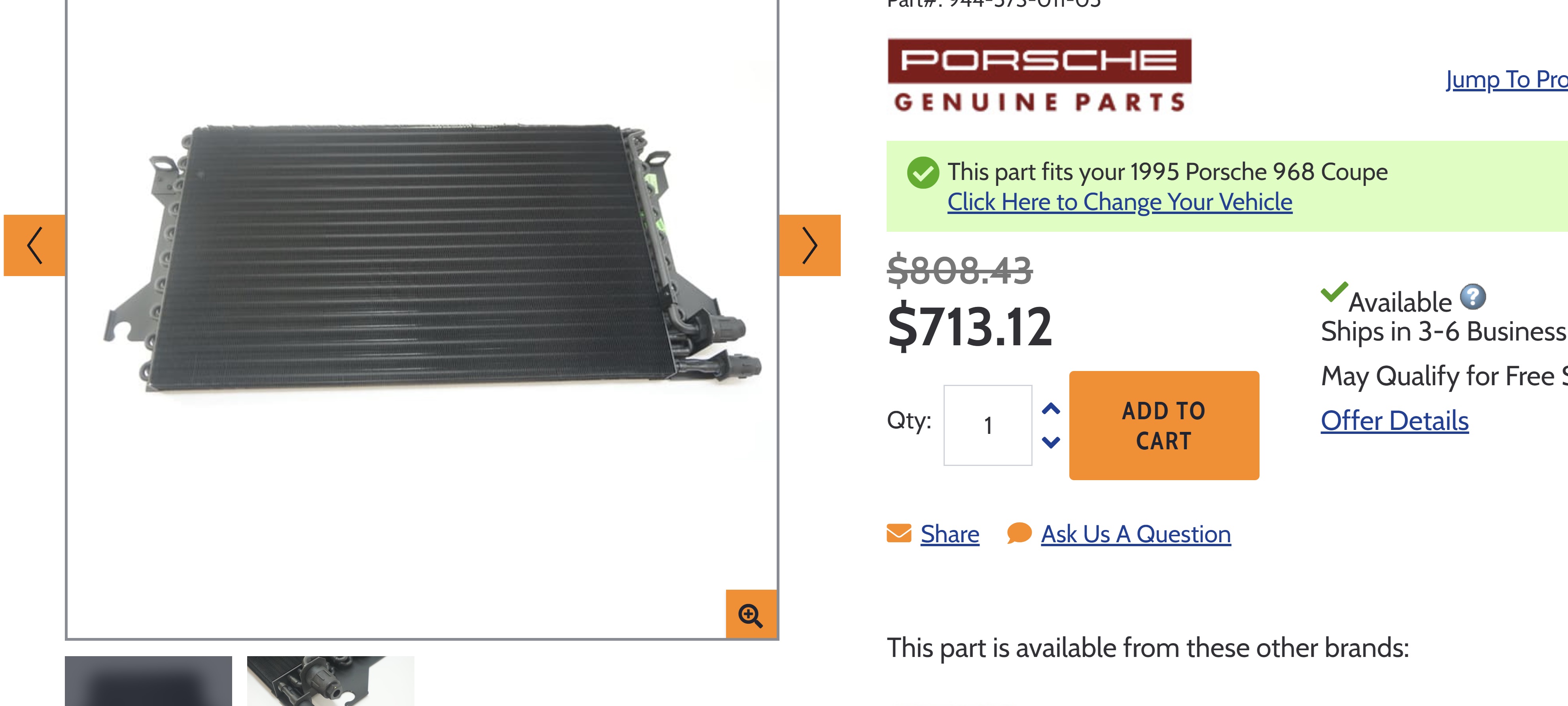

Porsche P/N 944-573-011-05 is available from various sources, including Sunset Porsche for $596.22 (other look slightly less expensive). I'm checking with Delaware Porsche Parts as their catalog shows it is not available... but I've had issues with their catalog in the past, so I sent them a note today to check, as they generally have the best price, and don't charge sales tax, which is significant for WA State. Behr also makes one.
Since Porsche only shows one P/N for all late model 944s and 968s, I'm assuming this is the 968 style cross-flow condenser suitable for R134A.

Hmmm.... I was about to say I'm looking for a parallel flow condenser but you last point about the 968 is interesting. What year did Porsche switch over to r134a? I had a '93 rx7 that was still r12. If you google for this condenser, every picture posted shows the old tube and fin design, like the one that came with my car (and that I still have if needed). For example, here's the one from Pelican... So I guess I'm not optimistic that Porsche is now selling a parallel flow condenser in lieu of the old style, but I'd buy one in a heartbeat if that turns out to be the case!Latitude48 wrote: Sun Jun 09, 2024 5:57 pm Porsche P/N 944-573-011-05 is available from various sources, including Sunset Porsche for $596.22 (other look slightly less expensive). I'm checking with Delaware Porsche Parts as their catalog shows it is not available... but I've had issues with their catalog in the past, so I sent them a note today to check, as they generally have the best price, and don't charge sales tax, which is significant for WA State. Behr also makes one.

Ha, ha, I knew "cross-flow" didn't sound correct. As Tom said, parallel flow is the correct nomenclature. And it seems my assumption was also faulty since the 968 PET shows the 944-573-011-05 for cars up to 1992, and 93- has a blank space for the P/N. That said, most people that use the standard tube and fin design with R134a seem to do fine.Tom wrote: Sun Jun 09, 2024 6:51 pmHmmm.... I was about to say I'm looking for a parallel flow condenser but you last point about the 968 is interesting. What year did Porsche switch over to r134a? I had a '93 rx7 that was still r12. If you google for this condenser, every picture posted shows the old tube and fin design, like the one that came with my car (and that I still have if needed). For example, here's the one from Pelican... So I guess I'm not optimistic that Porsche is now selling a parallel flow condenser in lieu of the old style, but I'd buy one in a heartbeat if that turns out to be the case!Latitude48 wrote: Sun Jun 09, 2024 5:57 pm Porsche P/N 944-573-011-05 is available from various sources, including Sunset Porsche for $596.22 (other look slightly less expensive). I'm checking with Delaware Porsche Parts as their catalog shows it is not available... but I've had issues with their catalog in the past, so I sent them a note today to check, as they generally have the best price, and don't charge sales tax, which is significant for WA State. Behr also makes one.
