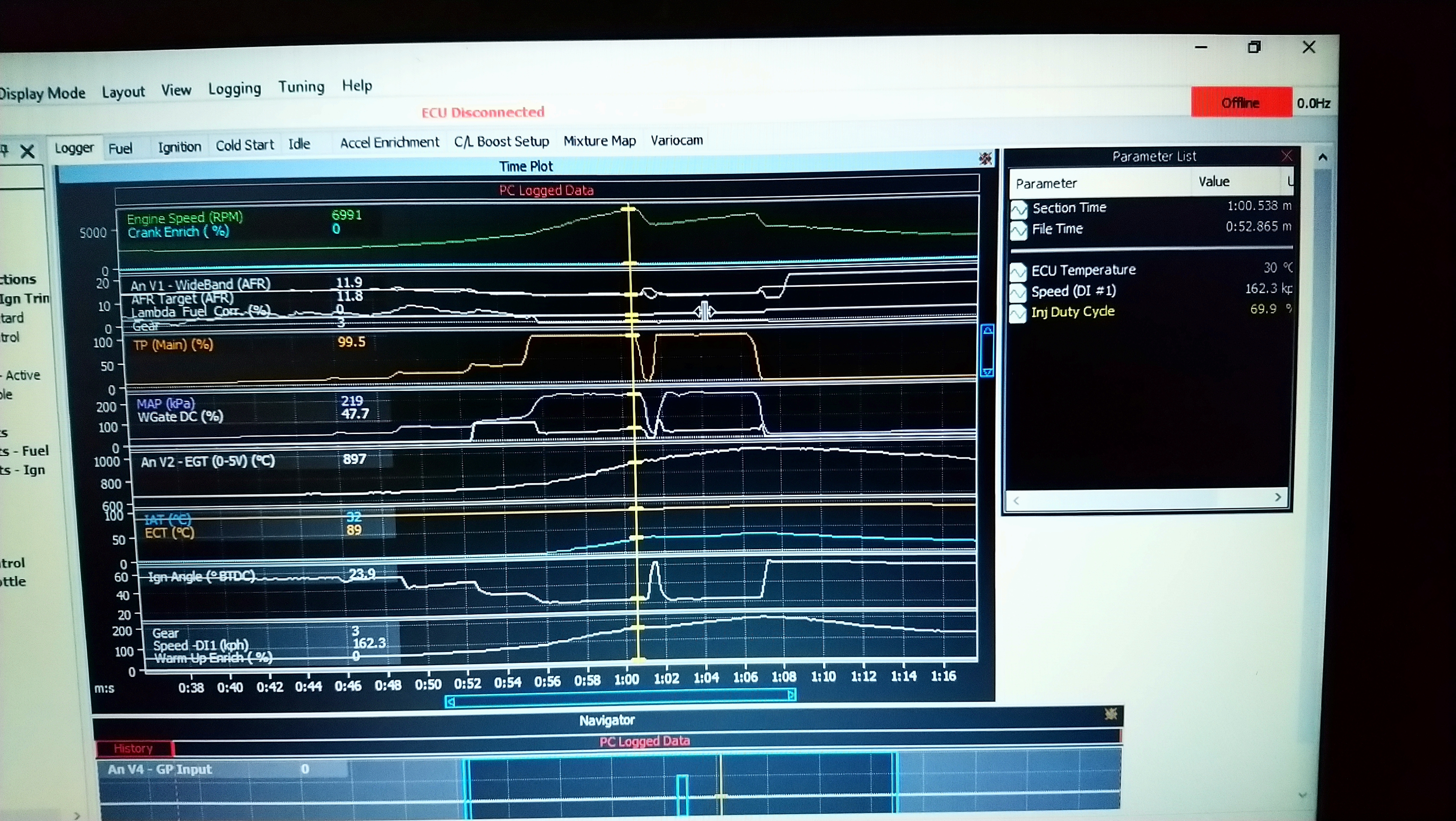

Yesterday's progress. How many hp an injector duty cycle of 70% with 1200cc injectors should give?
The car flies. It was a good move to fit big blacks last year.

I need to upgrade my brakes.... After driving the 992TT, the stock '86 brakes feel like tractor brakes, especially after accelerating hard.
I'd take it with a grain of salt, but this calculator says 533hp (pump gas, 3 bar fuel fuel pressure, turbo 4 cylinder).
https://www.injectorrx.com/fuel-injecto ... alculator/
I'd be more inclined to compare 60-100mph times. Yours looks to be a little over 4 seconds, if the time bar is accurate. Do you have any kind of knock control/monitor? Is that about the boost level you normally run?

Well, it's all work in progress. I didn't have enough time to increase boost or fine tune it. I drive with headphones on, out of a J&S Safeguard. It helps a lot. No knock so far.
