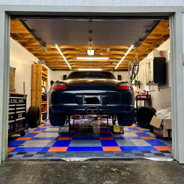

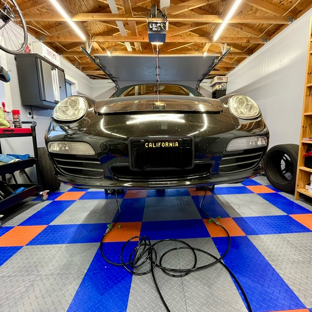

Finally made a little bit of progress!
Dropped the car and moved it around a bit to maximize working area when the QJ is at full height. I may spend a bit more time organizing the garage, though most stuff along the walls is easily movable so I can have working space where I need it.
Removed the wheels, cleaned both sets, and stored them out of the way. Probably due for a new set of AX rubber as the rears are down to the wear bars. Also the left rear has some odd wear patterns; hopefully any minor suspension issues will be resolved after this project is complete.

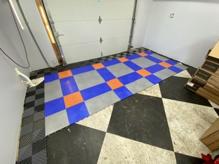

So far the only liquid on the floor has been water. While it is easy to wipe the tops clean, getting in between and/or under would require removing the tiles, which would not be easy. Whenever there is a chance of oil or something else escaping containment, I lay cardboard under my work area to contain the mess. Granted, I would do that anyway with an old car like this all all sorts of crud will get dislodged when working on the underside.aboyandhisdog wrote: Sun Dec 31, 2023 11:51 am Very nice! Love the floor - is it fairly easy to clean up spills? I always wondered about fluids getting into the joints with the tiles.
I’ve had them down for a couple of years and they are holding up fine. The only issue I had was with using jack stands. The tile instructions say don’t use them, and they mean it! Concentrating a lot of weight onto a small area- like the foot of a jack stand- will damage them. Yet more justification for the QuickJack, as it seems to spread out the weight sufficiently such that it’s not causing any problems.
And one more pic to show the ugly painted floor that I covered:

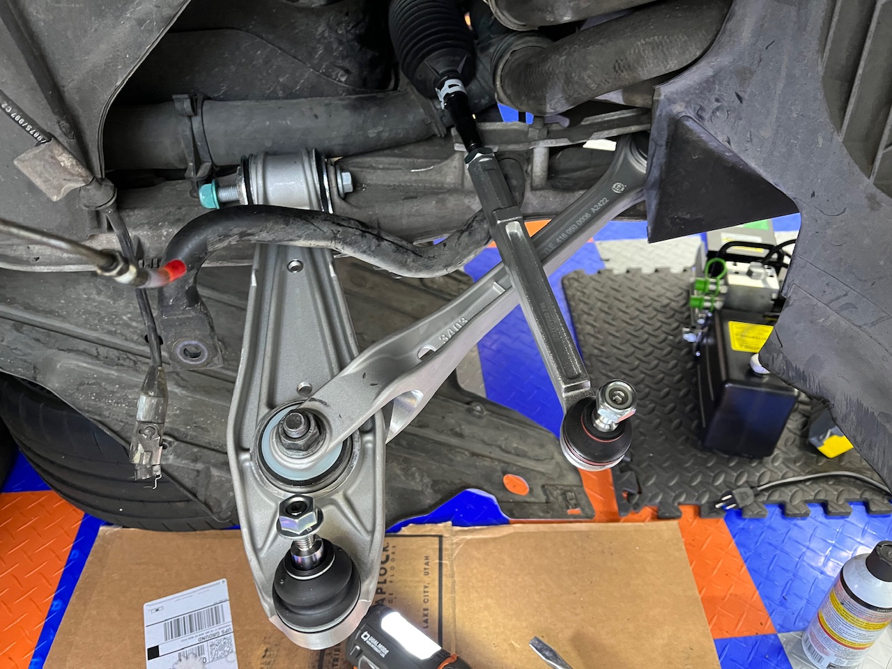

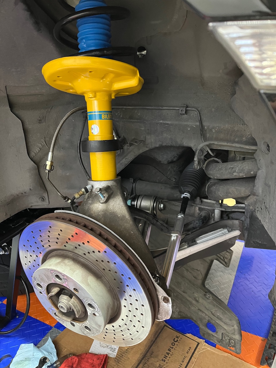

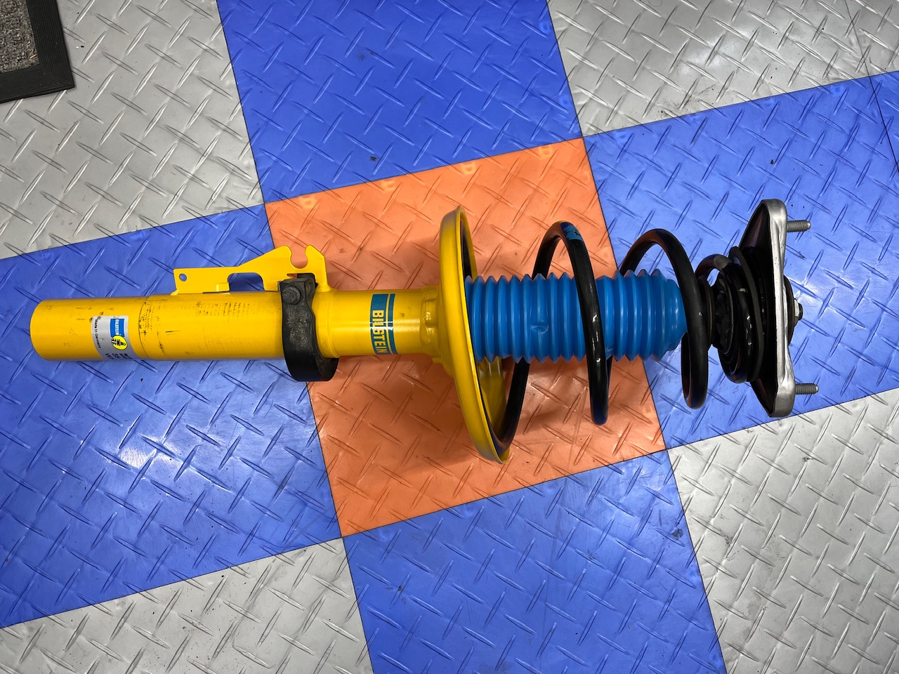

Shiny new parts! This is taking forever! I can only hope that the other corners will go faster. It seems that one never has all the necessary tools or parts on hand.
Still a few more things to do before I finish up the right front.
