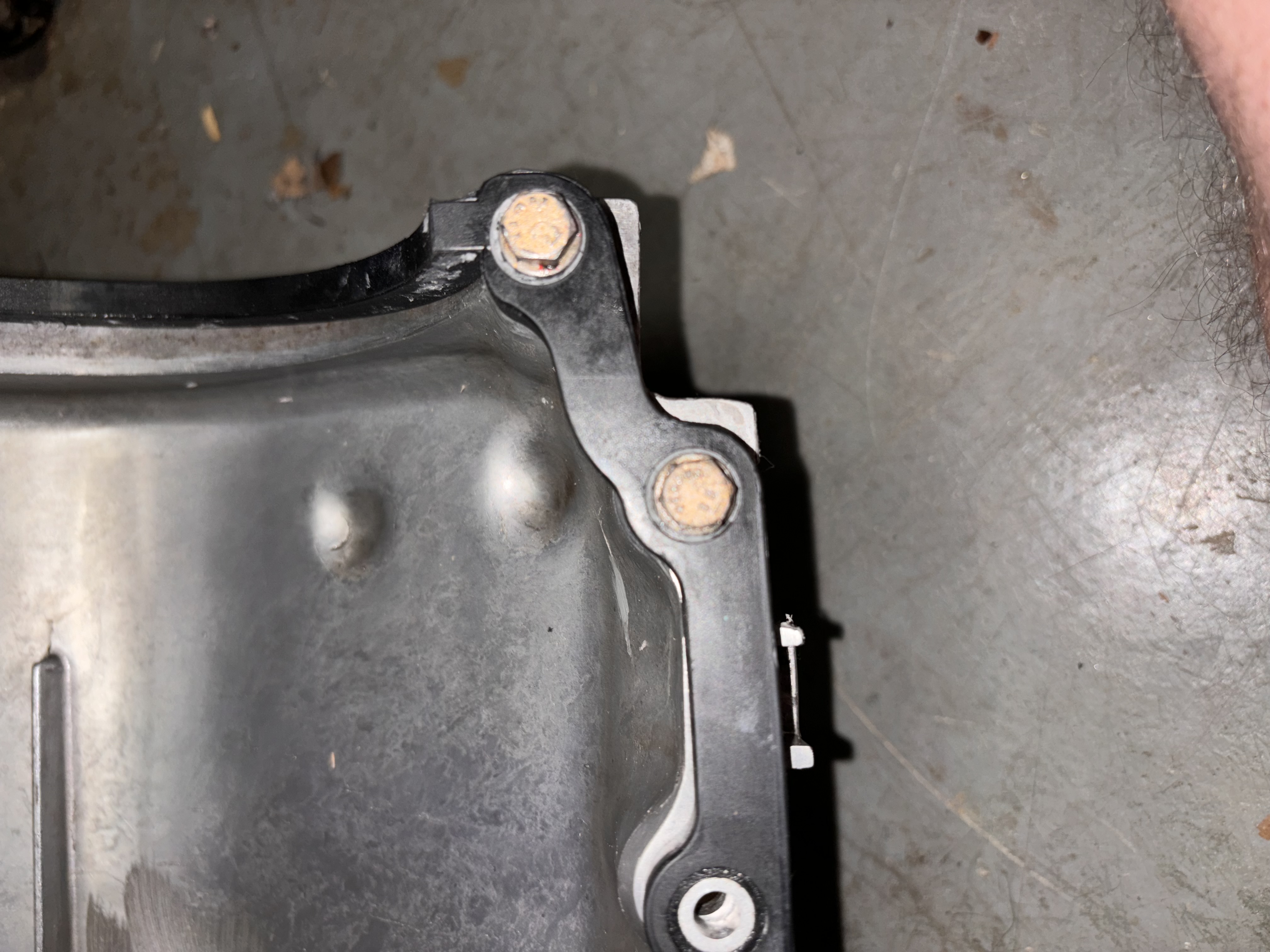

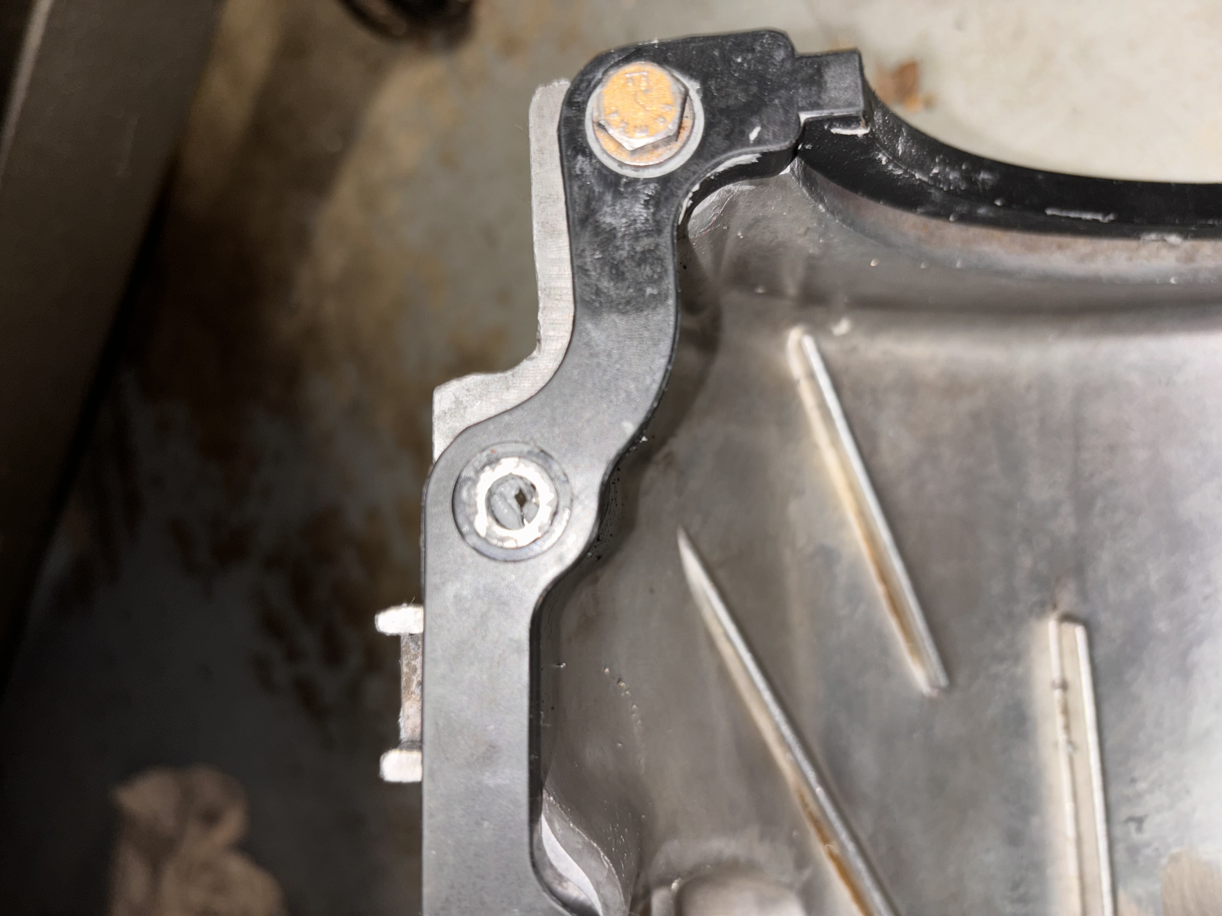

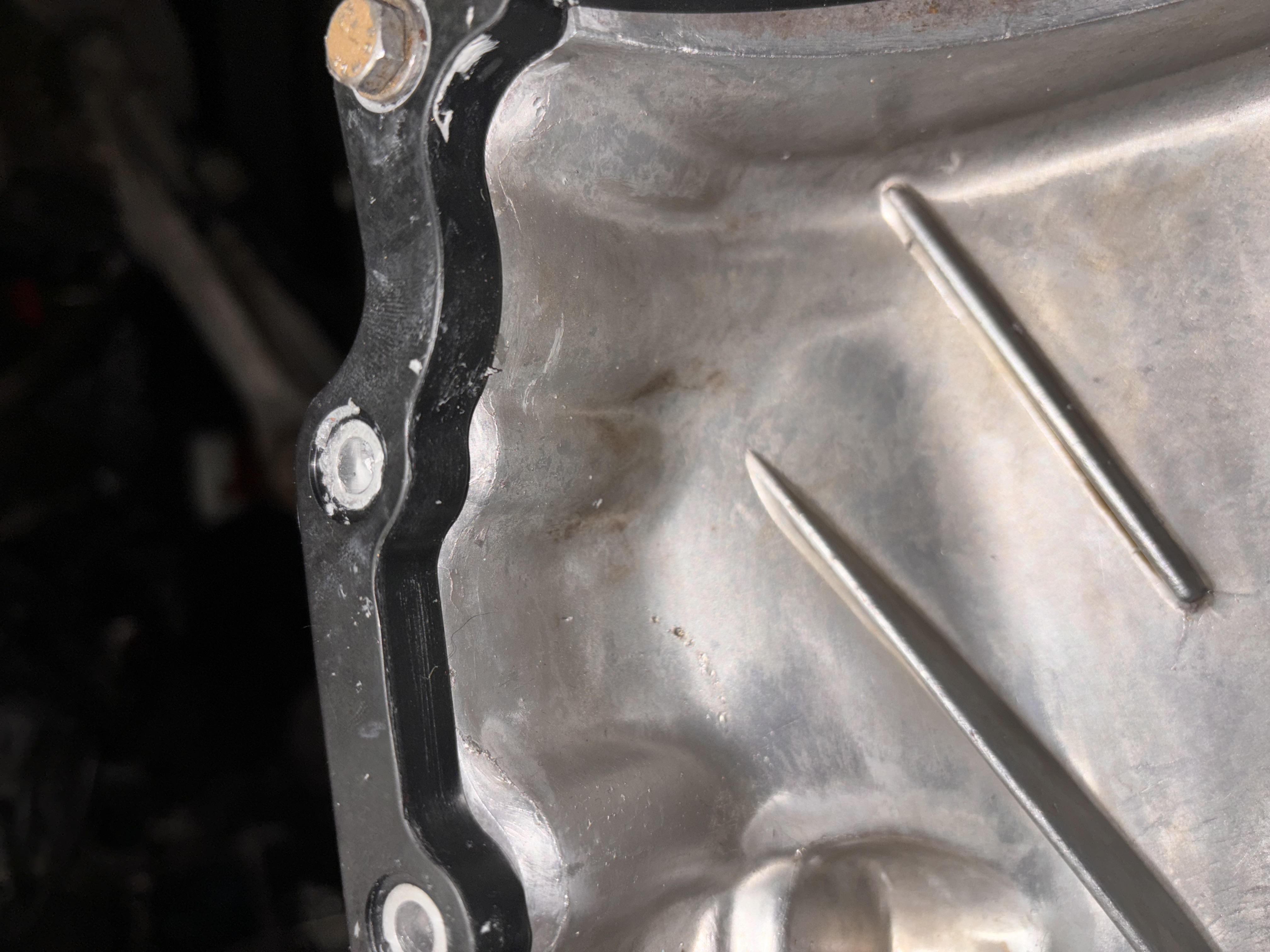

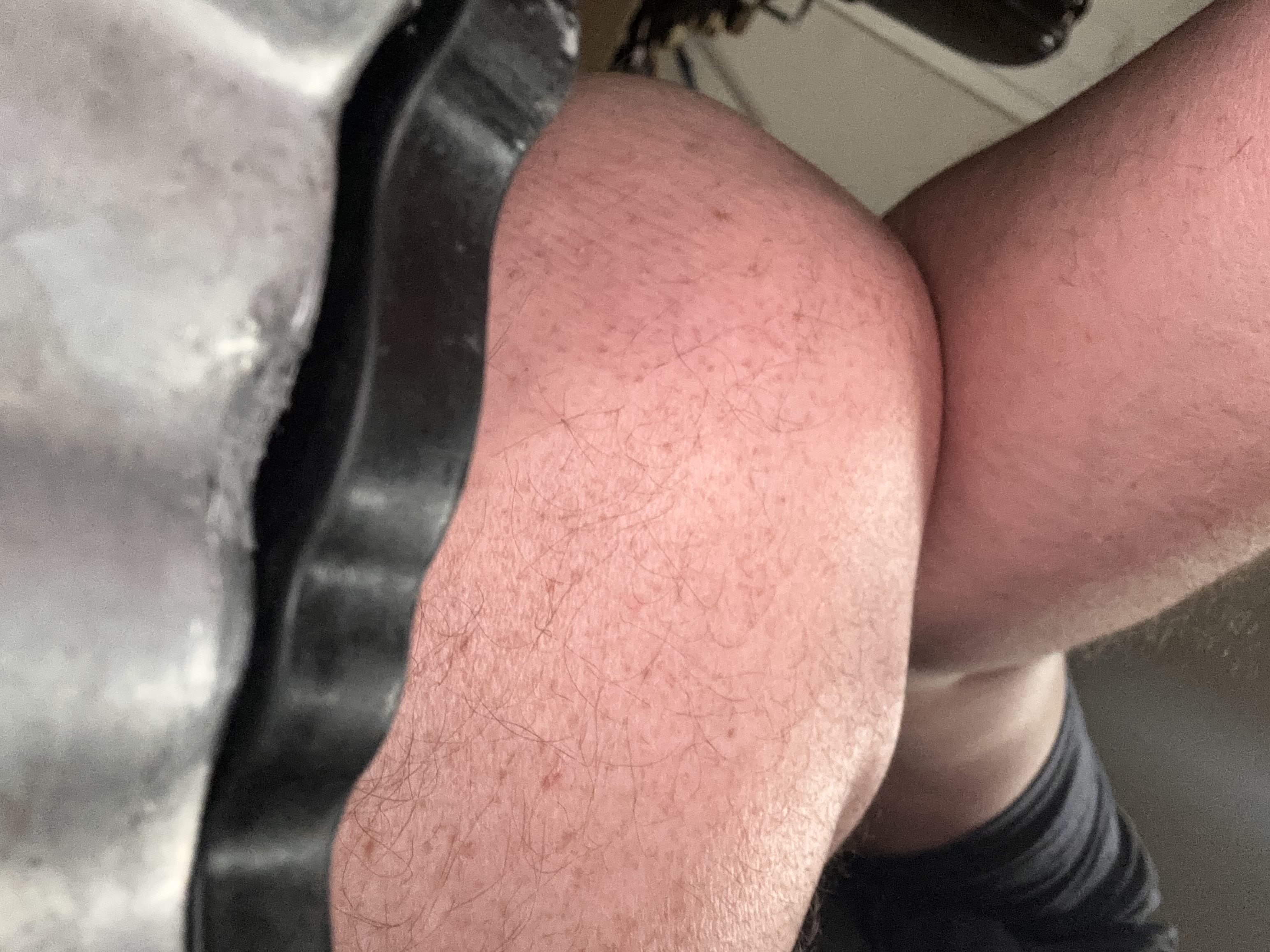

Ok - been a while for this thread but back to it. The initial task of adding yamabond did not work, so ended up having to drop everything and pull the pan.
Initial installation was with the engine upside down on the stand. So I could not see what is shown in the video below. Please take a look and let me know if this is a legit concern or no big deal.
#18
Posts: 8995
Has thanked: 947 times
Been thanked: 4043 times
The camera isn't pointed at the gasket/pan when you show the overlap, so just going off your explanation -- but it's an interesting observation. Is it a factory gasket and/or a Victor Reinz gasket? If so, their track record suggests it's not an issue. If it's another brand, I'd be curious to see how it compares to the factory gasket shape....?
#19
Drscottsmith
Posts: 230
Joined: Thu Feb 16, 2023 5:43 pm
Been thanked: 15 times
Here are some pics. I put a few bolts in just to hold the corners and one at the ‘questionable corner’
The last pic is taken from inside looking up and you can see the Ill-fitting corner.
I am pretty sure this is a reinz gasket.
I don’t have the old one to compare.
