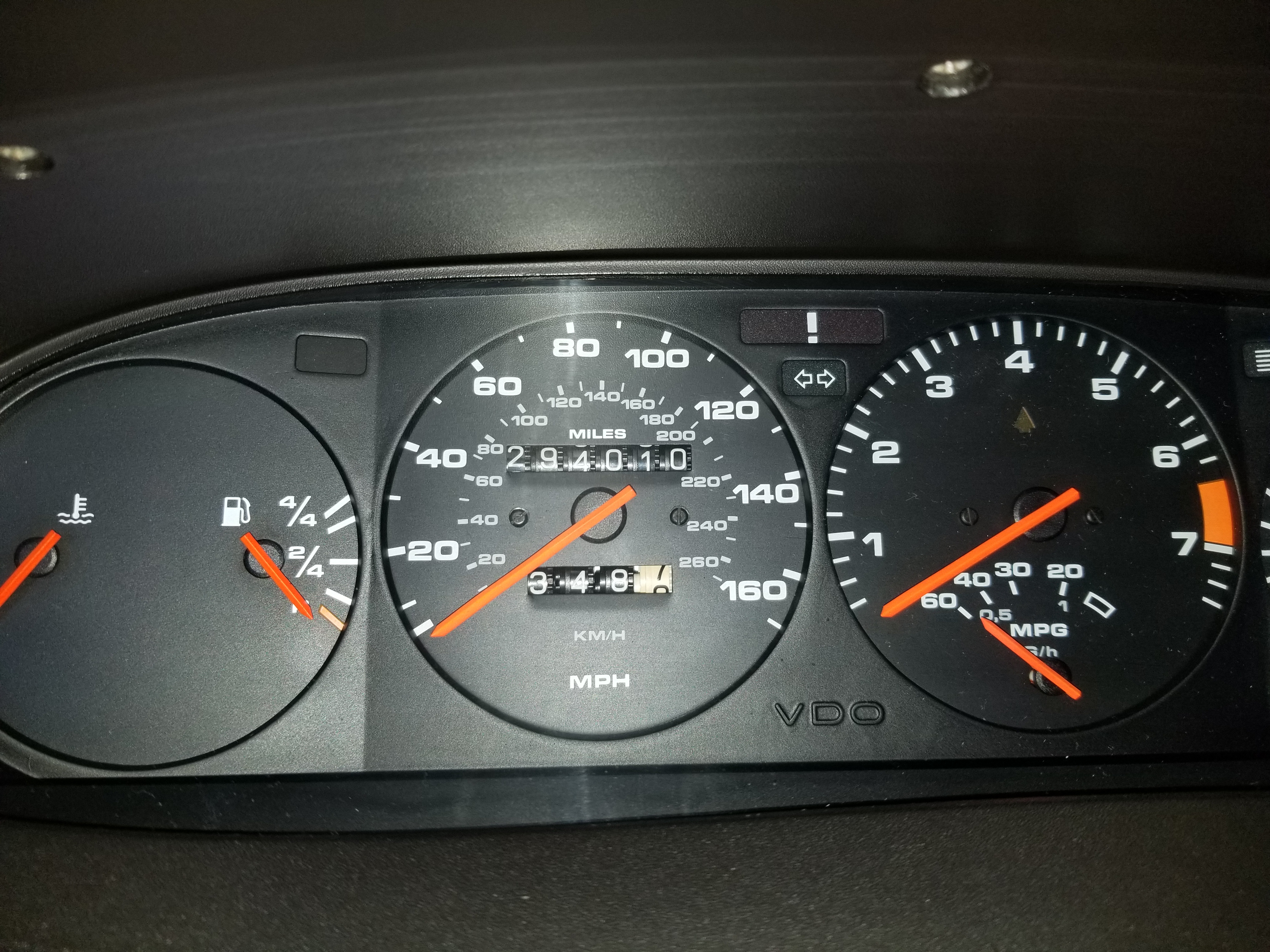

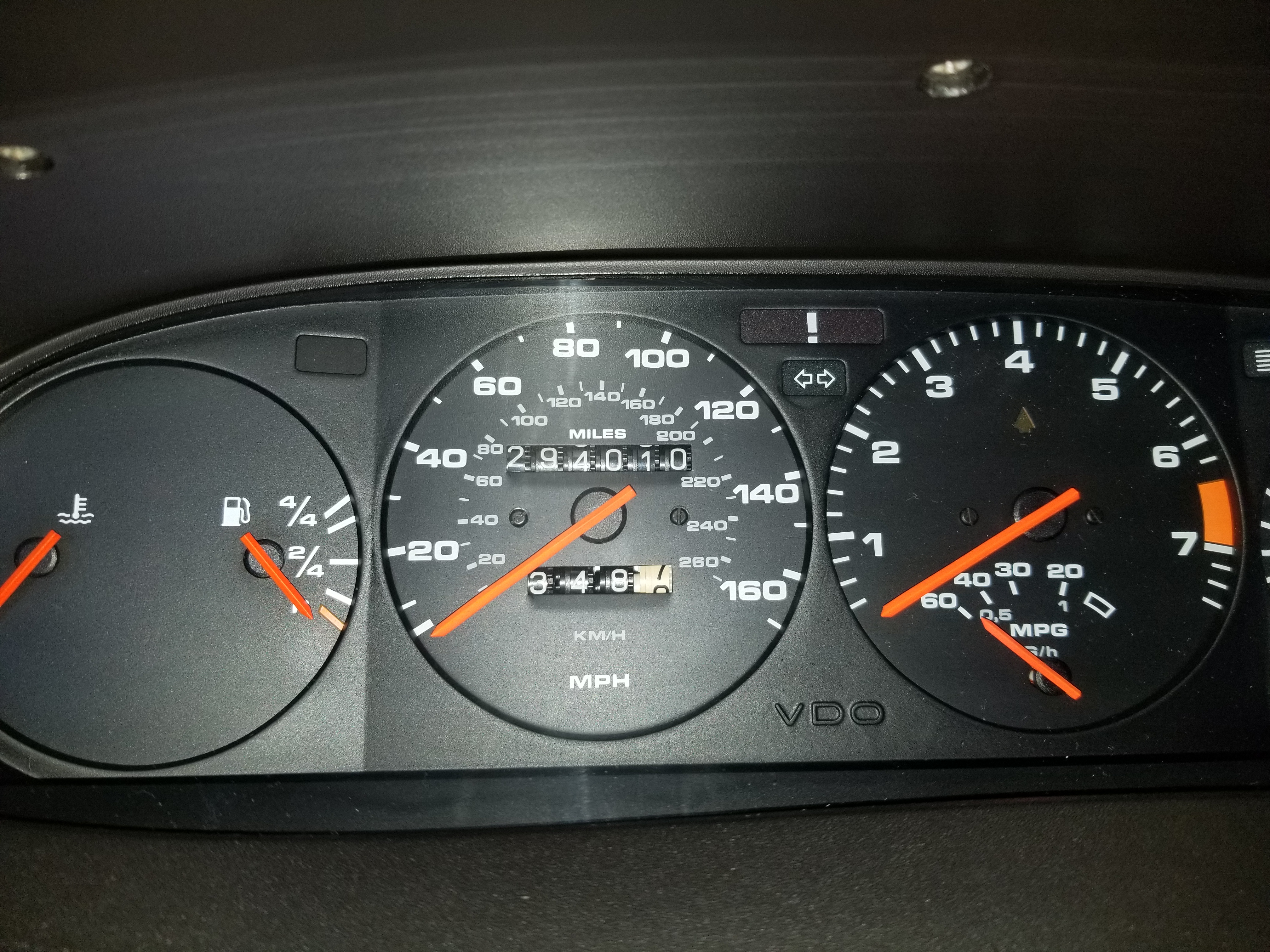

I had the white spots on the instrument cluster plastic surround. Looked like the measles. I took apart the cluster, sanded the plastic and repainted the plastic with a flat black spray paint. Did this about 2 years ago. Still happy with the results.
download/file.php?mode=view&id=11946
- Instrument Cluster 294xxx.jpg (4.69 MiB) Viewed 1975 times

That looks outstanding! Any particular paint you used? Were you able to get the lens off in one piece and just glue it back on?dlarsen944 wrote: Sat Nov 04, 2023 6:04 am I had the white spots on the instrument cluster plastic surround. Looked like the measles. I took apart the cluster, sanded the plastic and repainted the plastic with a flat black spray paint. Did this about 2 years ago. Still happy with the results.

I used a rust-oleum flat black spray paint (made for use on a variety of materials included plastics). Took my time spraying the paint, as to avoid runs (3 light coats). The lens wasn't much of a challenge removing, as the adhesives age was losing its grip. I also used Meguiars PlastX polish to remove any fine scratches in the lens. Gluing it back on, I used a Loctite product for plastics.

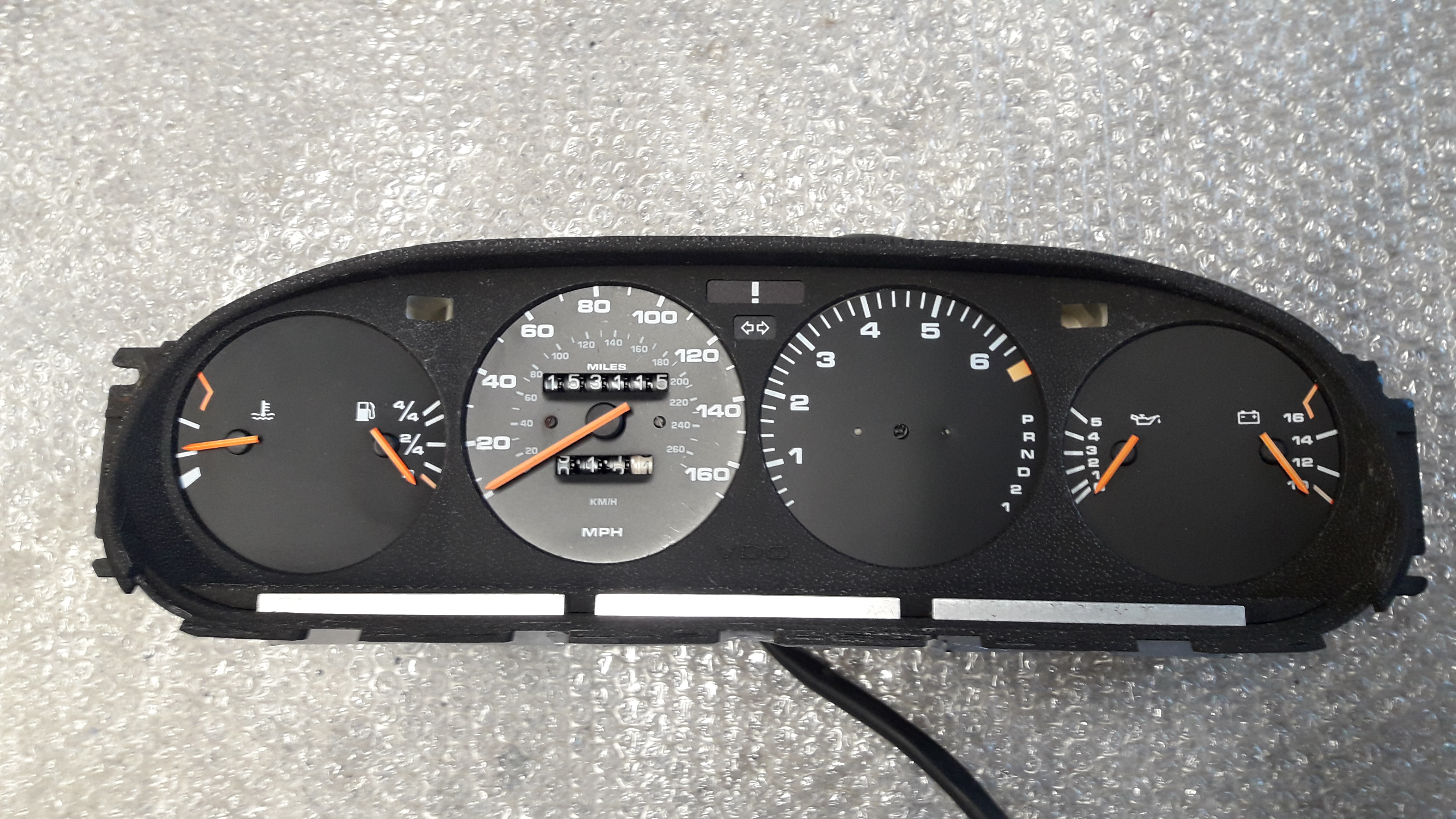

I sanded and painted mine. The spotting on mine wasn't too bad, but I didn't know that until I tried to get a replacement from a well-known US breaker and it was worse! Definitely not worth the money and effort to ship and import to me in NZ.
I used flat black SEM paint and it came out great!
- Refurbed '86 cluster
- gauges.JPG (113.02 KiB) Viewed 1923 times
- bad donor
- 20210520_163923.jpg (3.62 MiB) Viewed 1923 times

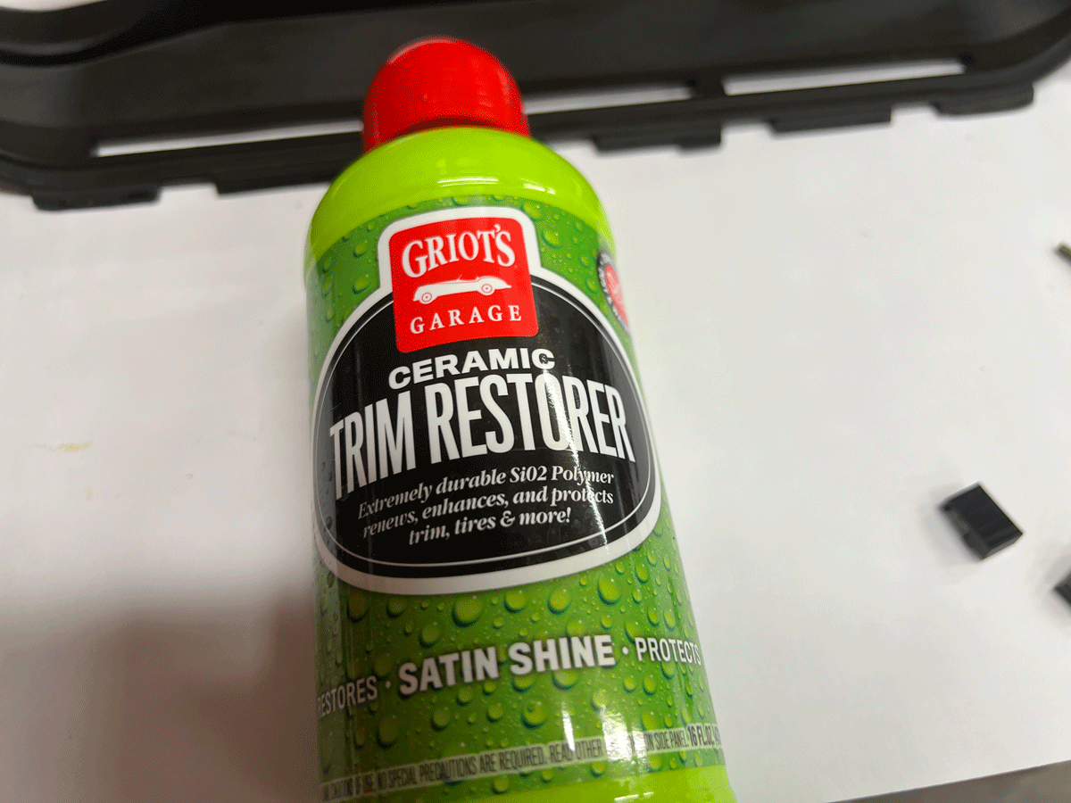

Bumping this one to give a thumbs up to this 'ceramic' trim restorer from Griot's. I bought it on a whim, but have to say it creates a very nice look on the black plastic -- not greasy or shiny, just newer looking.
