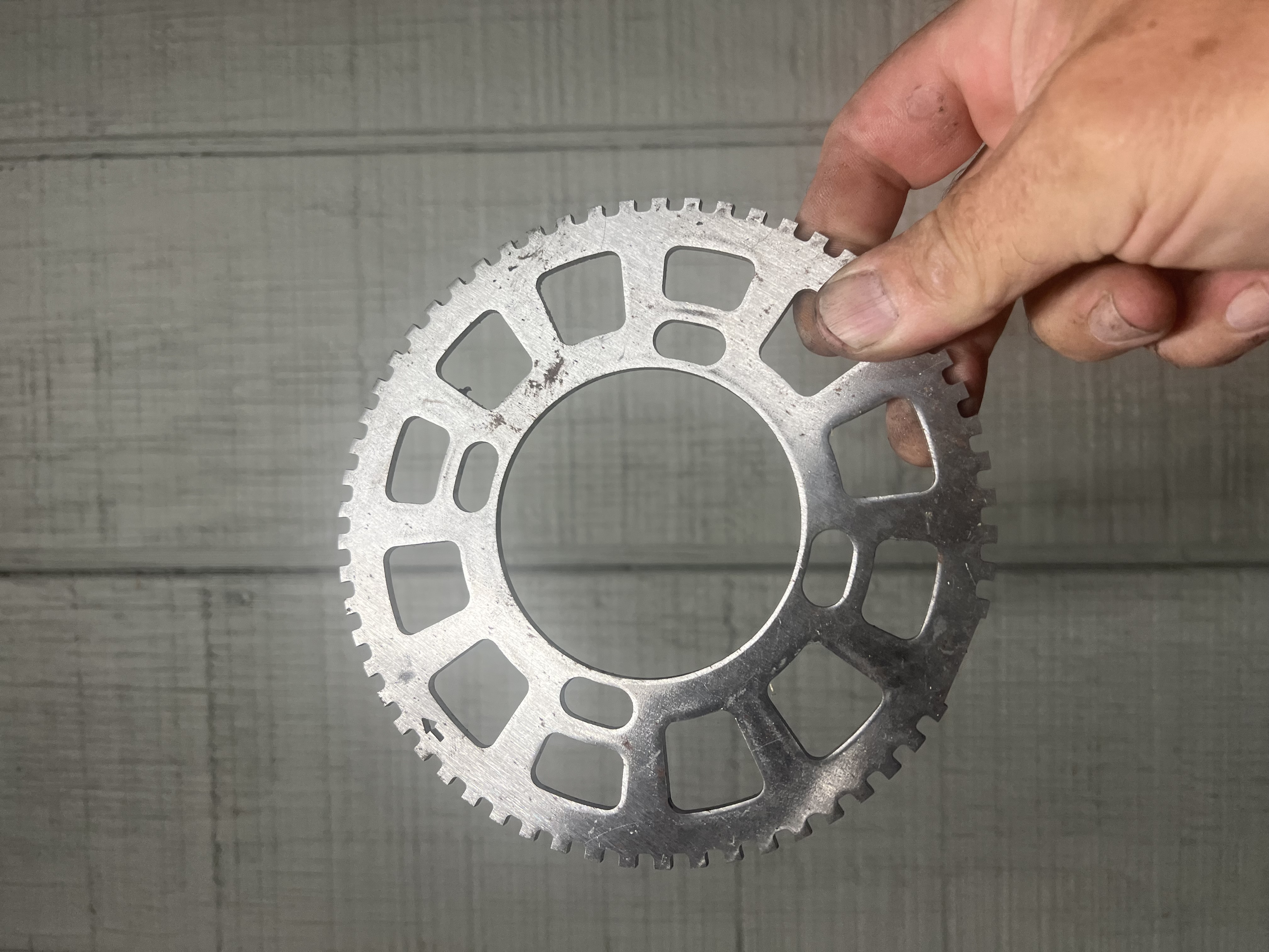

Here’s a pic of the trigger wheel I made up.
Drscottsmith
Posts: 230
Joined: Thu Feb 16, 2023 5:43 pm
Been thanked: 15 times
Nice work!!
