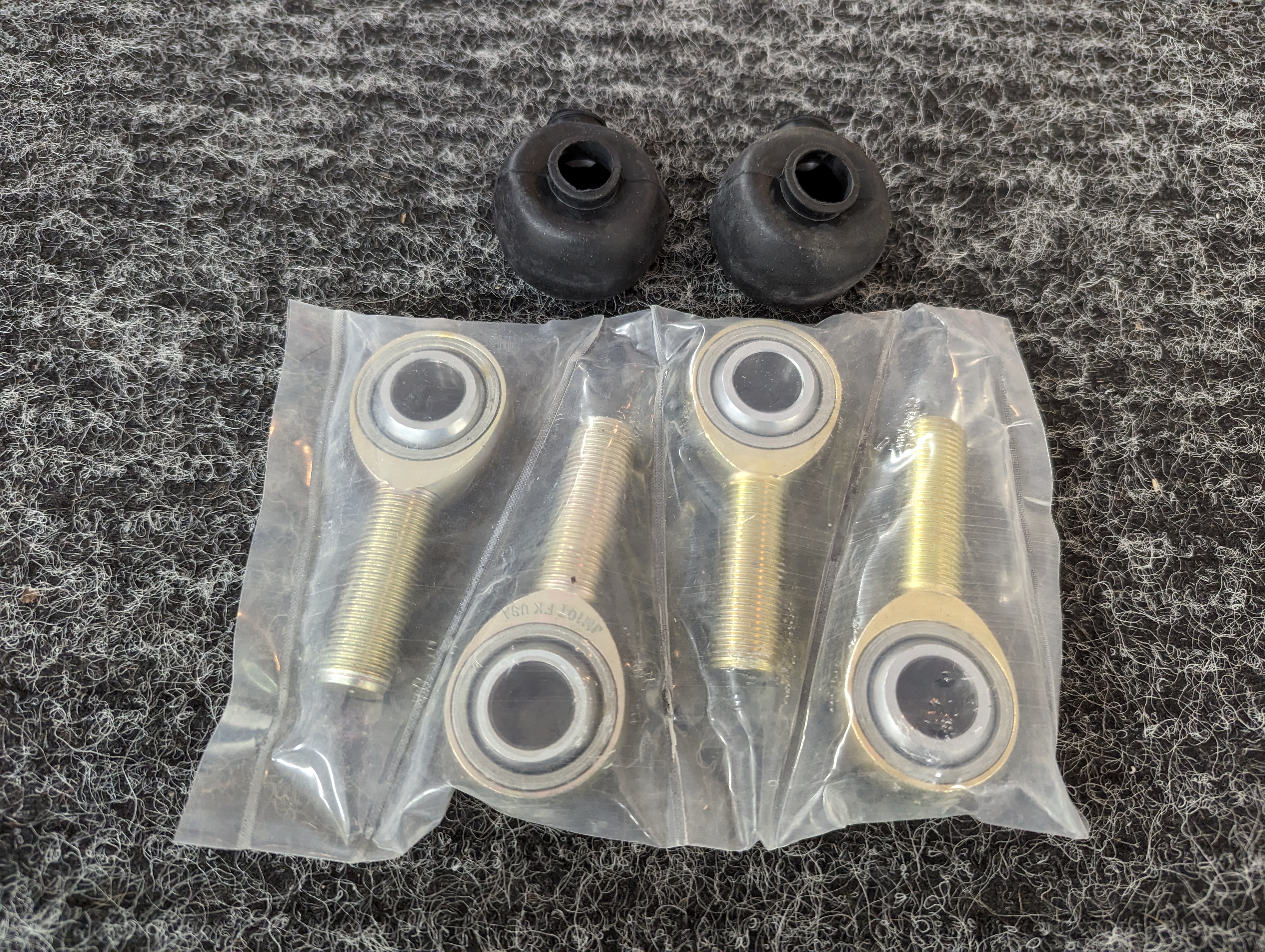

Replaced the Tarett rod ends for the rear toe links. All four are now new - inner and outer, both sides. (There was a very slight bit of play in the inner passenger side rod end. That was after about 1,850 track miles on the original Tarett setup.)
I think the new Tarett ends are somehow better than the originals - something about being tighter. In any event, they are inexpensive and it's best to replace all four as a set.

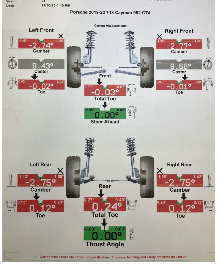

The rod end replacements required a fresh alignment. Nick was able to eke out a bit more negative camber all around to -2.75 square. (He does one heck of a job. Perfectionist.) That's all the negative camber there is out of the current setup but I think it's about perfect for my needs.

Bill, with stock components, the max negative camber I could get in the rear was -1.71 (left) & -1.73 (right). For the front, the max with stock parts was -1.78 on both sides.

On my GTS I am at 2 deg rear camber, 2.5mm per side toe in and the eccentrics still have more room to go. I am not sure why this differs between the GTS and the GT4.

There are differences but I'm not sure of the exact specifics. (The GT4 uses some GT3 parts on the front suspension.)
From an accomplished Porsche instructor, racer, and racecar builder and set-up wizard who is also a good friend:
“If we take some lessons from PMNA, the Clubsports come with 2.5 degrees of camber, modified upper strut mounts, more shims, offset wheels and turnbuckle style rear arms. On race cars I immediately add a full degree (3.5 degrees) in the front and leave the rear at 2.5 degrees. Toe-out in front and nominal toe-in for the rear to stabilize high speed braking. Then a corner balance!"
"As I mentioned before, the factory GT4 suspension has limited settings. To get max camber and toe-out you are at the limit of the eccentrics, slots and rod lengths. This is why you must change them with components that already have some camber with broader ranges built into them."

Also, this older emailed info from Nick (lead Gold tech/shop foreman at PoN) June 2021:
“I’ve got your car up on the alignment rack and the most camber I can get out of the front is -1.8 on each side. I was going to look into using control arm shims like on a GT3 (they are GT3 lower control arms) to achieve -2.00 or -2.50. However, I found this detail in the [Porsche] workshop manual:”
Front-axle camber setting: The camber adjustment on the front axle on the Cayman GT4/Spyder is performed only via the supporting mount. The intermediate plates -Arrow- on the 2-part wishbone must not be changed, as this can result in an impermissible wheel overlap at the wheel housing.
(This is a straight quote from Porsche tech svc manual.)
