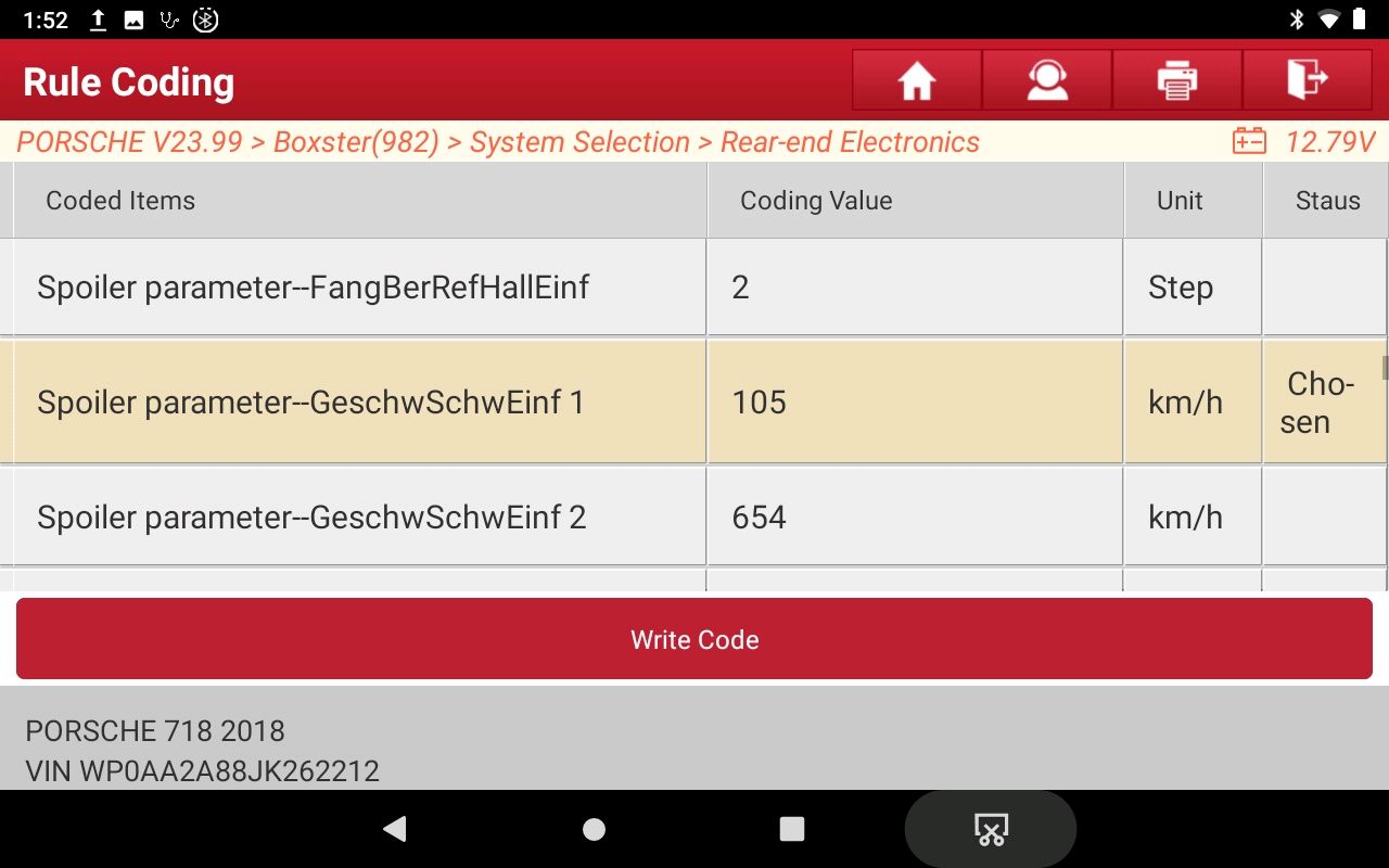

I've found, changed and tested the spoiler deploy speed. It's one of the parameters that is not fully translated from German.
The default of 125 kph is 78 mph, and with the normal speedo error of reading about 2 mph fast, it seems to deploy at 80 mph indicated. You can go higher or lower here, depending on your need. I dropped mine to 105 kph (65 mph) because I seem to frequently drive in windy conditions where the spoiler helps even at lower speeds. If you have added a GT4-style wing, you can effectively disable the spoiler by bumping the speed way high, like 299 kph.
Spoiler Deployment Speed
  • System Selection > Rear-end Electronics > Spoiler parameter--GeschwSchwEinf 1 = your target speed in kph
    {Default: 125}

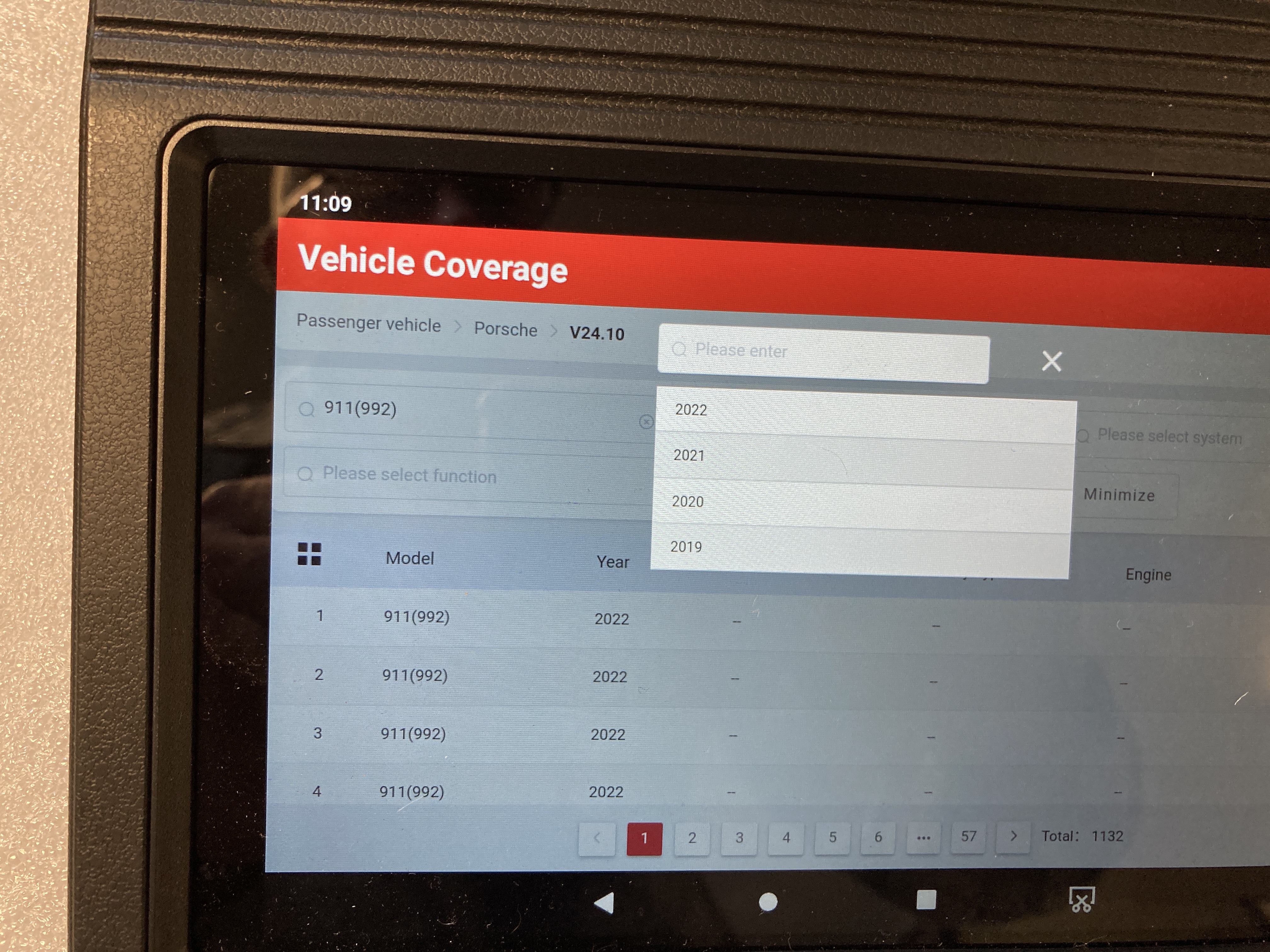

Best place to buy is through Amazon. That way if for some reason it won't talk to your car you can return it. There is a bewildering array of Launch devices with a wide range of prices available. You want one with the X431 software, with "bi-directional" or "coding capable" in the description. Almost all of them will do this. The main differences will be in the Android tablet that it comes preloaded on - primarily screen size and tablet processor and memory. If you can live with a small screen they are much more affordable than what I paid for the big unit I have.
The X431 system consists of an Android device with the X431 app pre-loaded, and a bluetooth OBDII dongle.
The device needs a live wifi connection to the internet to work, as some of the translations and descriptions appear to be downloaded in real-time.
I normally tell it to do "Intelligent Diagnose", which causes it to query the OBDII port for the VIN, and identifies the car's year, make and model. But you can manually specify the car. I went to the Vehicle Coverage menu in mine, and it does list 992 as covered. (See below.) I don't know if the A-S/S codes are in the same path as my 718, but I suspect it is likely. I'd actually be interested in trying this on someone's 992 to find out. I'll need to check for public wifi at our next PCA C&C...

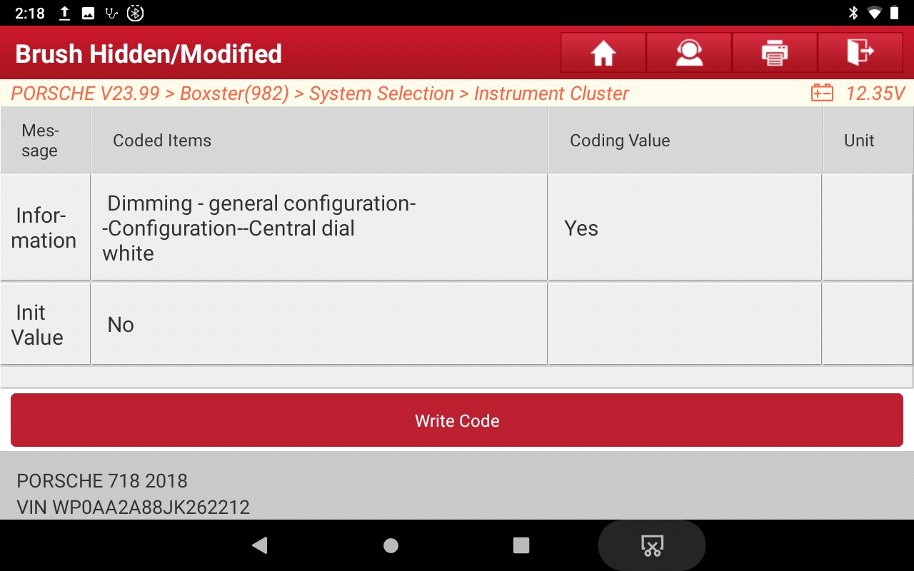

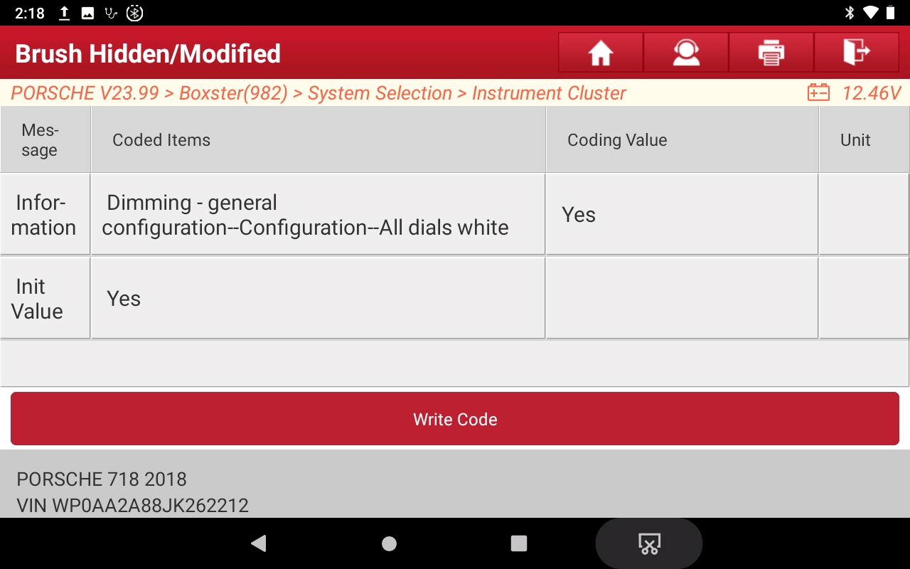

You can enable backlighting on the tach and speedo with headlights off. This makes all the numbers readable in daylight, but does not illuminate the gauge needles. You can turn on the central tach dial only, or both speedometer and tach.
Daylight gauge backlighting on
  • Instrument Cluster > Dimming-general configuration > Configuration-central dial white = YES
    {Default: No}

  • Instrument Cluster > Dimming-general configuration > Configuration-all dials white = YES
    {Default: No}

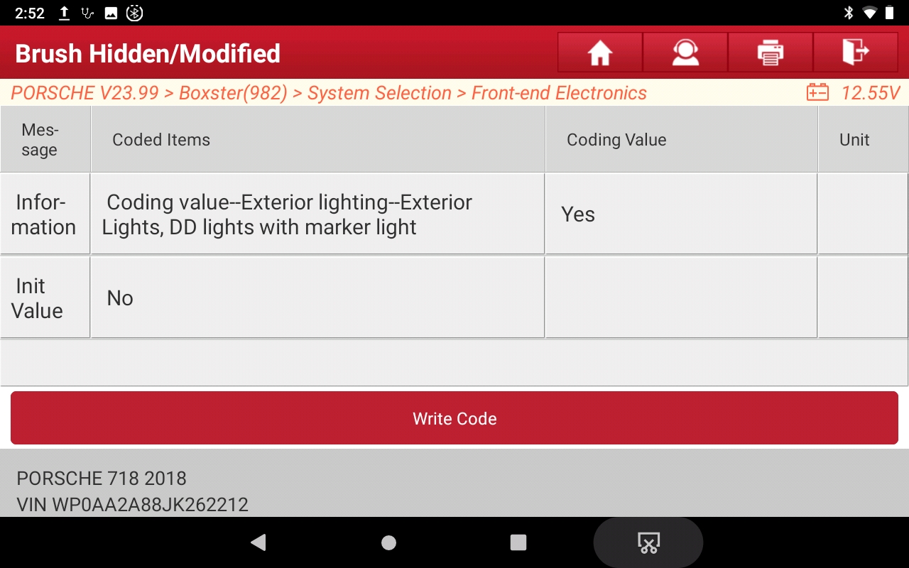

The white-gauge-face hack posted here to turn on the gauge backlighting at all times has one drawback—the gauge needles don't light up unless the lights are actually on.
There is an other way to light the gauges that lights the needles as well. That is done by adding the "marker lights" to the DRL settings. (This is known as "Scandinavian DRLs" in Audi and VW parlance.) The "marker lights" are the tail lights, license lights, front side markers (in the US and Canada) and the gauges including the needles. By default (at least on my 2018 CB), the front parking lights are NOT activated by this change. (There is a separate option to turn these on with DRLs.) But the gauges (incl. needles) do come on with the key, in any light. The drawback to this one is that while some people can tolerate running the tail lights at all times, having the front side markers always lit bothers them. To address that, check this next post.
Gauges w/needles (aka Scandinavian DRLs)
  • System Selection > Front-end Electronics > Coding value--Exterior lighting--Exterior lights, DD lights with marker light = Yes
    {Default: No}
