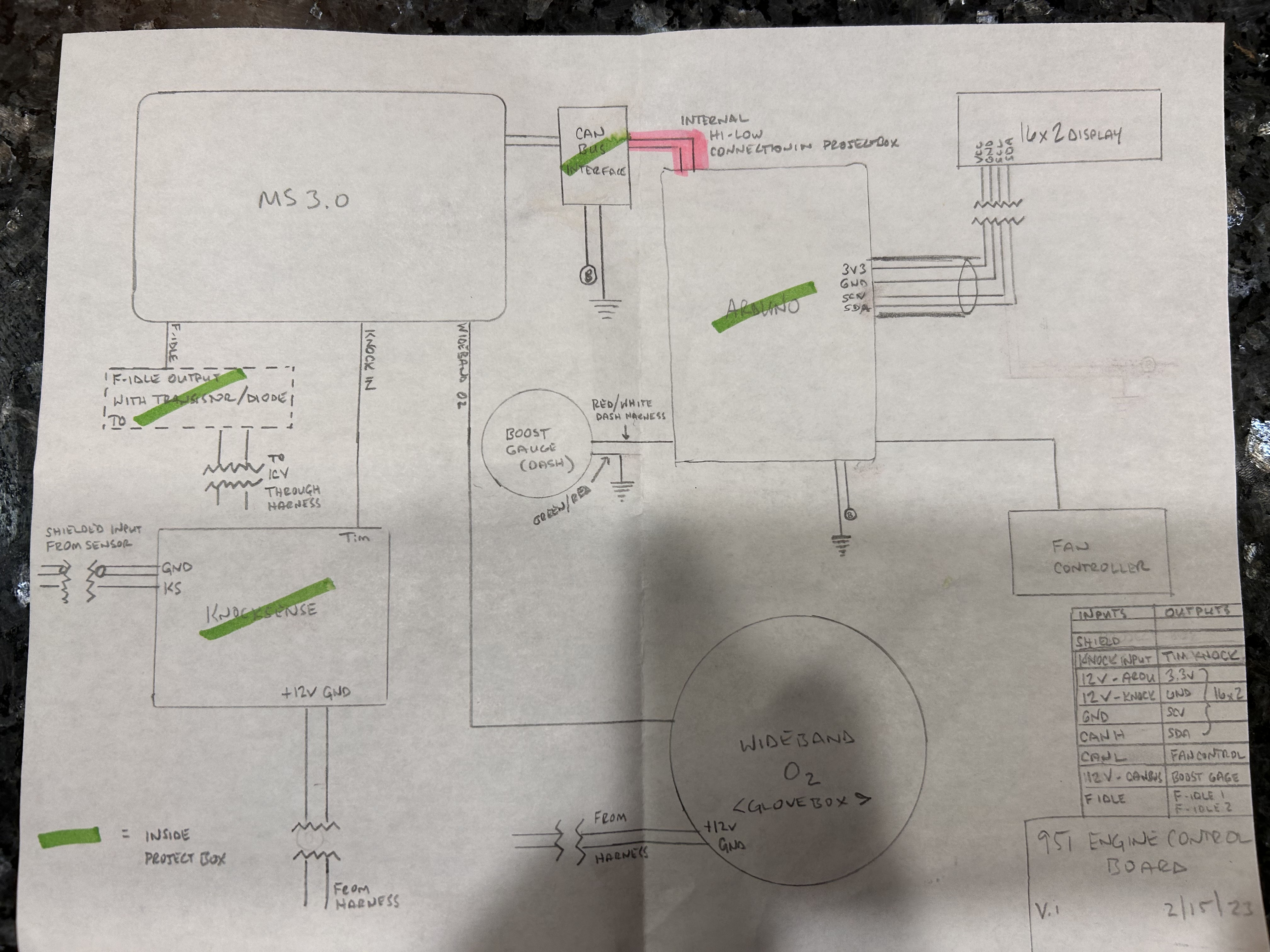

This is a drawing I made to show the electronics and connections under the dash for the arduino and other items. Everything with a green slash would be inside a project box or old DME box near the microsquirt box.

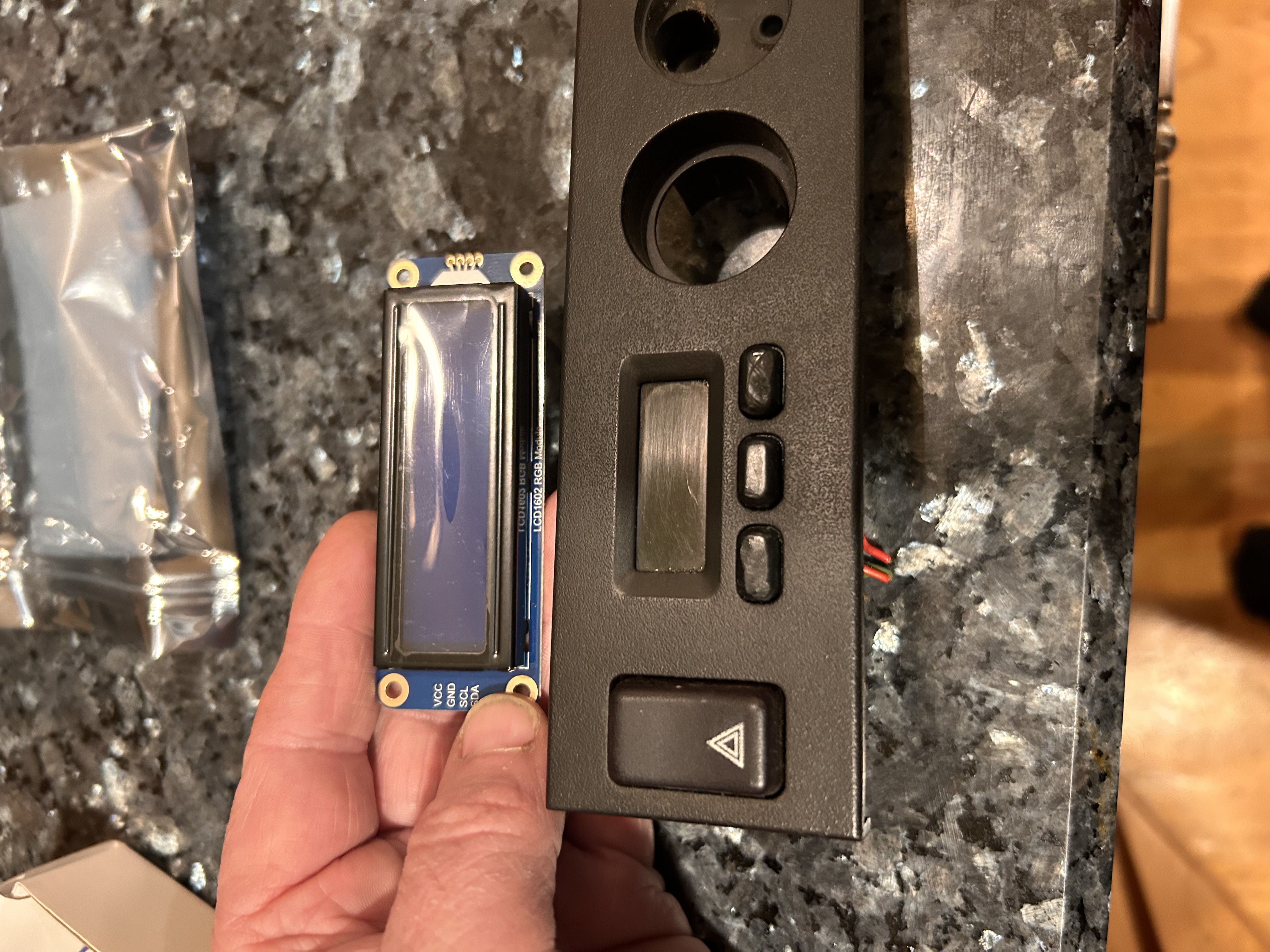

The 16x2 would fit quite nicely here.

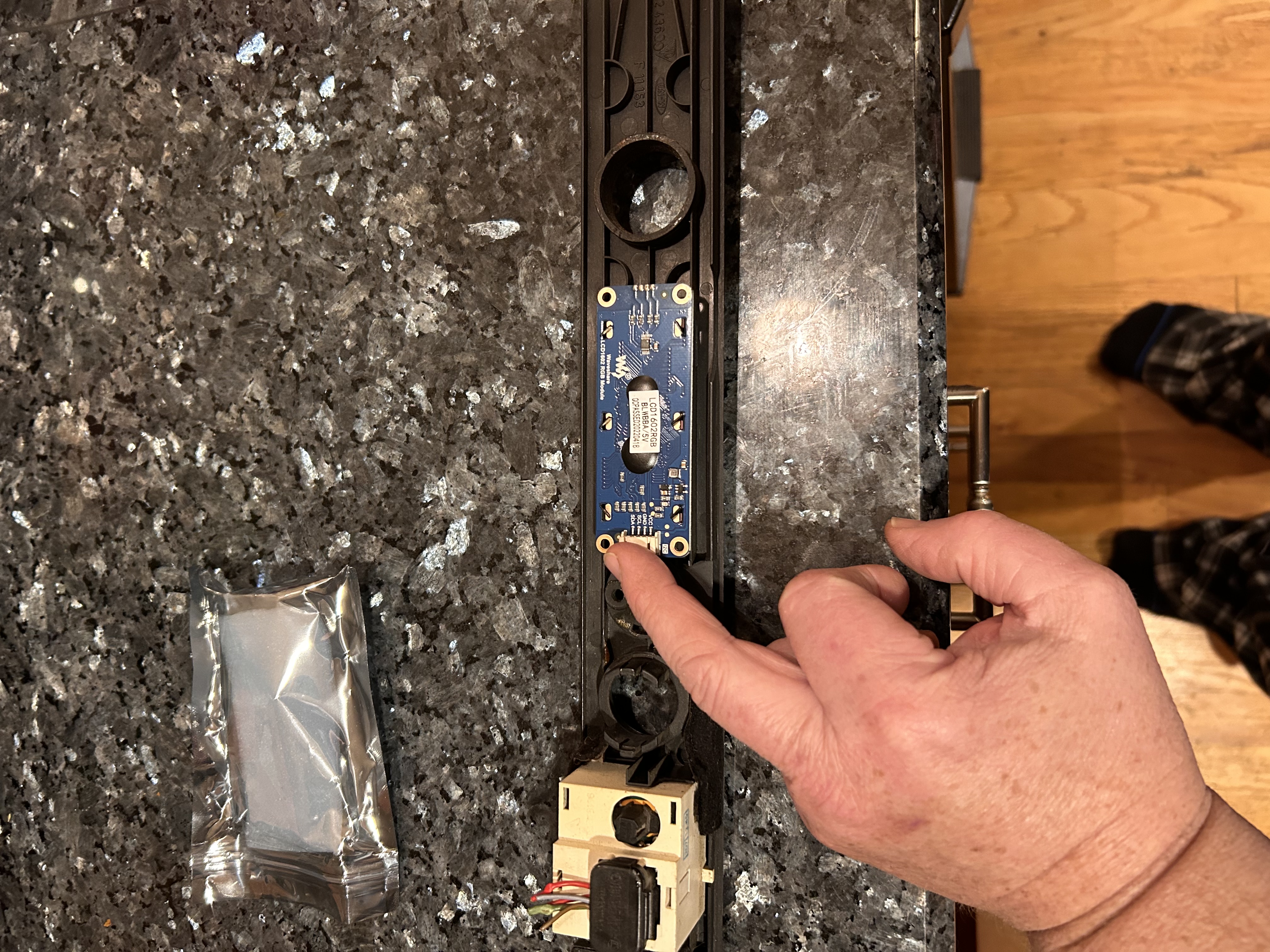

Backside of the trim strip where 16x2 could possibly go. I really hate to hack up a trim piece though…

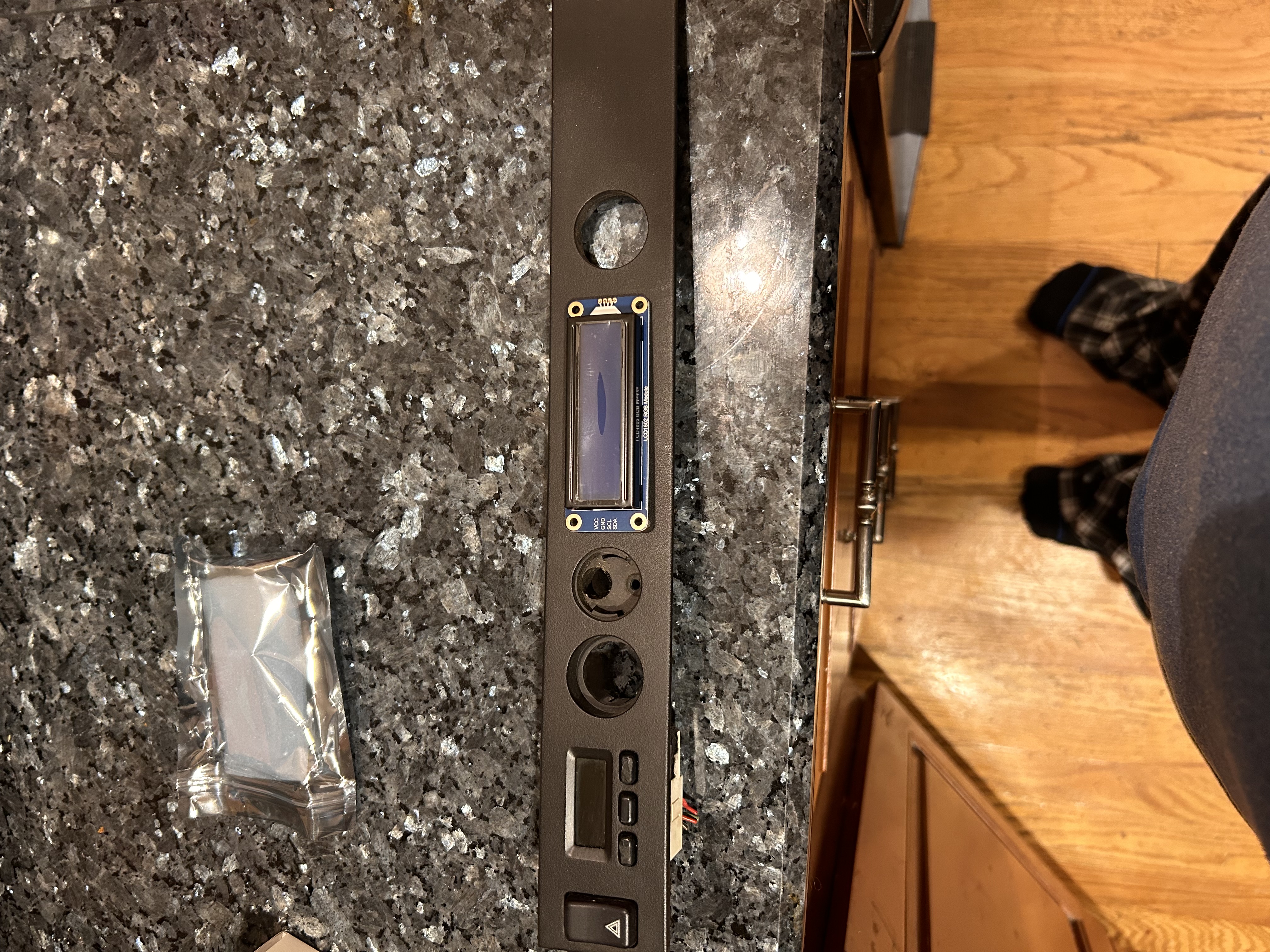

My 16x2 is obviously quite a bit larger than the clock unfortunately. Perhaps a new 3d printed trim strip with the appropriate section removed?
Another idea might be a new strip with the clock out and 16x2 in its place and the lighter and air temp grill shifted to the right. Could also lose the lighter altogether as I will put a usb charger port in one of the unused console switch blanks.
Or find somewhere on the console for the 16x2

I'd be inclined to find a smaller LCD so you can retain the stock button locations to scroll through inputs. Just my two cents.
Why not drive the boost gauge directly from the mircosquirt variable voltage output? It would work the way you have it, but you would need a loop that constantly checks the MAP signal (off the CANBUS in your case) and updates the gauge output. Not a big deal if you aren't taxing the Arduino with other tasks, but you have the hardware to drive the boost gauge without taking any processing time from the Arduino. Either way, I'd probably use a Mega Arduino since it has significantly more processing capacity.
As for the CANBUS interface, I'm sure you know, but they make Arduino CANBUS 'shields' and even custom Arduinos with the CANBUS and Arduino all on one board.

Well a couple more updates. After going back through the Microsquirt manual, it appears that the only variable voltage output is the tach signal. The other outs (e.g. the wled, aled, etc are just on-off outputs for controlling relays and the like.

Most tachometers (including the 944) run off a pulse corresponding to engine speed (like a fast EKG), so I'd be surprised if the tach output were an analog signal. If it really is, you'll need add'l hardware to run your tach.
Depending on what you are using it for, you can always use separate Arduinos for resource-hogging functions. The Arduino Nano is tiny and cheap. Chances are whatever LCD you use will effectively have its own Arduino built into it to drive the display....
