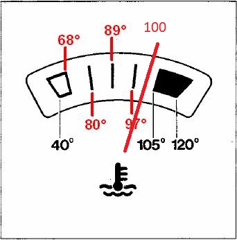

Hi Dan,
My understanding is that the difference between 10W50 and 10W40 isn't terribly significant and the latter might just prove to be a better fit for your car:
The 10W40 and 10W50 have similar viscosity at 0ºC but at 100ºC (operating temperature ) the 10W40 will have 96% of the 10W50 range -- 167 versus 160. It's also plenty for a low HP car like ours.
While I wish the temp gauge was similar to modern cars (pegged is pegged) I have to remind myself that what appears to be a hot running engine is an illusion and it really isn't. I have typically used a 15W40 or 15W50 as a result but must admit that I don't use my car year-round.
Photo is from Clark's Garage.

Temp gauge on my later car is different.. more like modern car.. except doesn't stay rock steady in one spot all the time.
When cooling system is all good, though it goes no more than half way, it often fluctuates between 1/4 and 1/2
