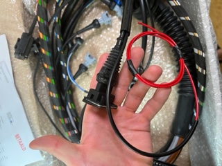

Christmas came early! I had them add a 12v power source by the AFM connector, to power my MAF sensor (pictured).
