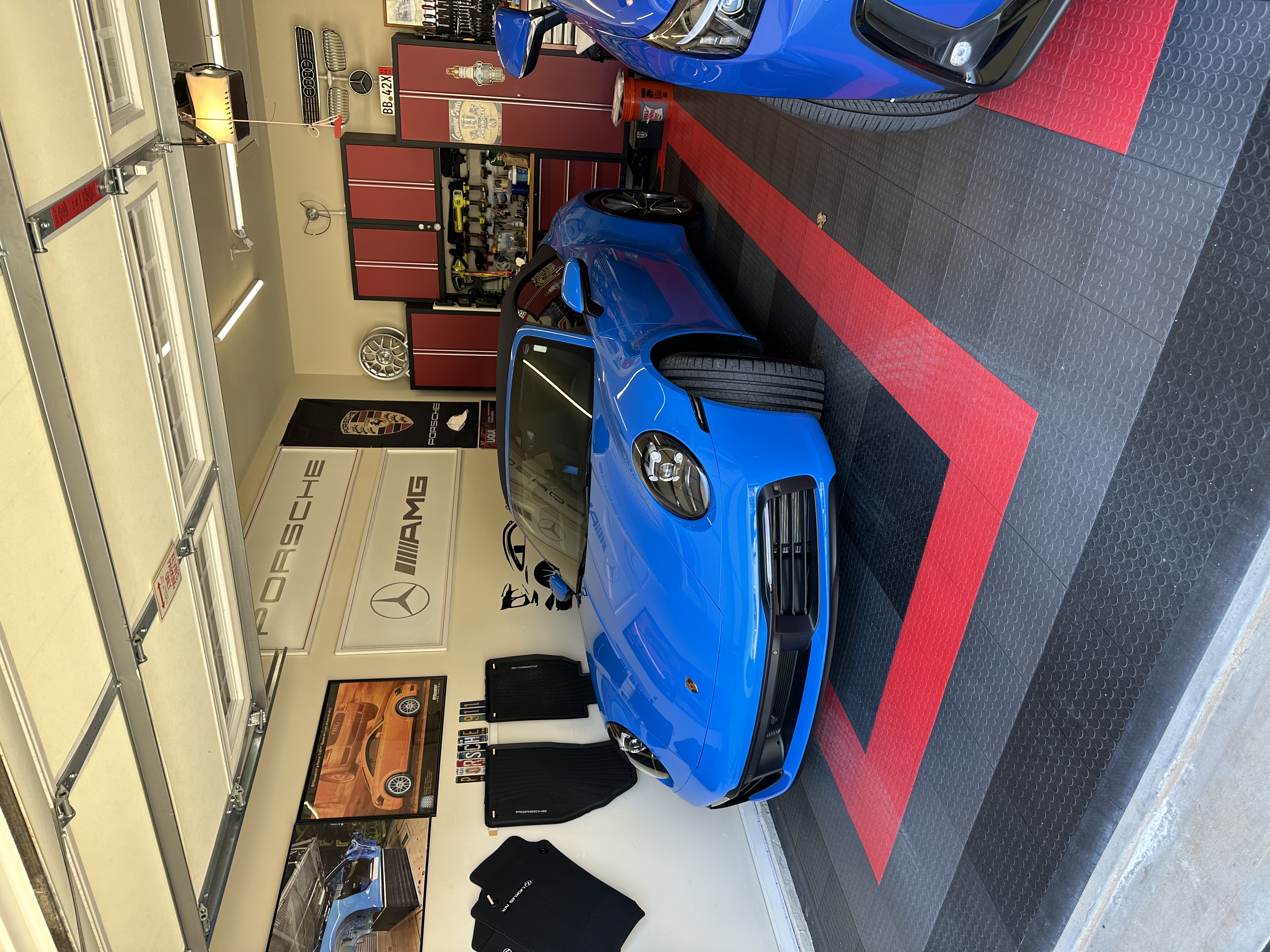

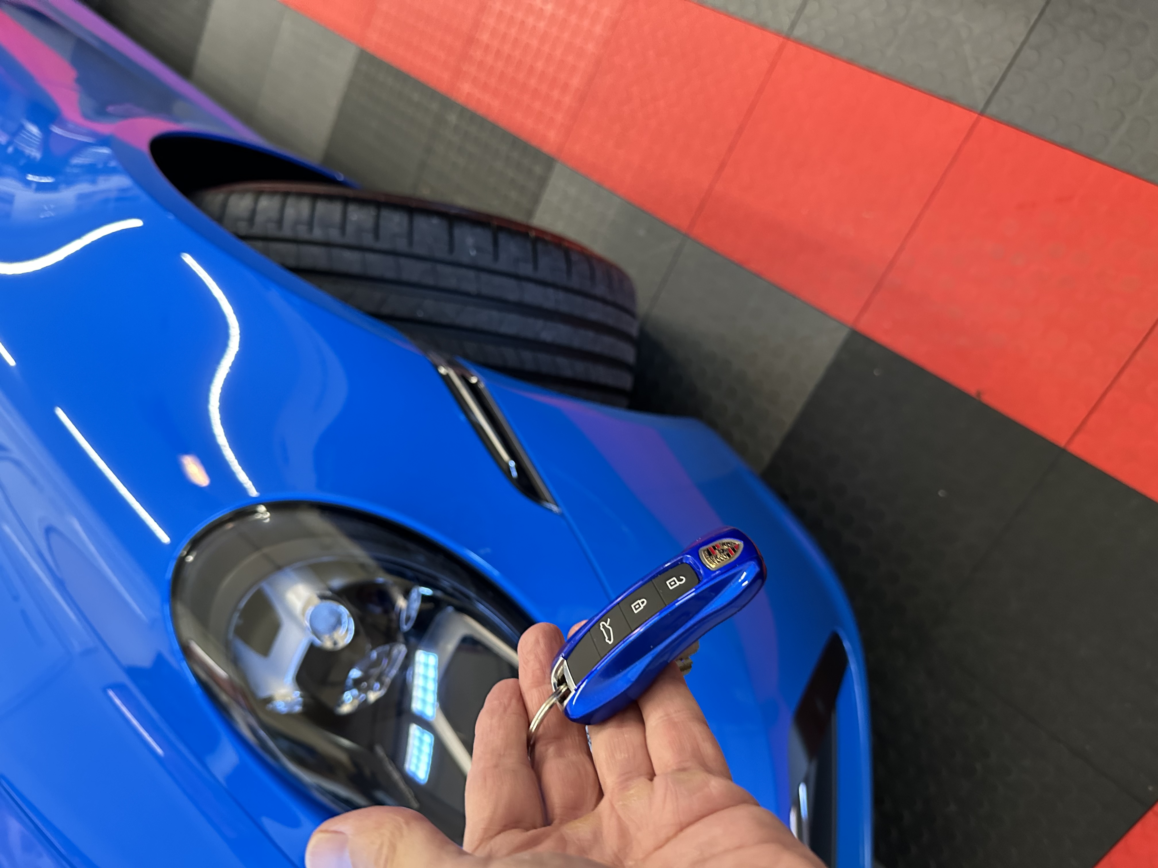

I changed the orange side markers out yesterday as soon as I got the new car home.
I had purchased a set new for a good price from an owner who never installed them and no longer wanted them.
Also added the blue key fob cover in the shot.
The bottom picture also shows one of the production line pics I had enlarged and framed - top left on garage wall.

Cool picture on wall. Was it as easy as everyone says to change the markers?

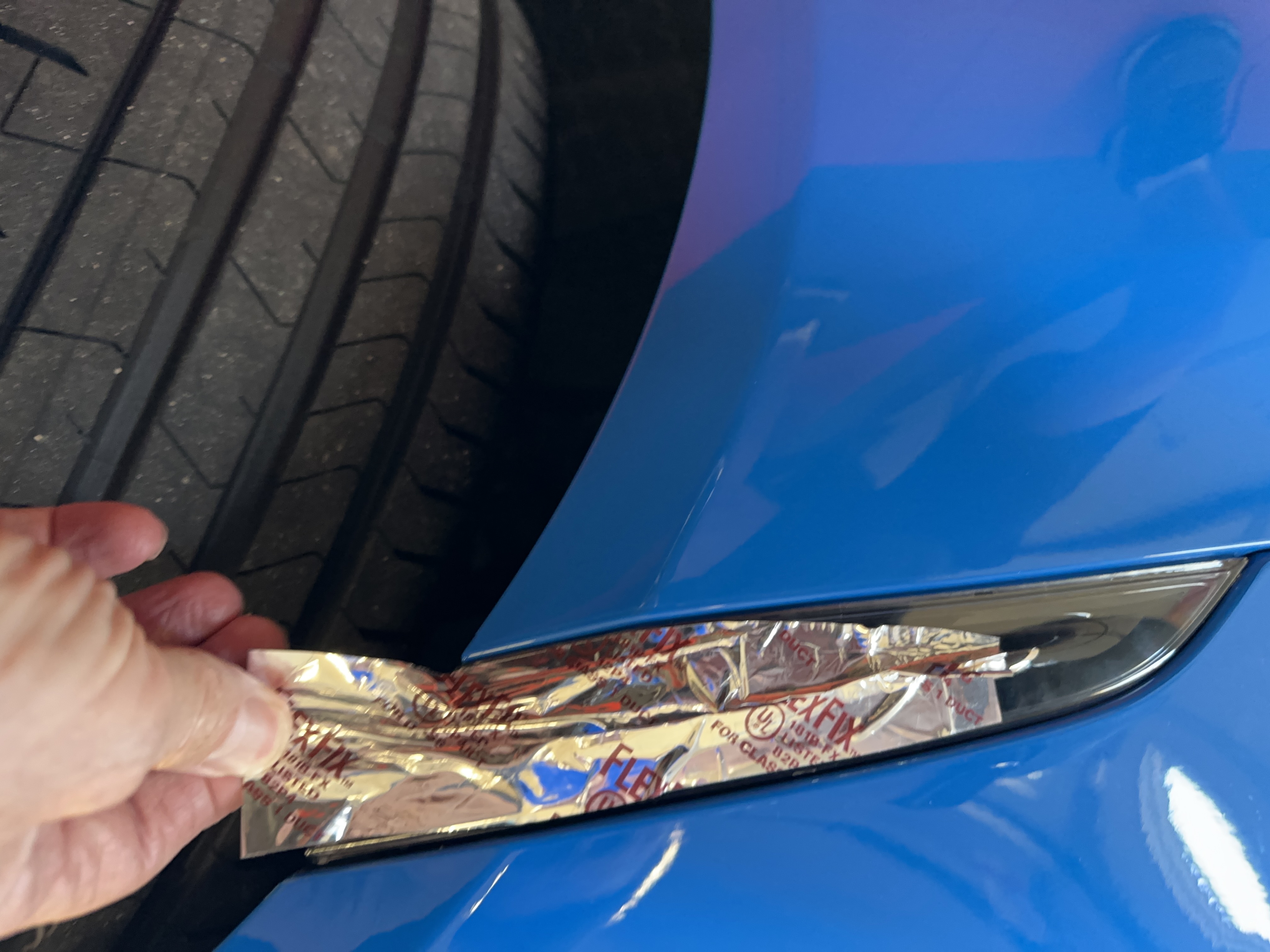

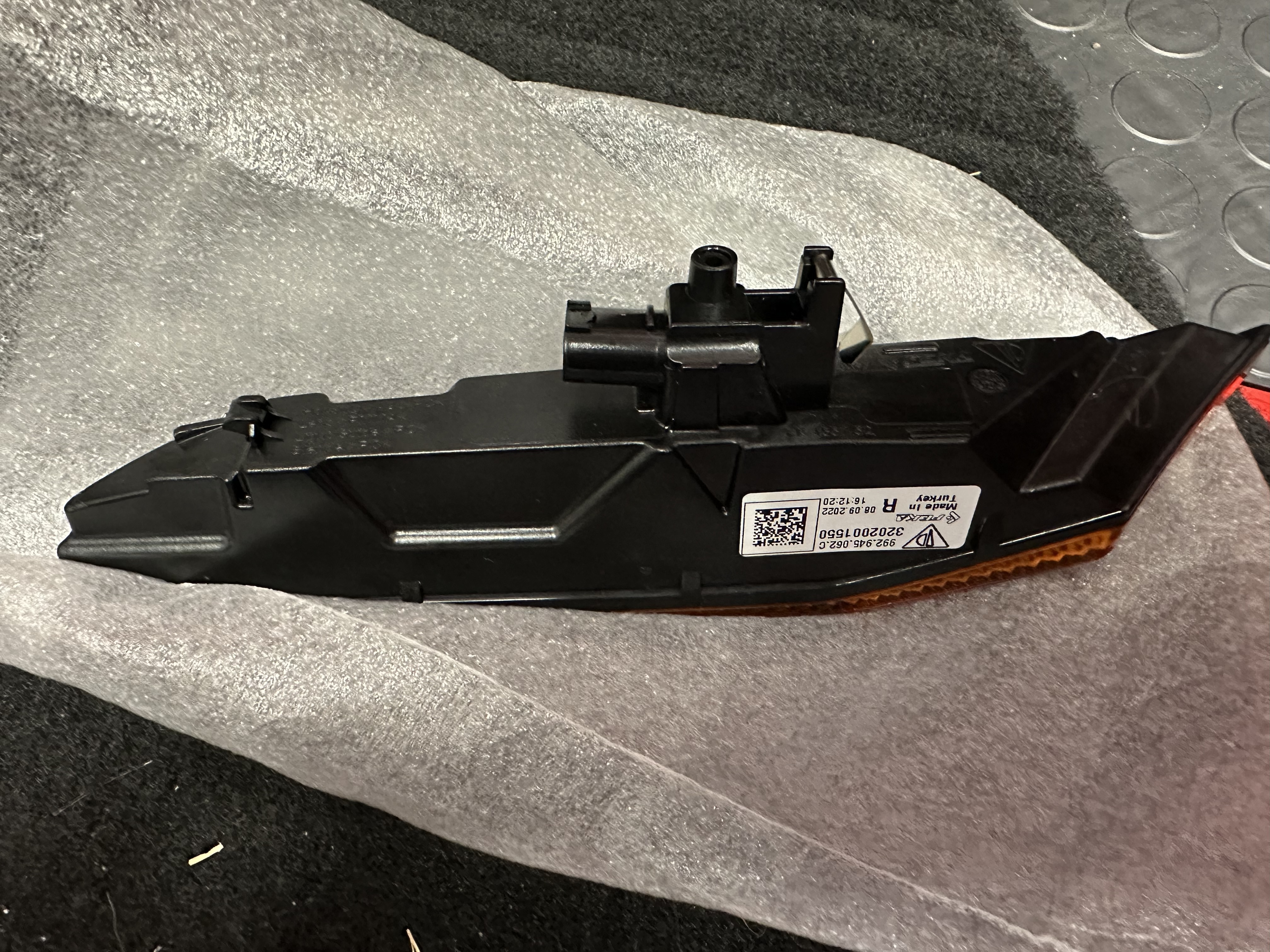

It’s easy but there’s a technique.
I applied some metallic duct tape (strong adhesion) and pull toward the back of the car.
This compresses a spring and the front of the lens pops out. You can see the spring in the second pic.

Look’s much better, I’m guessing you like blue cars 😂
