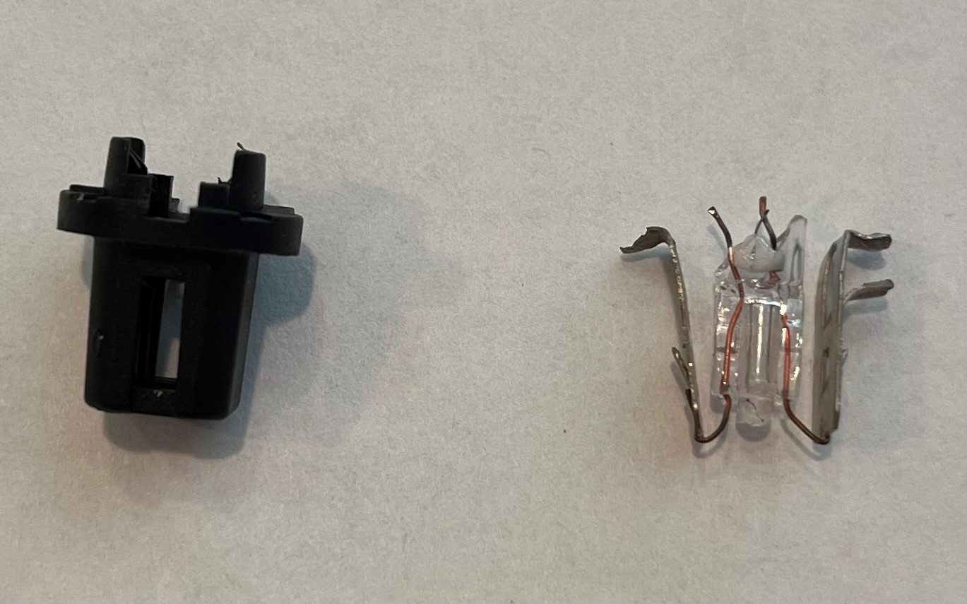

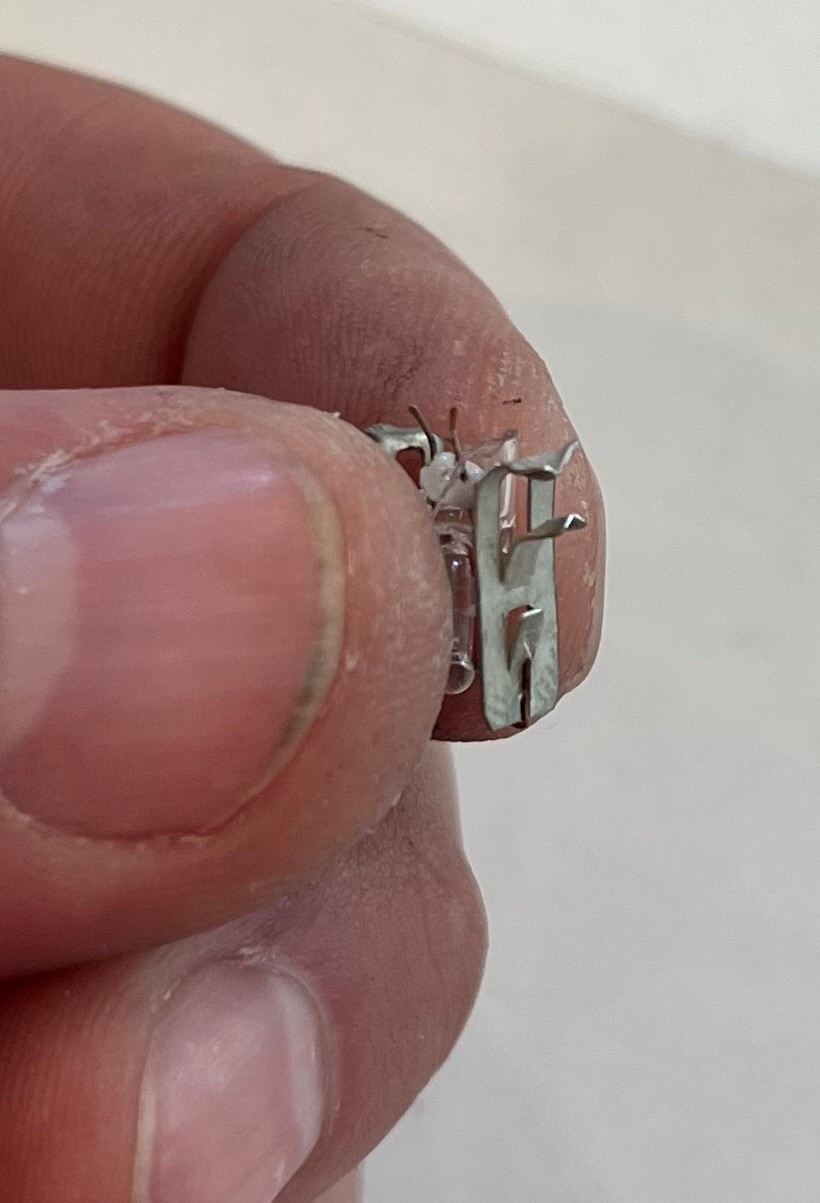

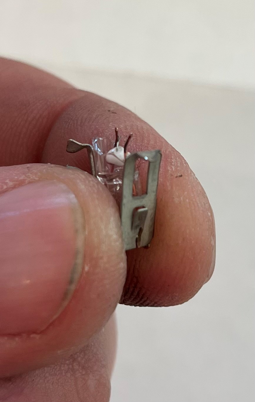

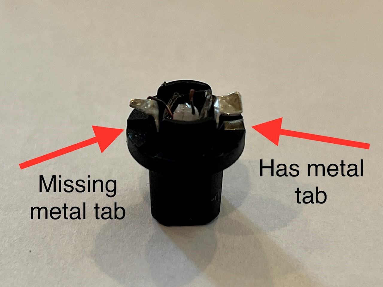

Tom, thanks for diving into the schematic. I did end up sorting this out. I pulled a bulb out of one of the lesser needed dash lights (I think it was an up arrow - assuming this is a light that tells the driver to shift up into a higher gear possibly?) and put that into the high beam indicator spot and now the dash shows me when the high beam lights are on.
So here's what ended up being the problem:
(In my attempt to get the bulb out of the little housing thing I ended up breaking the bulb and then discovering that it is not a socket/replaceable bulb - I'd need to buy the bulb/housing all together)
Anyway, as I was inspecting the housing, I noticed that there are supposed to be two metal wiper tabs (one on each side) that make contact with the gauge cluster pcb board when you twist the bulb housing in. Mine only had a metal tab on one side of that bulb holder. So even though I was testing ohms across the two metal ears that hold the bulb housing to the cluster board, the contact was not being made when it was installed because of that missing metal tab.
I've never seen that little up arrow come on while driving (it did used to illuminate when you would turn the car on, but that was the only time I ever remember seeing it come on). So I'm not too worried about no longer having that indicator.

Glad you found it and great pictures of the issue! I knew I was geeking out too much on the schematics.
