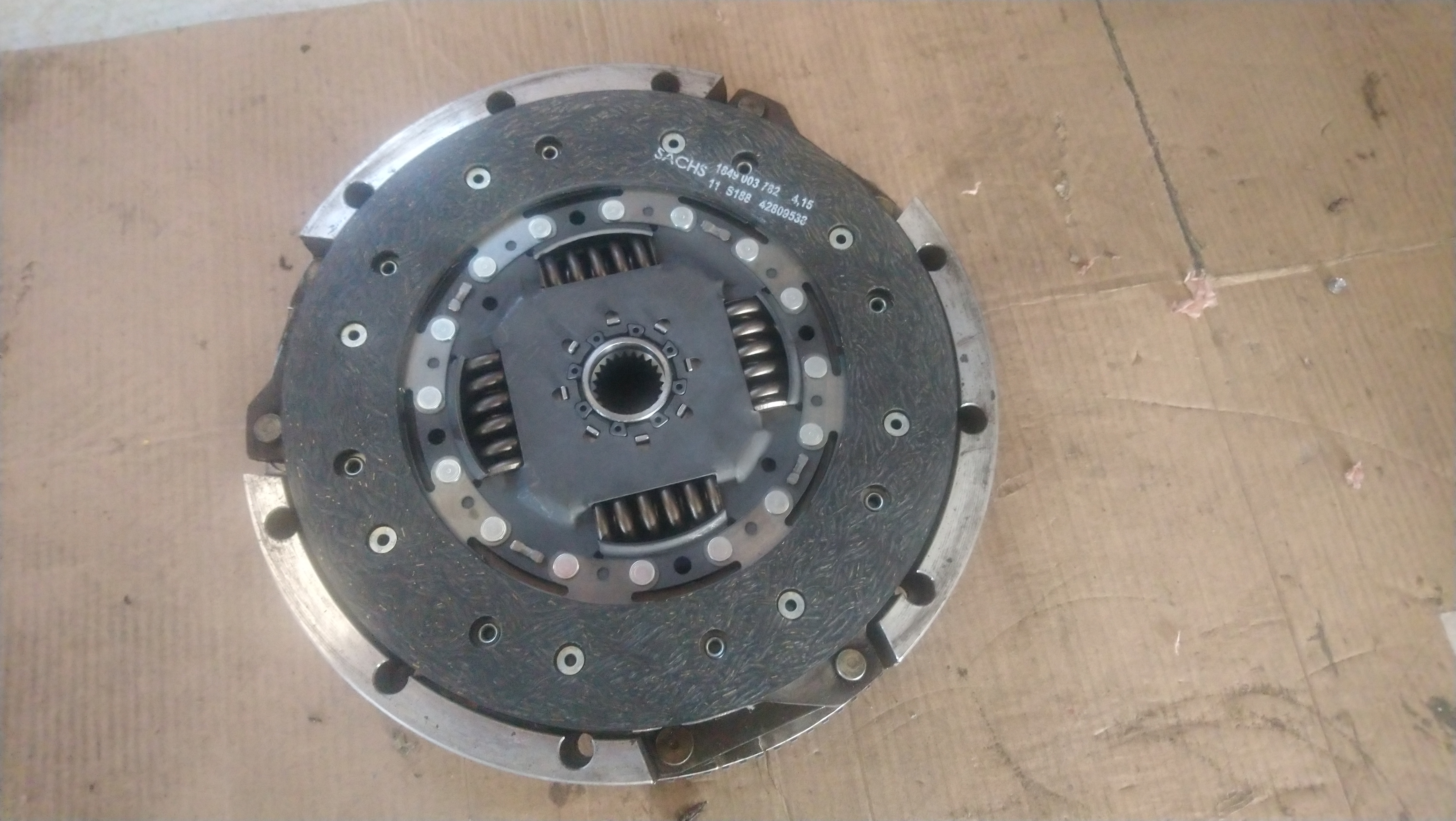

I never had any issue with the KEP 2 PP and the 930 disc. I will drive the car tomorrow and see if there is any difference, but it disengaged as we checked before fitting back the gearbox.
There is no rubber in the new clutch disc, which I believe is the replacement for the original rubber center disc which is NLA.

Here is the engine side of the new disc, placed in the PP. I could not spot any rubber in there. The square-ish part is in steel.
I reinforced the firewall with a home-made steel sheet. The pedal was stiff when new but OK-stiff now.
Now I know that PET is not always correct but if you look at the 930 section you will see that early 930s had the 6 spring disc and later ones had apparently a rubber centered disc just like 944s. Now that these rubber centered discs are obsolete and the designs have been updated to spring centered discs, perhaps the rubber mention has remained in several nomenclatures?
