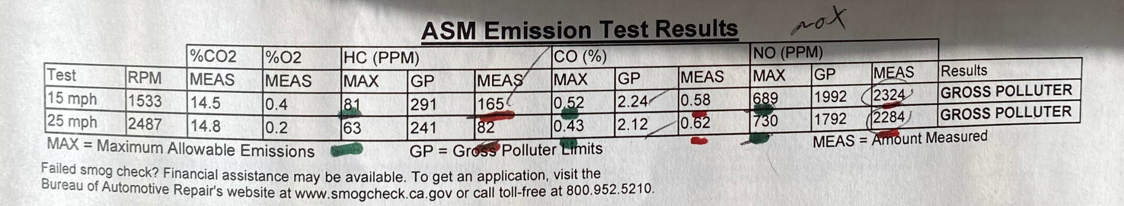

Hi everybody,
I just failed smog yesterday on my 1987 944 Turbo—just a couple of days after purchasing the car I’ve been hoping to get for a very long time. I’m new to the 944 world and was hoping to get some advice from those of you who may have already tackled these issues.
The engine was rebuilt 16k miles ago, so I’m hoping there aren't any vacuum leaks on the engine itself, but you never know. It has a fairly new 3" exhaust with a Lindsey Racing high-flow, CARB EO-approved catalytic converter. The smog technician mentioned there might be an exhaust leak.
I probably made a rookie mistake by not getting the cat fully warmed up—I only drove the car for about 5 minutes and then let it idle for 5 to 10 minutes right before the test.
Anyway, is anyone able to point me in the right direction based on the test results below?
I'm based out of Ventura, CA.
Thanks for all your insights!
Michal
