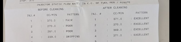

For some additional background, I had my injectors cleaned and flow-tested before the car sat. It ran great afterward, but then it sat for about 11 months. When I finally started it again, it felt like it wasn't firing on all cylinders. After checking everything over, I noticed it was running extremely lean (16-18 AFR). I pulled the injectors, had them checked and found they had all gone bad. Once I had them refurbished and reinstalled, the AFR came back to where it should be (around 14.7). The car still has a slightly rough idle, and the AFR oscillates between about 14.7 and 15.1 at idle, but it averages right around 14.7 while cruising.
951 injectors_take two.png (76.1 KiB) Viewed 15 times
Based on the new information about the gas, I'm beginning to think my old fuel mixture is the remaining culprit, and it may very well be the same issue you're dealing with. The more I read through the GPT information, the more they seem to line up with what I'm seeing. In fact, every case describing the effects of old fuel closely matches the symptoms my car has been exhibiting, from the rough idle and fluctuating AFRs to the way it runs fine once cruising. At this point, old fuel seems like the most logical explanation.
