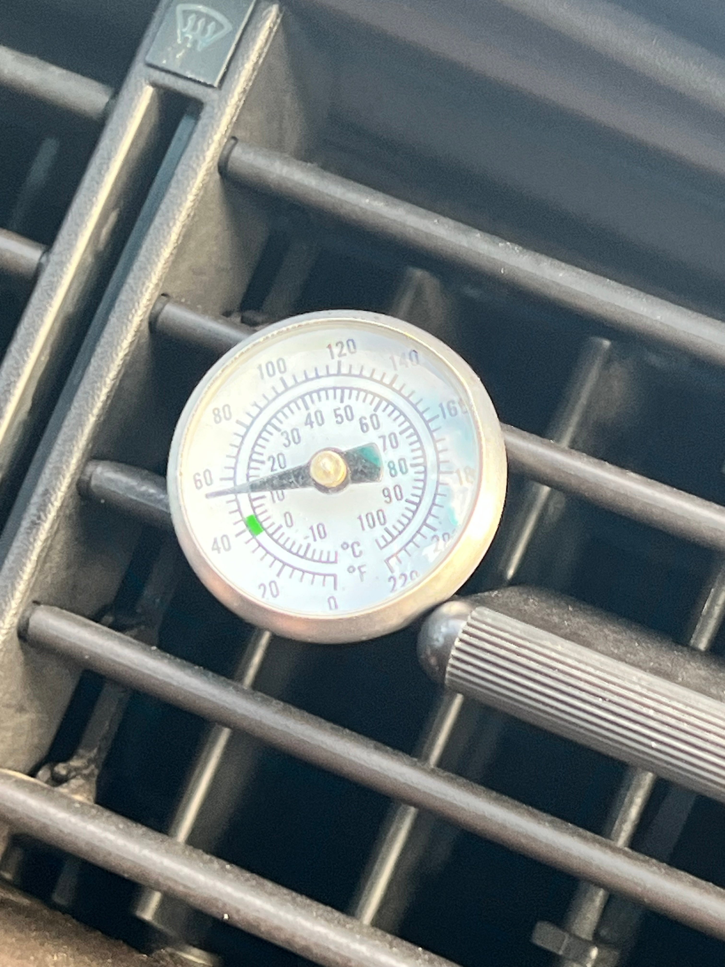

Replaced all four o-rings, did all the good stuff to get the system as it should and she is cooling ok. It was 91F outside when I took this picture.
Thank you all for your help.

shft22 wrote: Mon Jun 29, 2026 11:10 am Replaced all four o-rings, did all the good stuff to get the system as it should and she is cooling ok. It was 91F outside when I took this picture.
Good work! Glad it was that simple!
If you are the type to fixate on things for no practical reason, know that you could get it another 15-20 degrees colder still. :shifty:

This first round was to be sure the system is working and not leaking. I am trying to get the car to a some what comfortable driving stage to enjoy it and at the same time see what else comes up.
