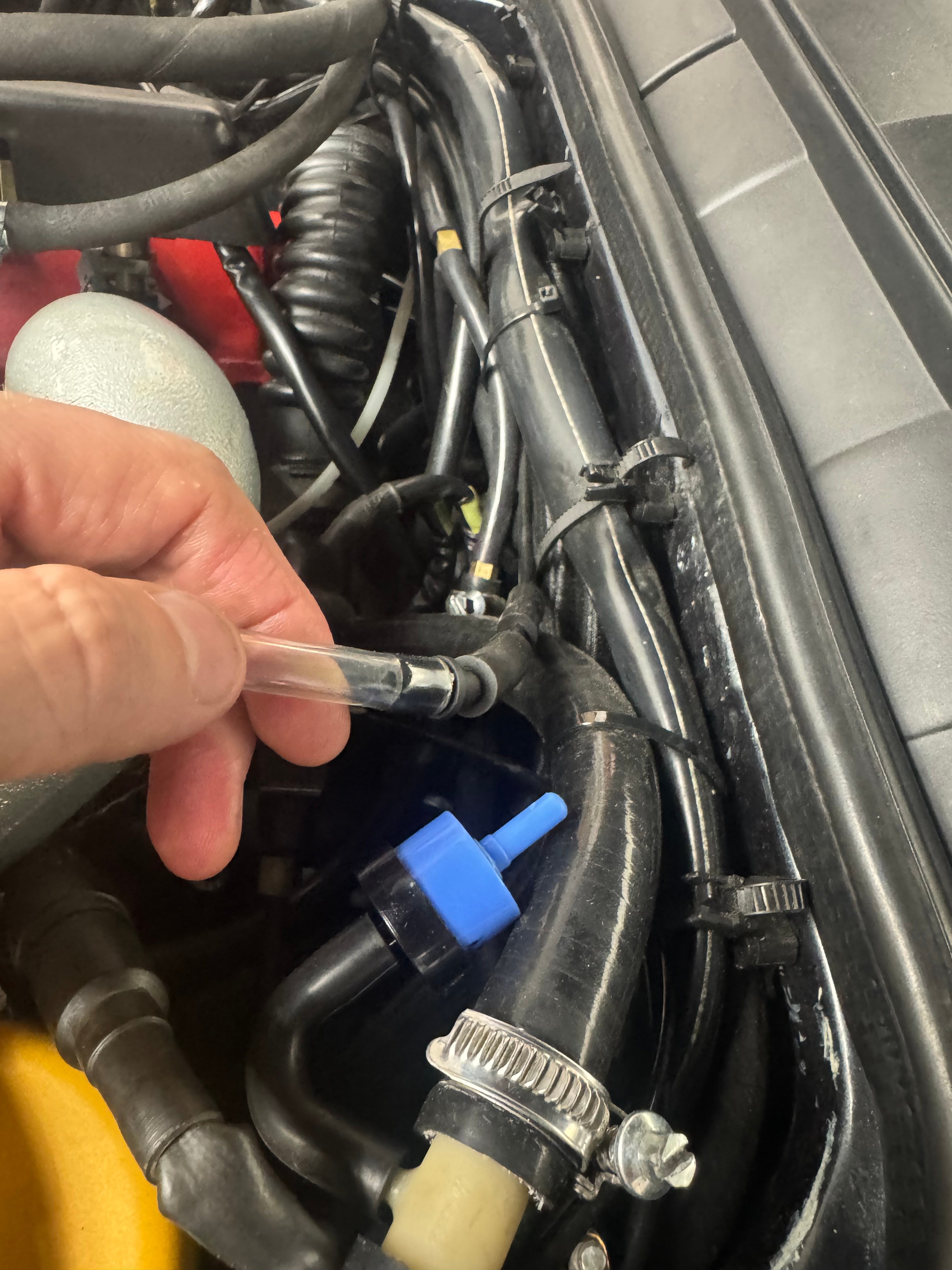

Can you post a pic of the line you tested?

Tom wrote: Sun Jun 28, 2026 12:51 pm
Here you go:

As a quick test, you can just plug those lines to see if vacuum improves at idle. I doubt it is big enough to drop the vacuum to 15 by itself, but every little leak adds up and is worth fixing. :angel: If your heater generally turns on an off as designed, your leak is likely in the vacuum canister over by the battery (rather than the hvac plumbing that t's off that line). Very common for the nipple to snap off or the canister to develop cracks/leaks. I'm starting to wonder if your issues may have been a thousand little cuts rather than one big 'aha' thing?
