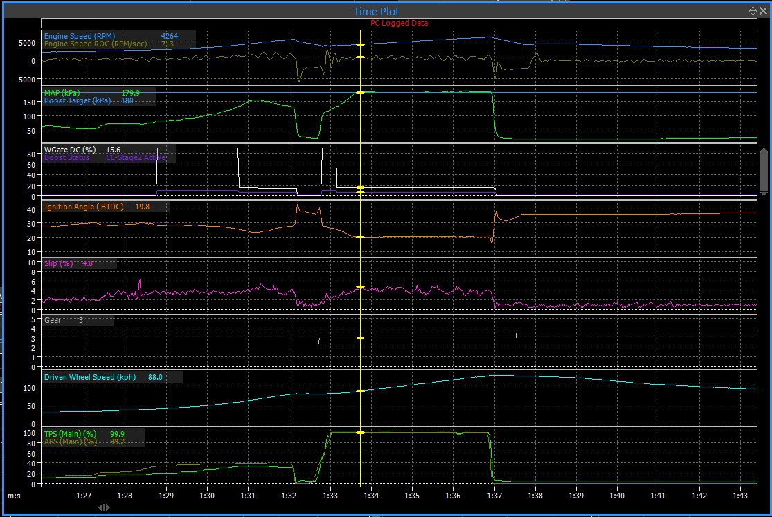

We went for a drive today and I had the knock headphones on for the first time, I really couldnt hear anything unusual with those and you can hear the valve train really clearly. Might try to record that through the laptop one day but I need to keep an eye on it until I get the Knock control property setup.
We tuned in the base Waste Duty cycle for 0.8bar but we started to get some light rain just as we got it dialed in, wheel spin started to become an issue so we had to stop.
80-100 in spot on 2s with 4 to 5% slip between the driven/non driven wheels :lol: :lol: :lol: Road was slightly uphill too
