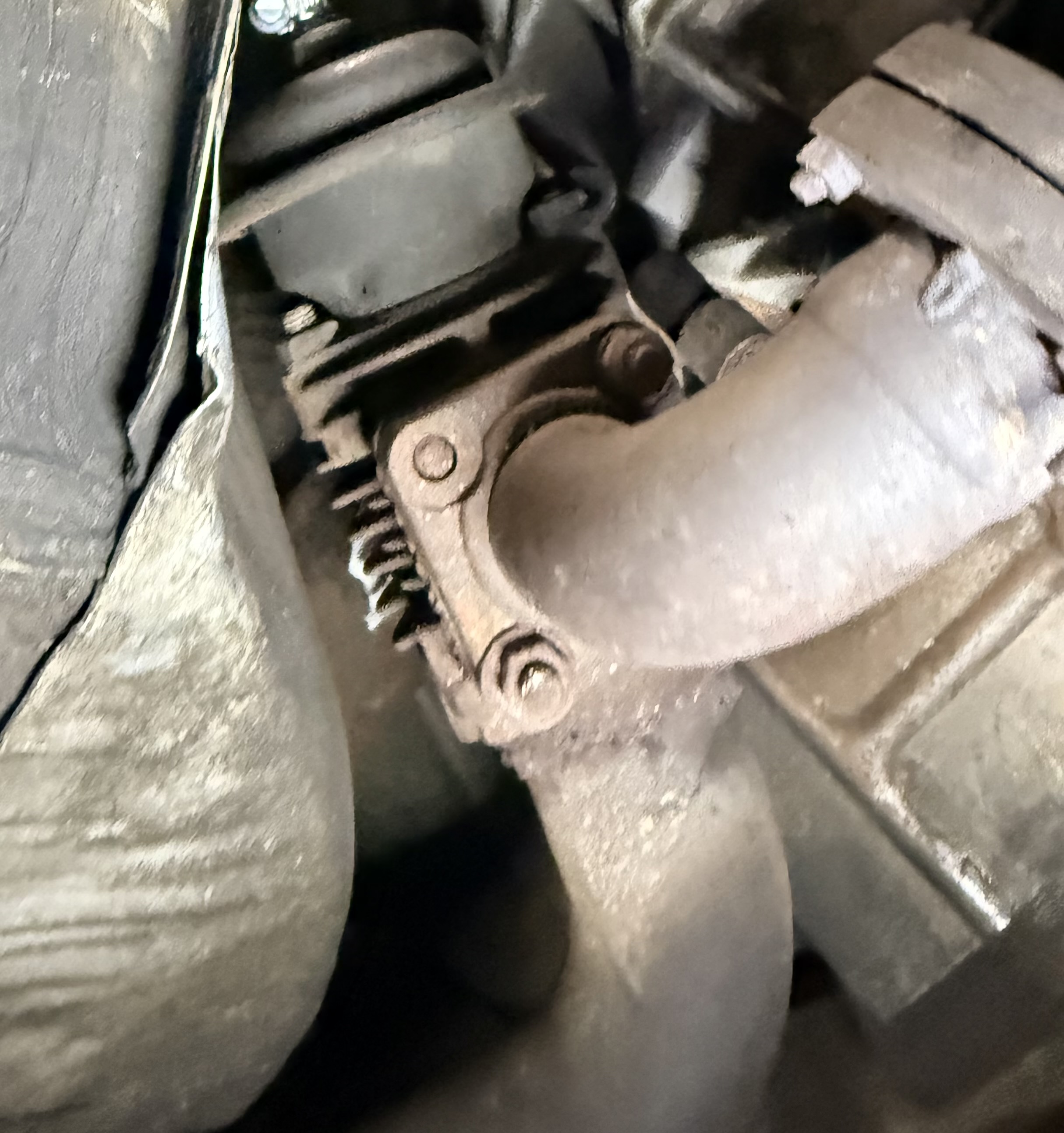

You mentioned a broken stud at the wastegate. If true then you most likely have a leak there. Would actually be surprised if you didn’t. I would start there.
Is the wastegate original, it might need new springs. You have to make sure you have a healthy wastegate. A tired one would definitely result in lazy boost.

Thank you all. Yes @944m3 I did use new crush washers on the turbo connections. The cat is original but the muffler is a new one. The one that was on it when I bought it was practically dragging so I had to get a cheap Ansa for now.. Pretty sure the wastegate is also original. Attached a pic of the broken stud.
I think I’m headed towards a new wastegate and some exhaust bits and pieces. Does anyone run the Tial F38? I found one locally used in good shape for a deal and thinking about grabbing it. Any other recs? I know I would need an adapter for the Tial. How is the install? Also any recommendations on exhaust? I think I’d like to keep a cat so a high flow prob. I’ve had a look at Lindsey’s systems.

The Tial is an awesome wastegate. There's a lot to read about it on the other forums. Install was one of the easier jobs I've done on the car and went pretty smoothly. For removal, I utilized the instructions that Lindsey Racing provides to support the installation of their wastegate system. Expect to snap every piece of exhaust hardware, so just stock up on new bolts and nuts beforehand. I bought the adapters and the wastegate as a package, but if you can get a deal on the wastegate then I'd go for that. You can run it single port, like the stock system, or dual port. I would recommend going single port at first and upgrade to dual port once you know all is well with the installation. Ask the seller which strength spring is inside, or you can take it apart and look. I think they are color coded.
