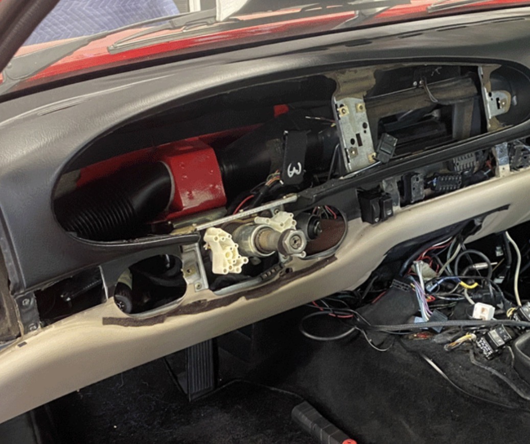

By lower trim I meant the plastic inserts surrounding the column/ignition, like this pic from our dash removal guide. A dremel with cut-off wheel or die grinder might give you a better angle at the shear-bolts?

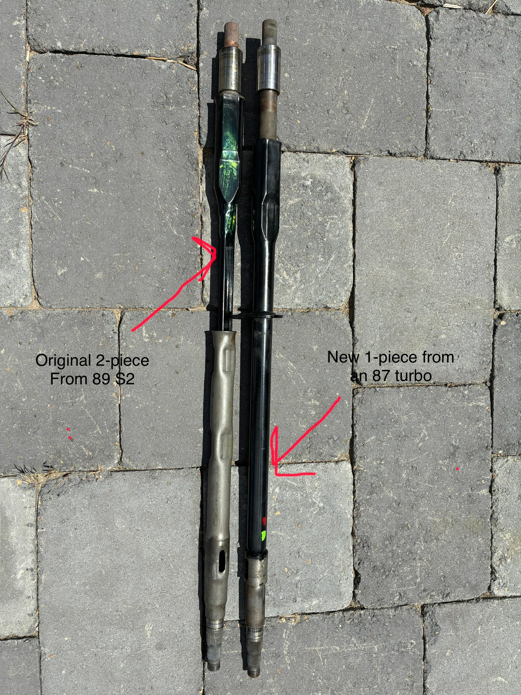

I want to replace it because the column I have is a 2-piece and that is the source of my “clunk” when turning the steering.
The steering column part number that shows on the PET is 94434701904 which appears to be a 1-piece column. However, When my car was build a different variant of the steering column was installed and it’s a 2-piece column.I am getting a clunk noise in my steering column where the 2 sections of the column mate and can slide in-and-out as needed. Anyhow, I think it’s worn out and time to replace it with the 1-piece steering column.
The car has never been wrecked, nor has the column ever been replaced. I think Porsche only had this variant of my steering column available at the time my car was assembled.
Attached are pictures:

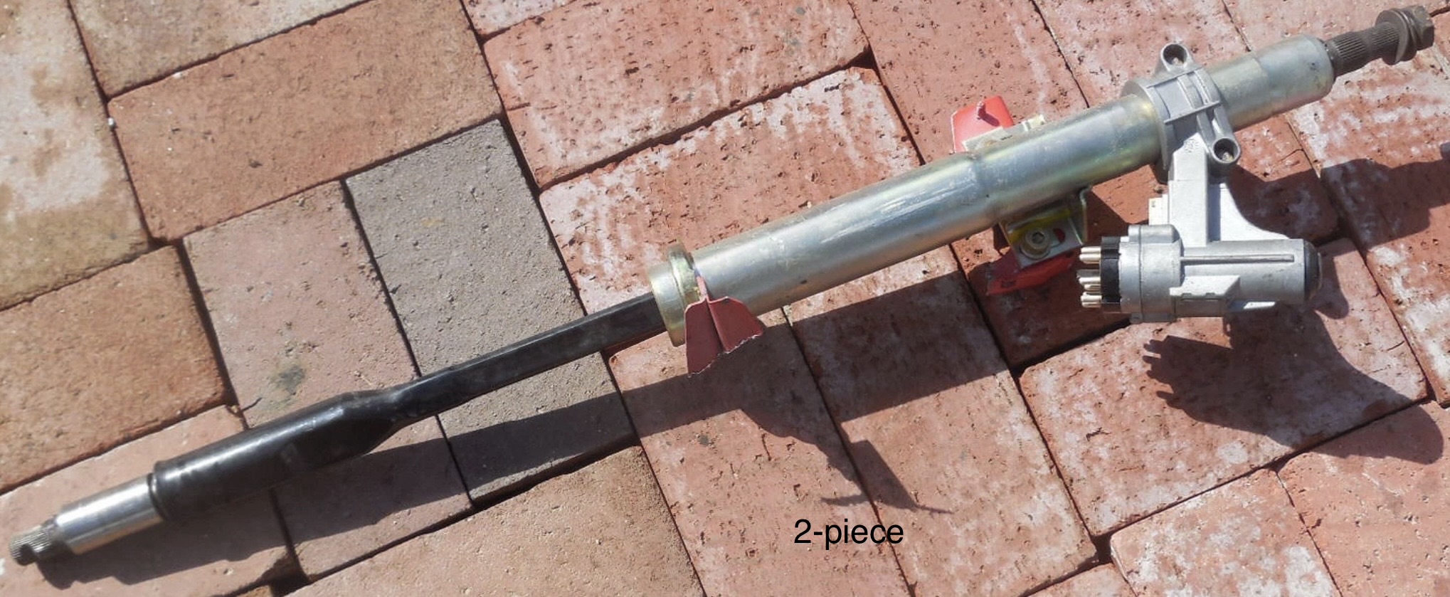

The first picture show my current steering shaft which is a 2-piece that connects together inside of the steering tube, although you can’t see it.

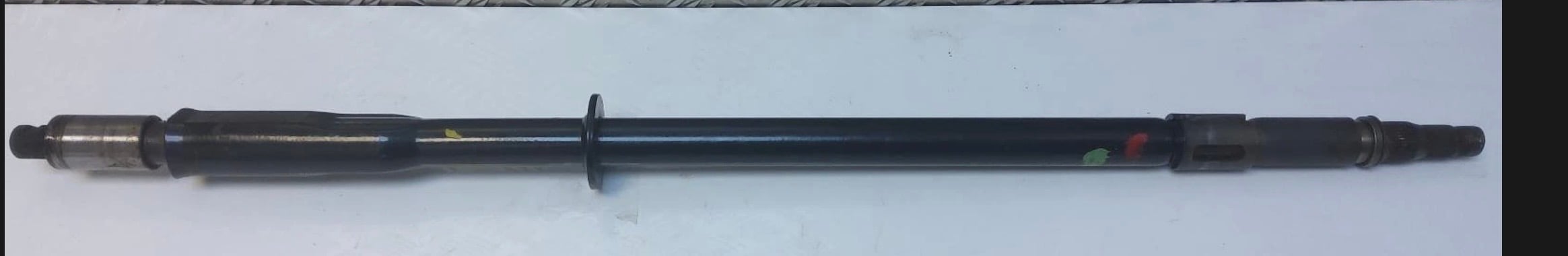

The second picture is the column with the part # 94434701904 that should be in the car and it’s a 1-piece.

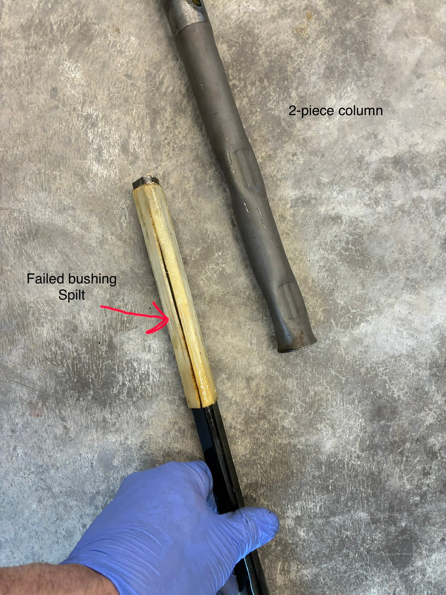

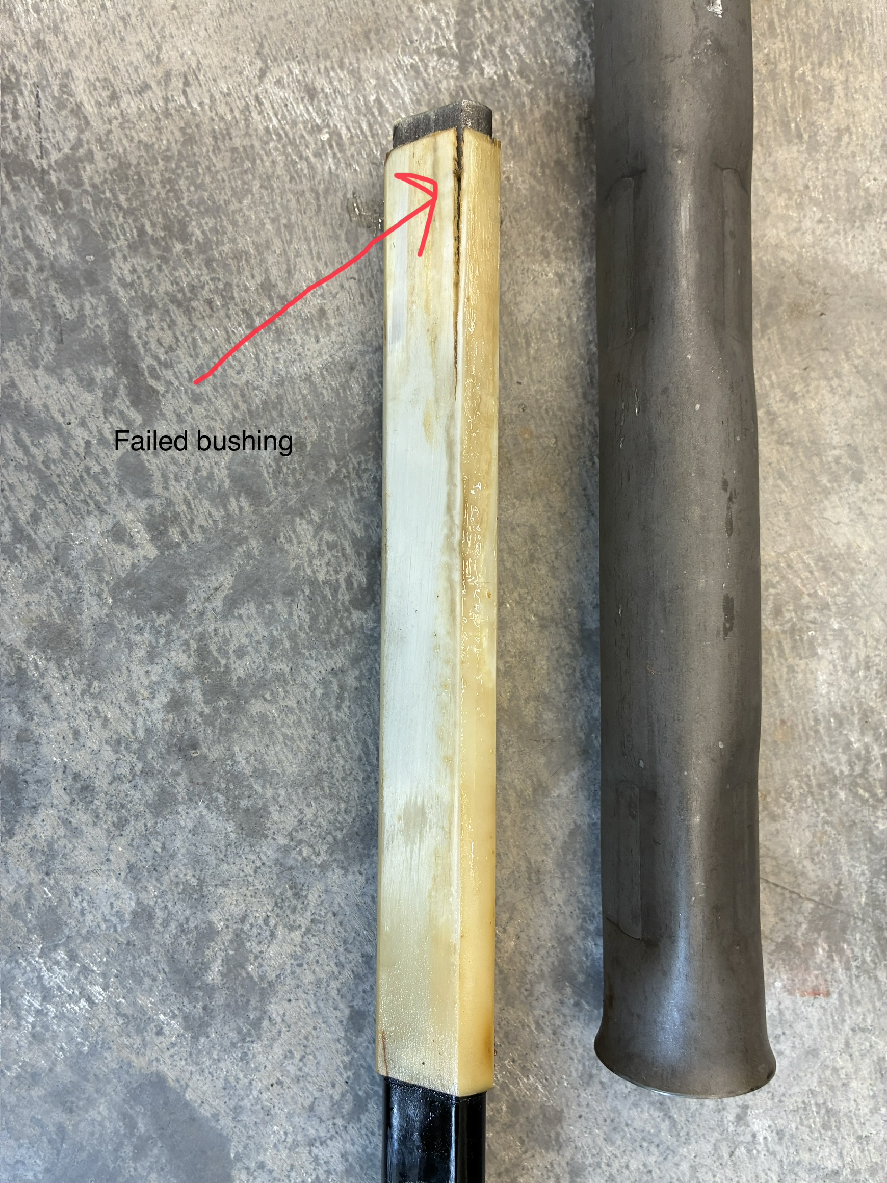

I writing to report that I was successfully able to change out the steering column without removing the dash. So, it can done. Attached are pictures showing my failed 2-piece column. Replacing the 2-piece column with a 1-piece resolved all my issues with play in the steering and clunking noise when turning….What a major PITA though.
