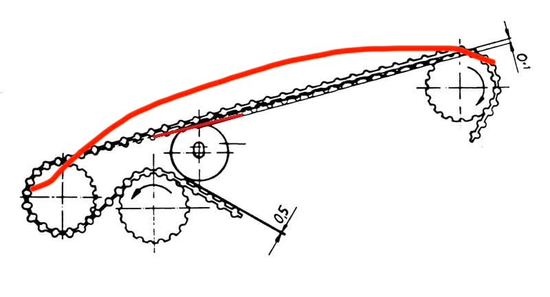

The balance shaft belt tension is not super critical. Over tighten it will wear the balance shaft bearings in the long run as well as making the classic (and annoying) belt wine. When running you can see the belt ‘bounce’ a little during rpm changes – that’s why Porsche used a roller to stop too much bounce.
It would have to be seriously loose to jump a tooth.
