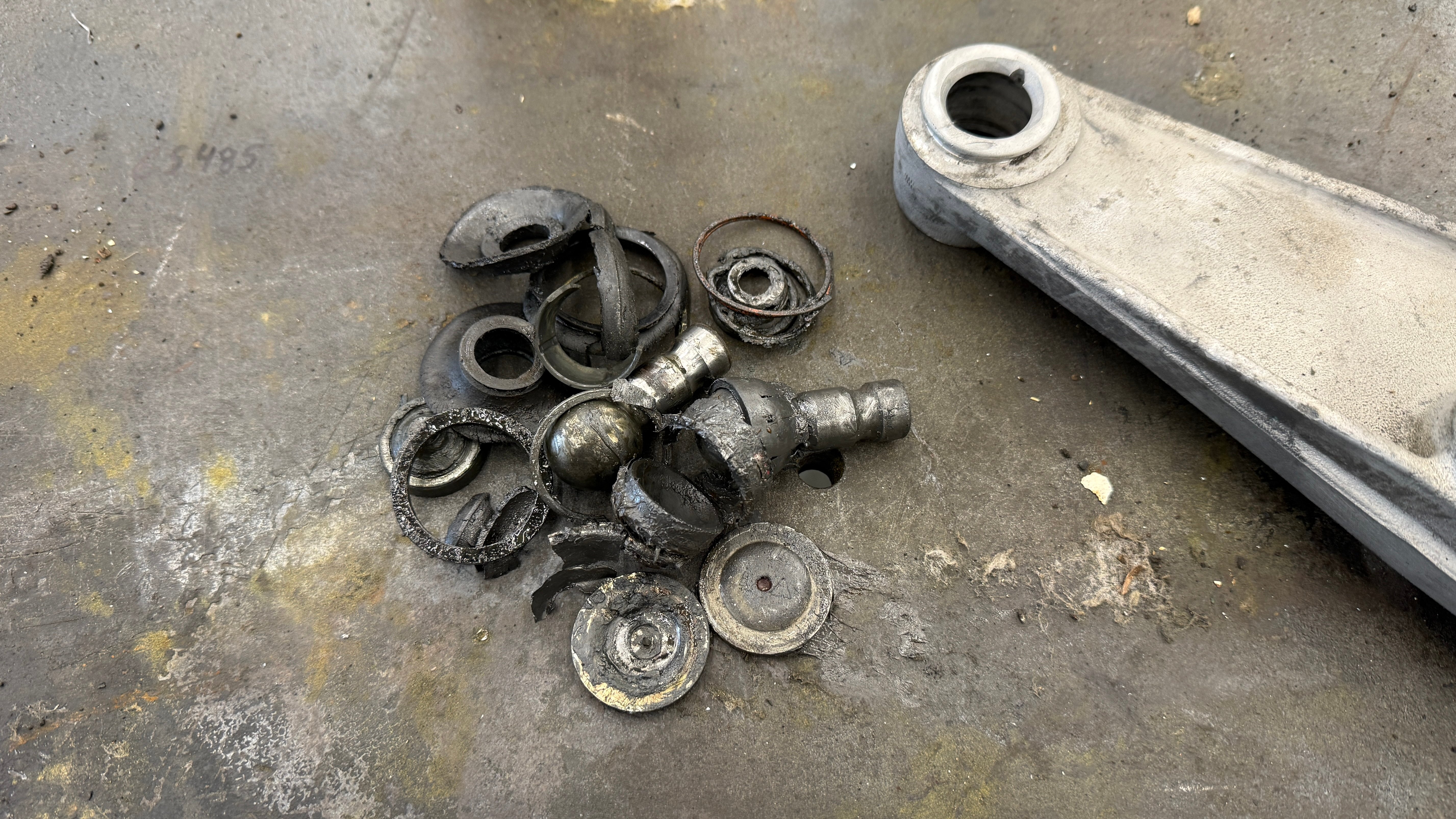

@danmartinic dang, that's not great longevity. What brand was the tie-rod?
I put Prekom on mine, along with Elephant Racing stuff for the wishbones (which I suspect are also mostly Prekom). None had a country-of-origin, but I think all their stuff is made in Slovenia.
I got the RHS wishbone off today. Ball-joint a bit looser than the tie-rods were, but not awful. LHS still to go....
