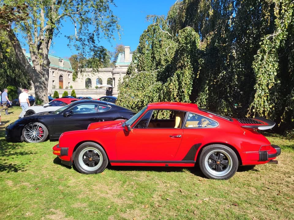

The car goes into gear fine but once it’s in gear the shifter wiggles like the lever in a type 2 VW bus. This never really bothered me too much and I just accepted it as part of the charm of driving an old Porsche. But lately I’ve been driving my 2024 Acura Integra Type S and have gotten spoiled by the engagement of the snick, snick rowing through the gears, that jumping to the 911 just feels sloppy. The 911 subject is a 1988 Carrera with about 62k miles on the clock.

Pic of offensive vehicle
