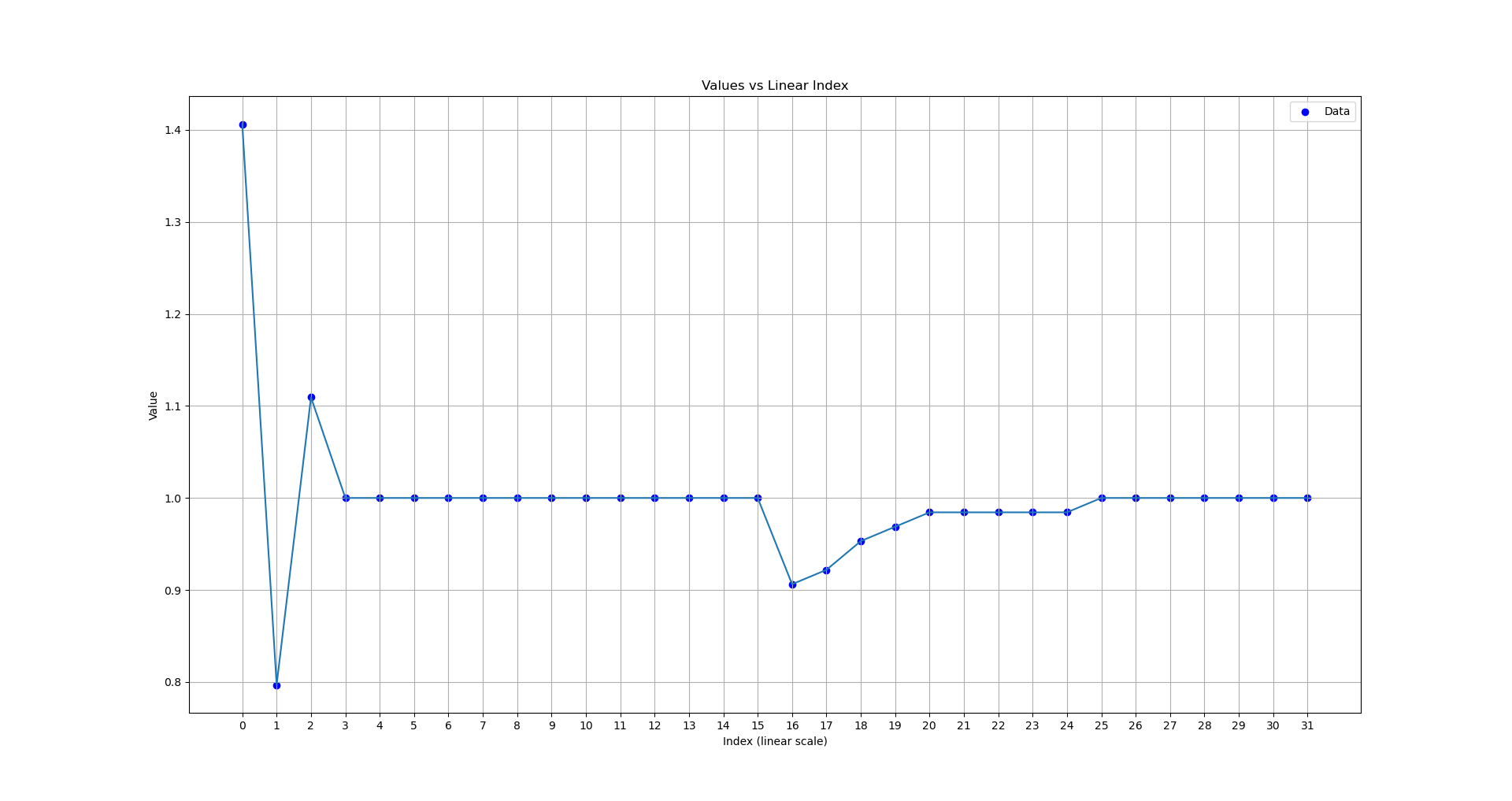

I have an opened up DME hook up in my car at the moment. It's a busy time for me but if you have a specific request (4 channels max) I should be able to grab something for you over the next week or two. It would probably have to be non-moving though, so idle or snap throttle (we're buried in snow where I live).
Here's a puzzle that your simulation might be able to shed some light on at some point:
This map is stored at 1140. It's actually 2 maps (split in half).
These maps modulate the fuel pulse (the value on the vertical scale is a multiplier, so a value of 1 does nothing).
This graph doesn't quite show the raw maps - I've done some processing to show the effect they have on the fuel pulse width.
They are a bit of a mystery to me because the circumstances under which they are applied are complicated and confusing. As far as I can tell:
* they're applied when fuel is re-activated after cut-off
* the first one (0-15) is applied upon return-to-idle
* the second one (16-31) is applied on return-to-throttle
As you can see from the graph the first one dithers the fuel pulse width above and below it's normal value briefly; the second one pulls it down before gradually climbing back up.
They are applied in the real-time part of the code, just after the spark timing is calculated, and thus they override all closed loop control.
I just don't know why these are there. Some ideas I had:
* it has to do with the catalytic converter
* something to do with fuel vapor purge
I don't think it's the cat because most cat/o2 related code is guarded by the code plug stuff. This code is active for all models.
