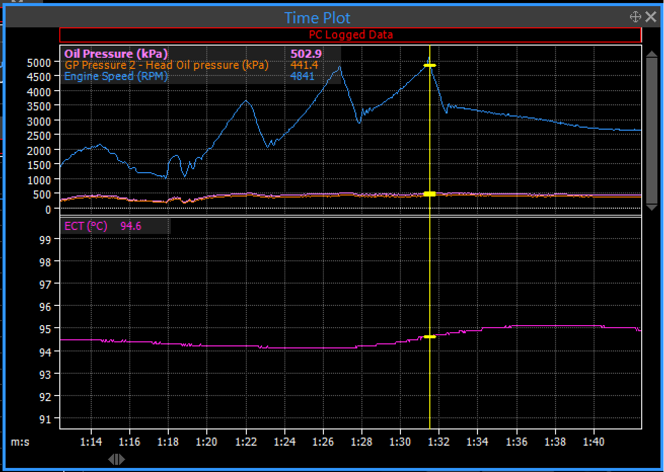

Weve been chasing a sporatic rattle that seems to originate from the variocam tensioner when the car is hot, I put a pressure sensor in the stock oil temp sensor location today to ensure we still wernt having oil pressue issues from the check valve in the head and everything looks pretty good, with a roughly 10% pressure drop from the sensor at the oil pump to the far side of the head (oil temp is usually around 90-95degC after a hard run so readings are sligtly lower than the Porsche specs which are at 80degC)
Hot Idle Hot 5000rpm
I have a new J-tube and vario-cam check valve to install and Ill give the solenoid and spool valve a look over while I have it apart, but after that its looking increasingly like the seals in the unit itself might be passing.
