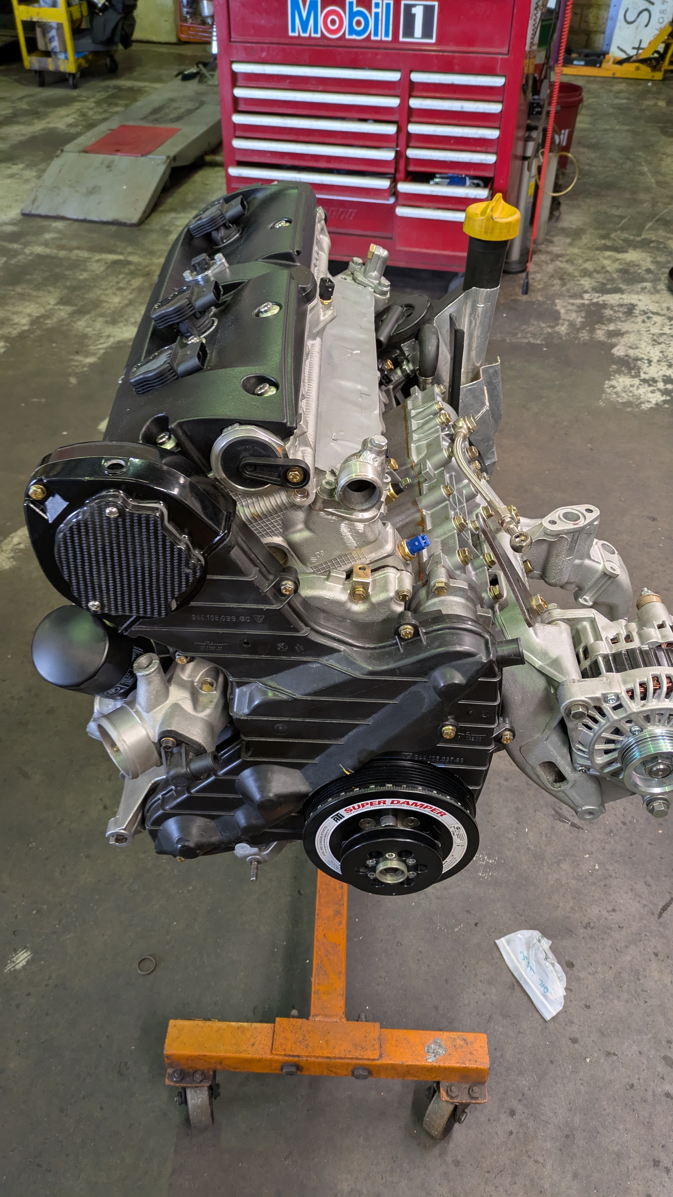

The S2 3l engines have one intergrated into the accerssory belt pulley, theyre reasonably expensive to get now. There is a URO replacement but its URO...
DRS development made a replacement hub that replaced all the crank pulleys and allowed you install a ATI Damper but it was a limited run and youd have to find one that someone didnt end up using it willing to sell. Jan may still have one but its a long shot.
Quite a few mods to the belt covers to make it work. Its also quite a bit larger so will be overdriving your Alternator/AC Compressor slightly
PXL_20241202_025641772 (1).jpg (2.33 MiB) Viewed 246 times
