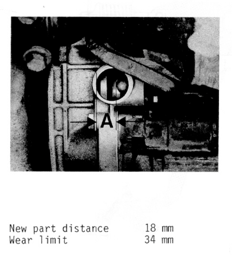

Last time I had a sticky pedal, it was one of the two hydraulic cylinders (changed both same time)
There is a free play adjustment but I doubt that's it... however, lightly tap the brake pedal a few times... the clutch pedal should have similar free play at start
ADD: technically, the hydraulic clutch system is self adjusting for wear but like your brakes, new is new and with all new components and proper free play adjustment, it catches pretty quick off the floor. It is fairly easy to check the state of affairs using the inspection hole at the bellhousing. Check the workshop manual for the procedure or watch this video

Here is the wear limit and measurement point.
