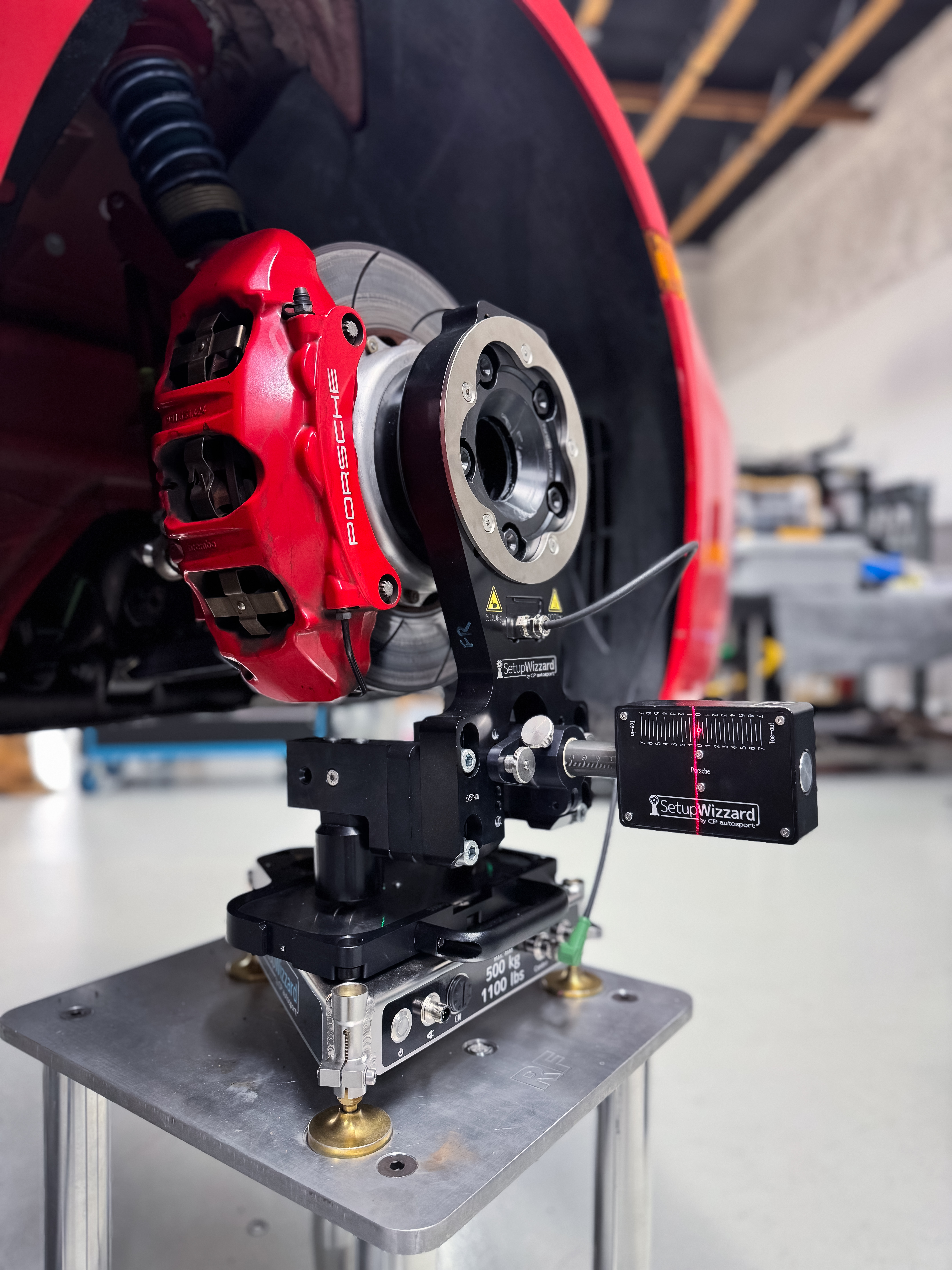

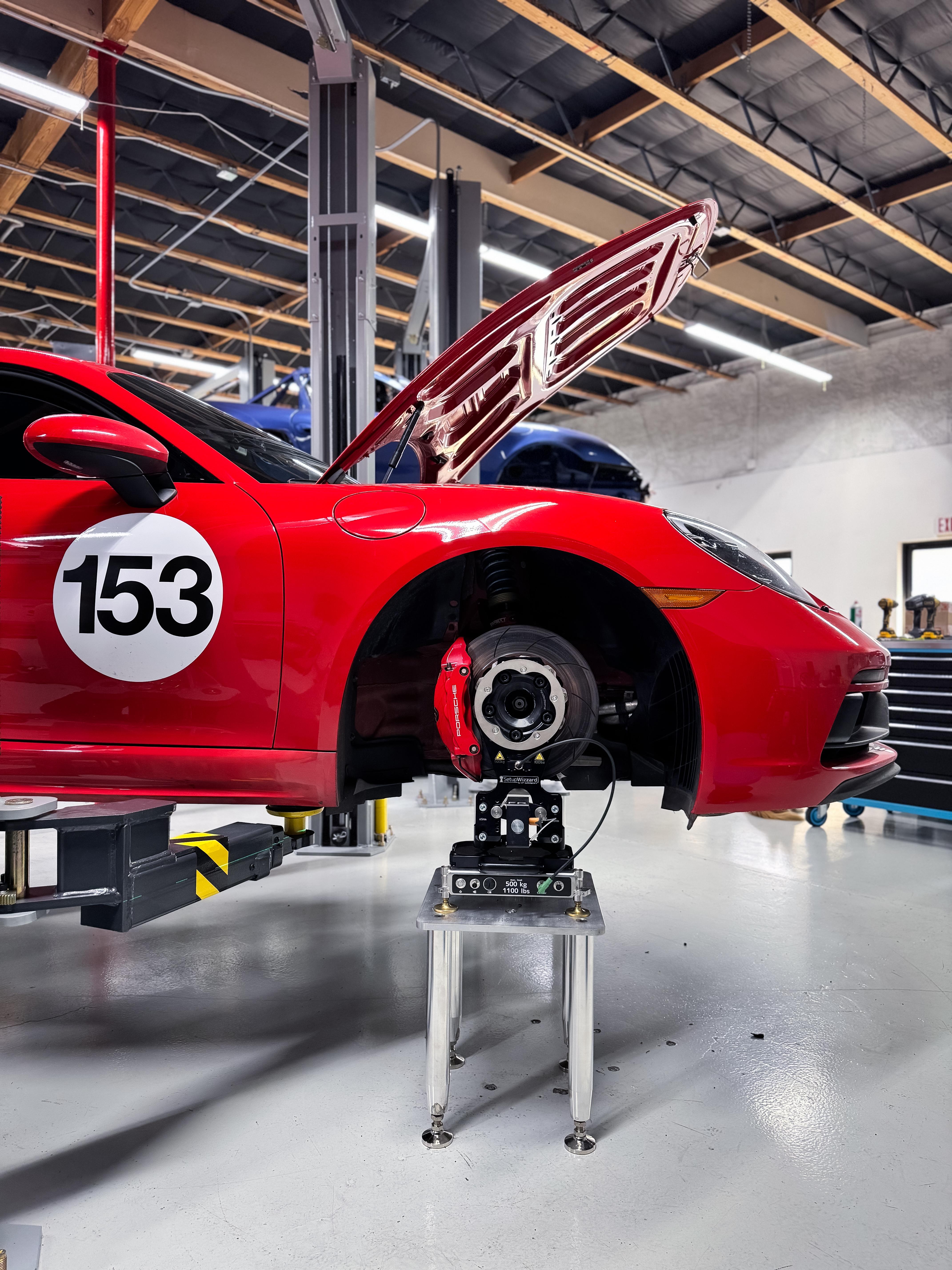

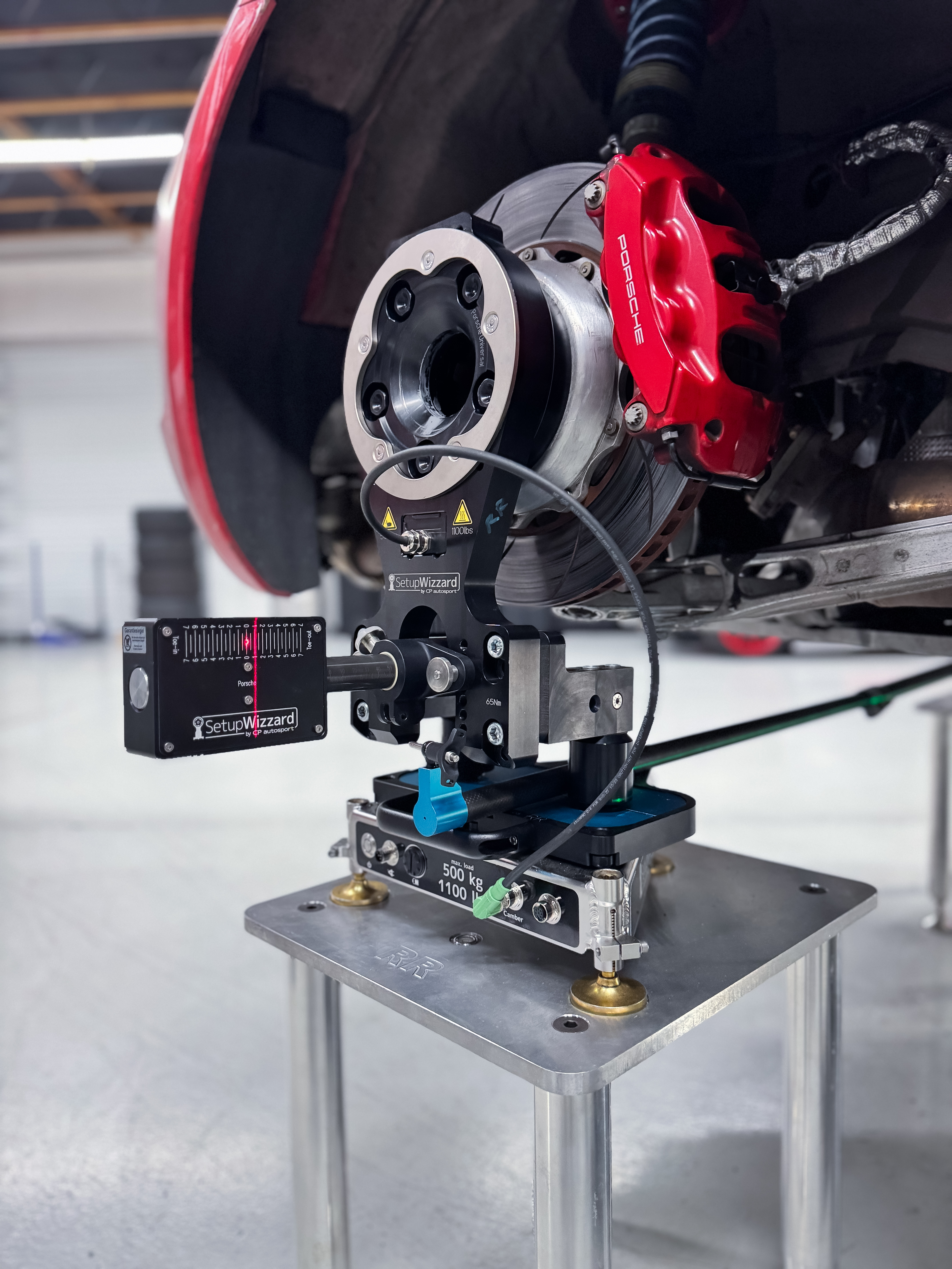

A couple days ago I got a fancy alignment. Corner balance the coilovers, even up the camber and remove a bit of toe. So far it is nice but don’t have a track day for two weeks.
They use hub stands for easy access and accurate repeatable results. They used shims to widen my front track a bit more, 16mm of shims per side and then brought the front struts out to match.
-3.2 /-2.7 camber
1mm front toe out, 0.5 mm toe in per side in the rear.
-3.2 /-2.7 camber

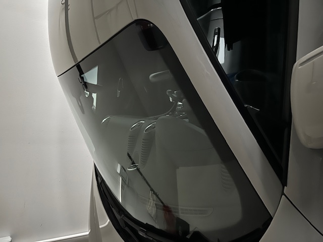

Got my Cayman windshield replaced at Porsche Des Moines and had them install an Xpel windshield covering. Even though the cracked windshield and pits came only from driving on the highway I decided it would be smart to cover the expensive front eyeball screen - dang things are expensive and I don't even need mine recalibrated. I had the windscreen covered on my 2008 Viper ACR well over a decade back ( no real product then, just had a custom one done with 3M ). I will drop a review sometime in 2026 but I am pretty convinced this is a smart mod for not much money considering the cost of Porsche front glass. My wife did not even count it as a Christmas or Birthday gift -- surprising as she already got me a new set of Apex forged wheels, ha!

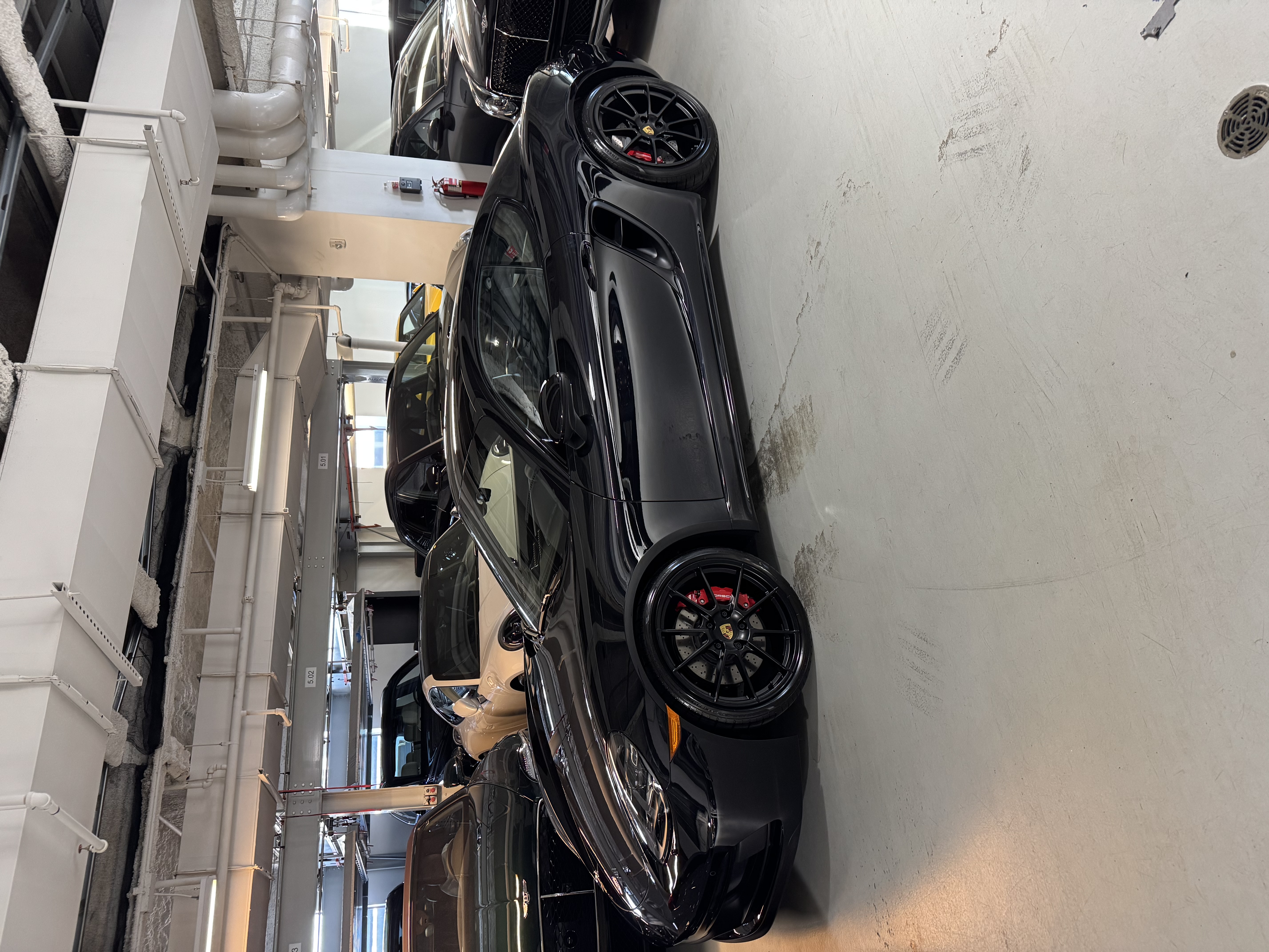

Here's your guide for posting pics. Post away - we love photos on Carpokes!Carguy 5 wrote: Wed Dec 24, 2025 8:04 am Wow !
Very Nice![]()
If I can figure out how to post a picture, I just got my 2025 Cayman 718 GTS 4.0 back from the Ceramic Coating shop yesterday !
viewtopic.php?t=410
And by the way, welcome!
