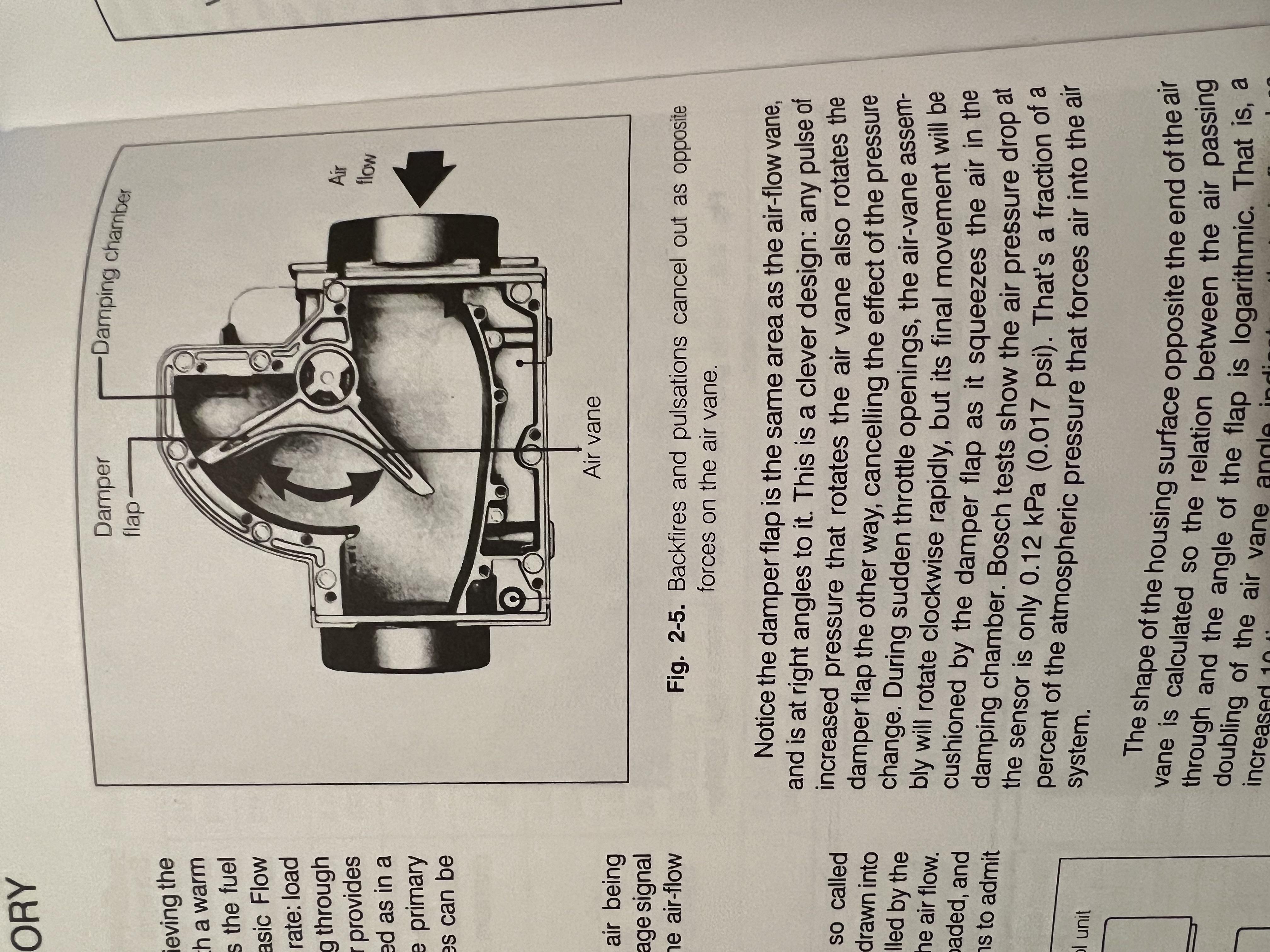

This looks like a well-made kit, but a major reason to install a hot-film MAF kit in place of an AFM (aside from the obvious elimination of a moving part and its wear-prone electrical wiper circuit) is to reduce the restriction in airflow, especially with a turbocharged application. From my understanding this restriction is NOT from the spring-loaded flapper itself (Bosch test data showed a minuscule pressure drop from this), but from the relatively small rectangular slot required for the AFM flapper. One can see the difference in cross section between the rectangular inlet and circular outlet in the last photo of each of the MAF units on the PLJ site.

Do you have any links or sources where Bosch confirmed the barn door is not a meaningful restriction? That's been a topic of much speculation for years, and I've never seen real data either way. On the other hand, I can 'see' the restriction/limits caused by the size of the opening...
Plus 1 on the @Fast951/Vitesse MAF. In addition to less flow restriction, it allows you to measure more air flow. The stock AFM reaches max voltage somewhere in the 300-330 range from what I can tell. You can fudge the WOT fuel and 'skate to the puck' for a bit more than that, but if you want to control fuel accurately above that range, you need something other than the factory AFM to measure the incoming air.

Tom wrote: Thu Nov 20, 2025 7:44 am
Hi Tom,
It's in this Bosch fuel injection book, long out of print. Page 6 of Chapter 3:

cda951 wrote: Thu Nov 20, 2025 6:59 pm
Actually I just bought this from Amazon the other day and it looks brand new. I think it's still in print.
Hi Tom,
That's awesome, thank you!! I have that book too -- time to re-read it I guess. :shifty: I'll definitely file that away for the next time someone says the barn door is 'the' big restriction.
