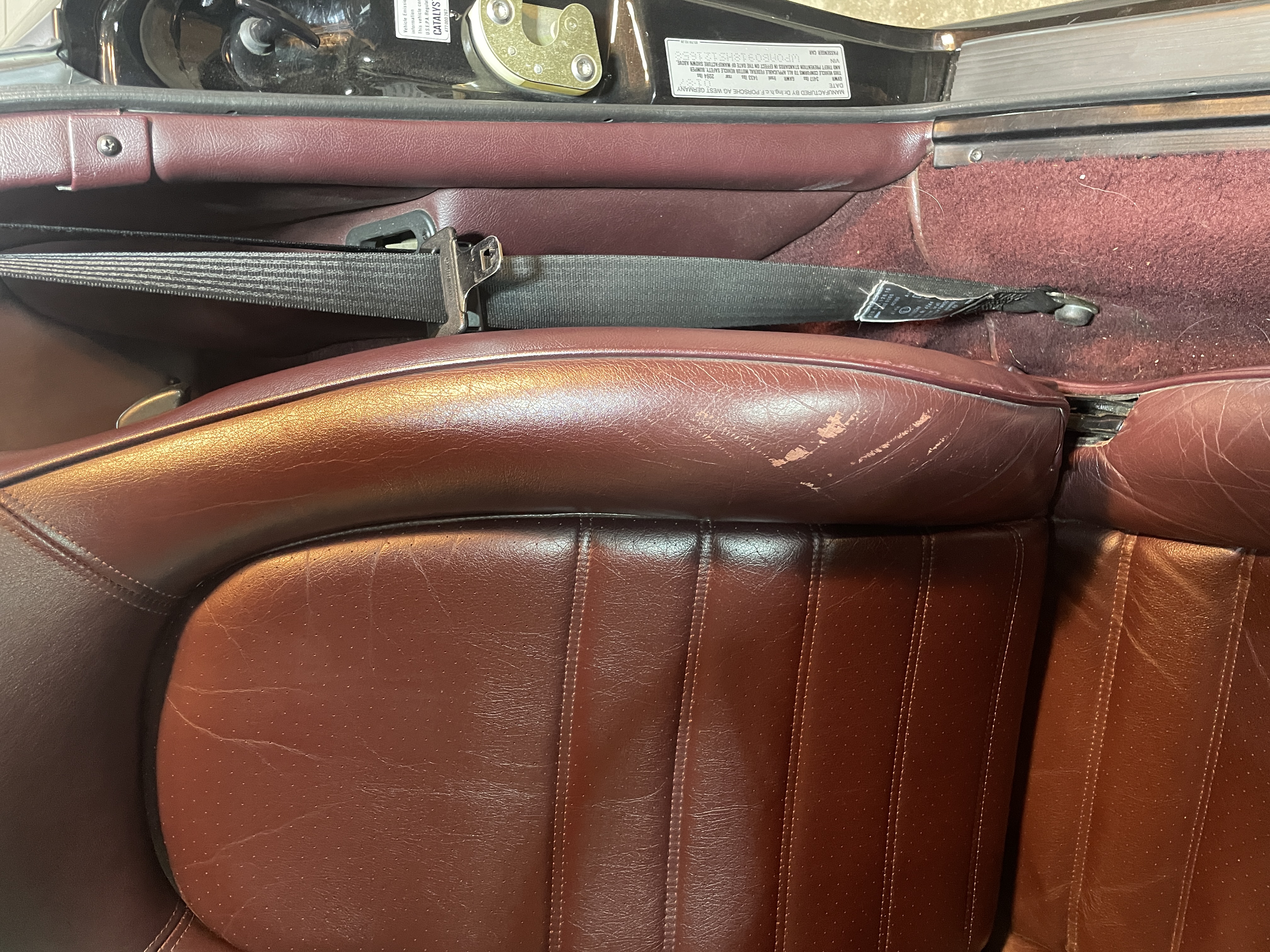

The instant answer is YES. The other Good News is that you are going after the damage before it gets too severe.
The leather in our later (post ~~1960) cars is painted rather than vat-dyed. The damaged area can be repainted pretty easily. I'm a fan of Leatherique products, but there are more than few that others will recommend. Remove the seats from the car first.

The picture of you seat looks pretty glossy to me, like it's been treated with something and not buffed completely. The original 'finish' was not at all shiny, for what it's worth. I know many retail "leather conditioners" depend on that glossier finish to make you think it's actually "protecting" the leather, but in fact the real protection happens when the leather is kept soft and allowed to breathe. At least breathe as much as it can considering it's protected by the paint. To get real conditioning, any real treatment needs to get past or around the paint, and that means soaking the seams and stitching is more important than slathering the painted surface. Most used seats have enough cracking and checking in the painted surface to allow a real conditioner to soak in a little. A treatment that you apply and buff off, one that clogs the pores of the leather, is probably not buying you any real restorative effect other than that cosmetic shine.
