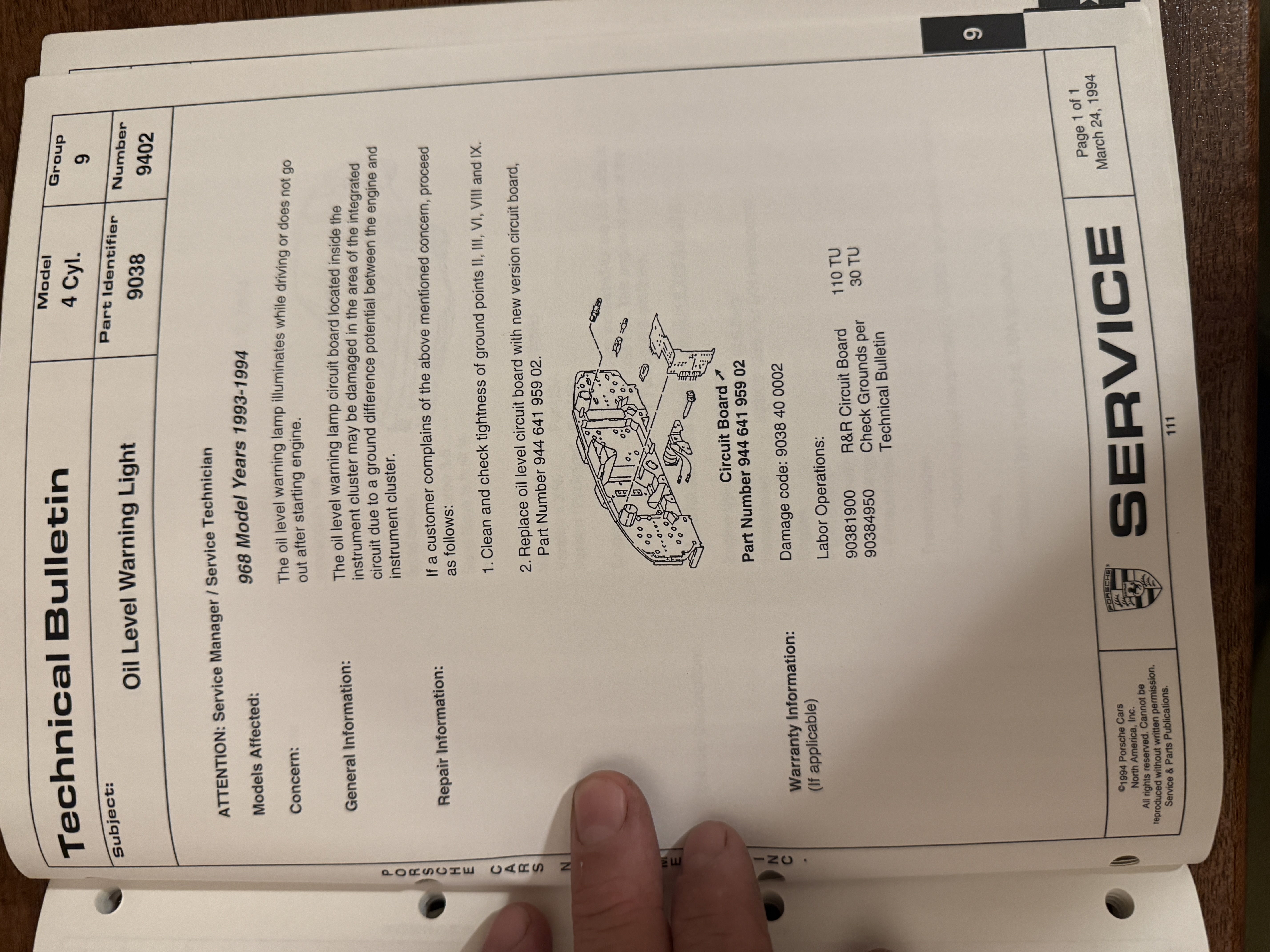

Looking at this further, I found there is a circuit board located inside the cluster which provides the oil level function. The connectors we see on the cluster are actually the back side of the connections to it. The original version had some issues in some 968s, and it was upgraded to part number 944 641 959 02. Details in the technical bulletin group 9, number 9402.

944er wrote: Wed Sep 17, 2025 11:46 am Looking at this further, I found there is a circuit board located inside the cluster which provides the oil level function. The connectors we see on the cluster are actually the back side of the connections to it. The original version had some issues in some 968s, and it was upgraded to part number 944 641 959 02. Details in the technical bulletin group 9, number 9402.

Do you know which tech bulletin doc it is in? I have all of the printed ones applicable to 944s. They usually list them by letter for the volume.

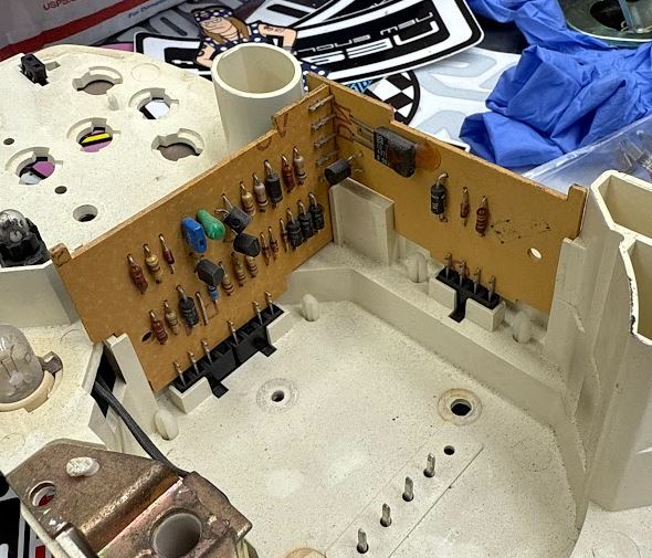

I did some digging in my parts and found this old housing and I can see the board.
I did not have time to look at this in depth. I may try to scavenge this to see if I can use it in the race car but it looks like it does not have the oil level connection.

Pretty sure they all have circuit boards in those locations. On cars with the oil level warning, it's just a different board (I believe). I have some old clusters I can check this weekend if not sooner.
Book K, page 111. The service bulletin indicates 968, for years 93 and 94, so may have been a supplier issue on the original boards during that period, but the older PETs indicate to use the revised board for replacement.

Also attached is the TSB noted.
