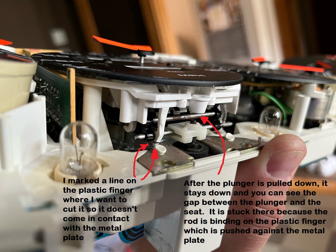

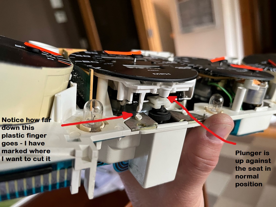

Again the odometer was working fine but the trip meter wouldn't move... So then I was thinking that maybe the previous owner missed a piece of that gummy gear they replaced and it was somehow wedging itself in the reset mechanism or something. So I pulled it back apart again. This time when I was unscrewing one of the last screws on the back of the speedo I heard the reset mechanism snap back to its normal position. I took the speedo out and looked that mechanism over for a while and couldn't figure out why it would be sticking. It seemed totally fine. So I screwed it back into the cluster and tried moving that plunger down, simulating the reset procedure and after I pulled that plunger down, it stuck in the down position.

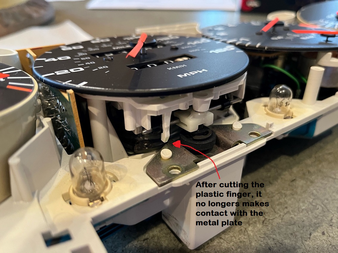

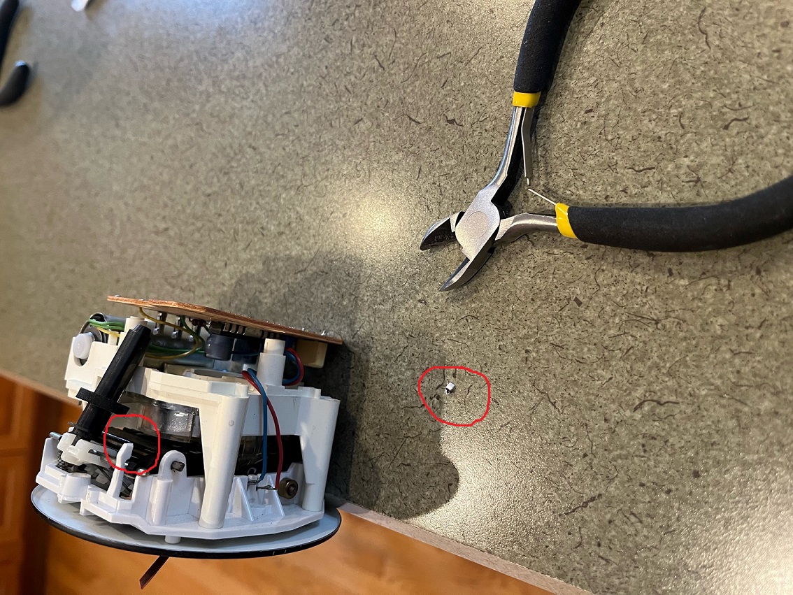

I finally figured out that there is this little plastic finger thing that was getting pinched between the reset rod and the metal plate that the solenoid coil mounts to the gauge cluster with.

I put the speedo back in the cluster and tested it again with my finger and it worked flawlessly.
I reinstalled the gauges in the car and put everything back together, took it for a spin and my trip meter and odometer are working perfectly again. I can reset it and it makes the correct sound now and the trip meter again starts counting miles up afterwards.
